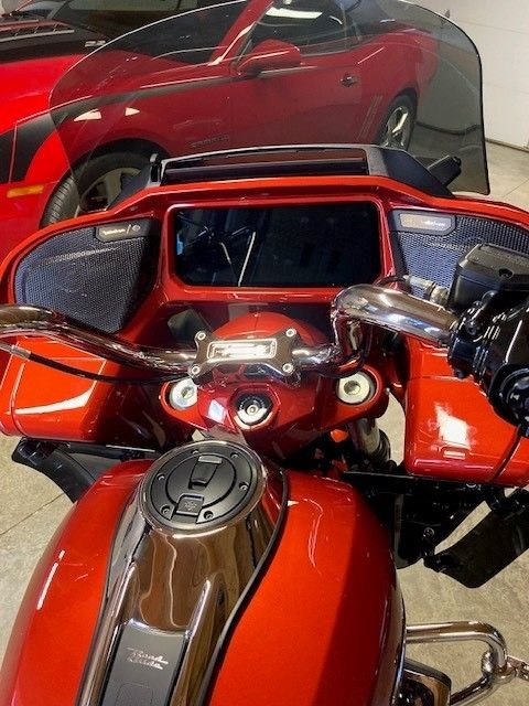

So, I just bought the colored inner fairing kit for my 24 SG and wondering if anyone has done it yet. How bad is it? Do I pay Harley to do it? I'm very mechanical and not afraid to do it. Any thoughts or tips would be grateful.
