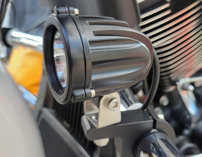

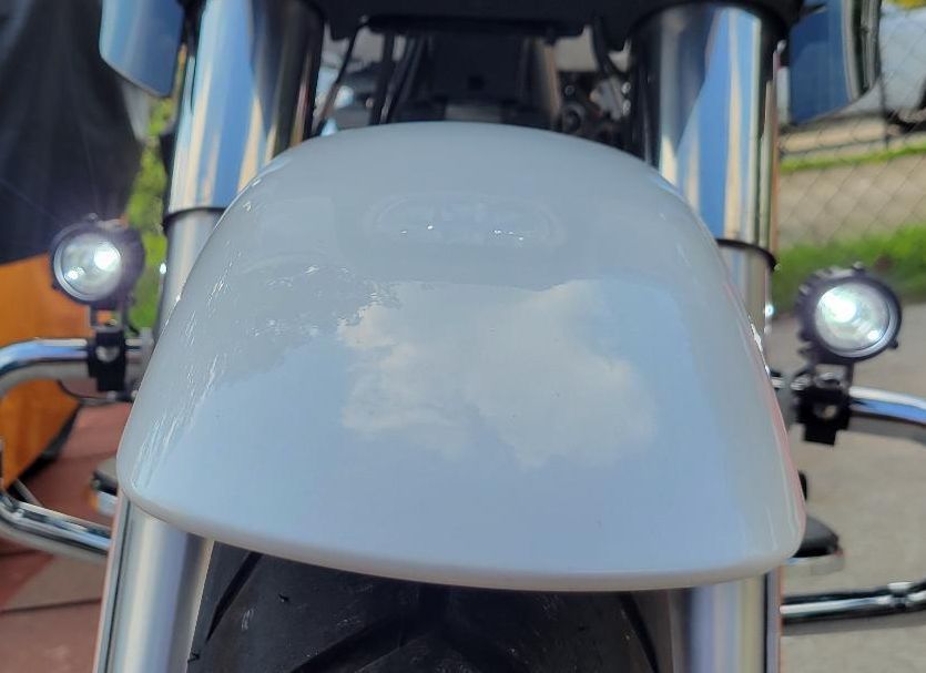

I installed the Baja Design Sport 2 Amber Halogens using the OEM connector. Great lights. Highly recommended

got a pic of your install?
I´ll do my best... I also have the trashin skid plate on so pictures wont be as nice.

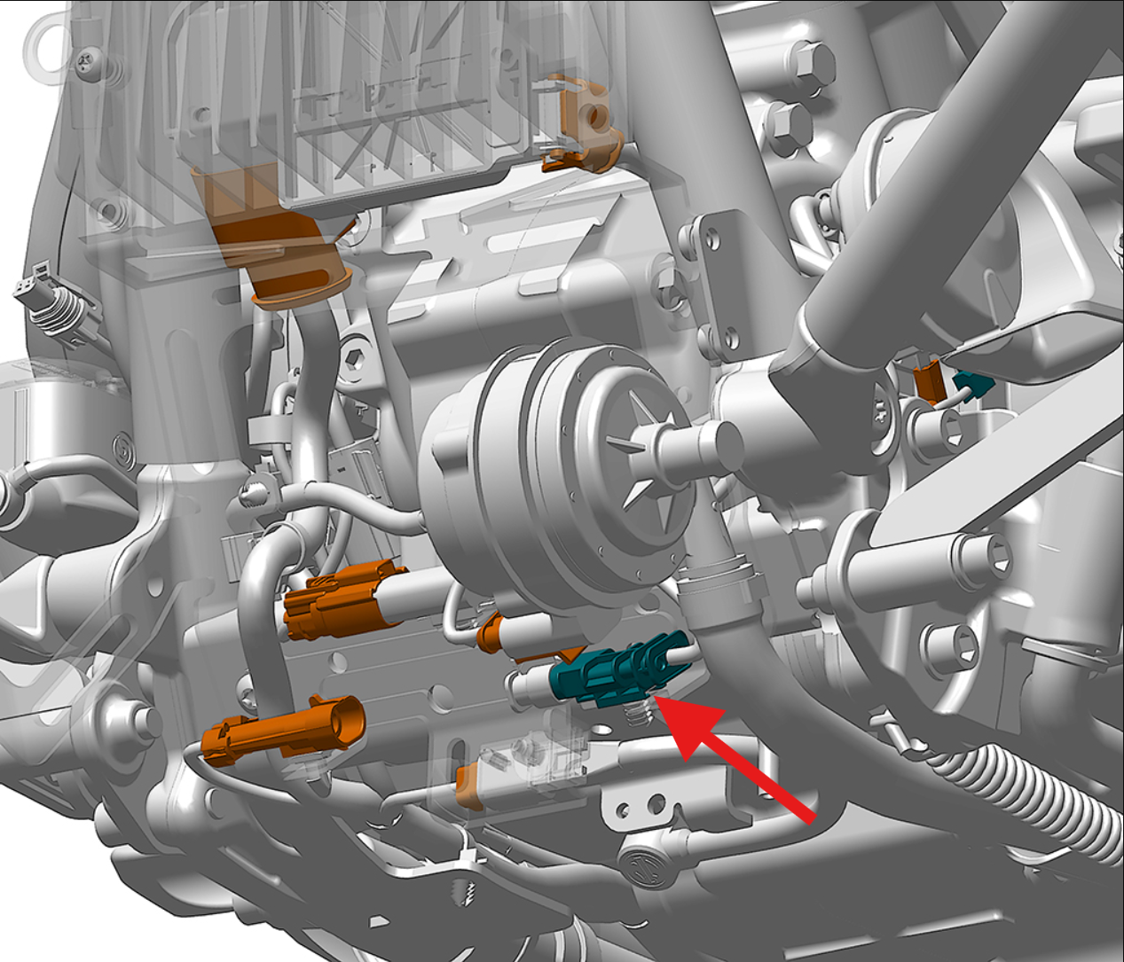

I just went ahead and used some harley points to buy the Harley day maker fog lights. Does anyone have a pic of where the stock plug is on the bike that accepts the lights wiring harness. The install instructions do have a pic but .. well .. it sucks.

I've got a picture somewhere, but this is the best I have right now.

Here's a great post in THIS THREAD showing the process. The youtube video is great and where I have grabbed that picture in the previous post:
