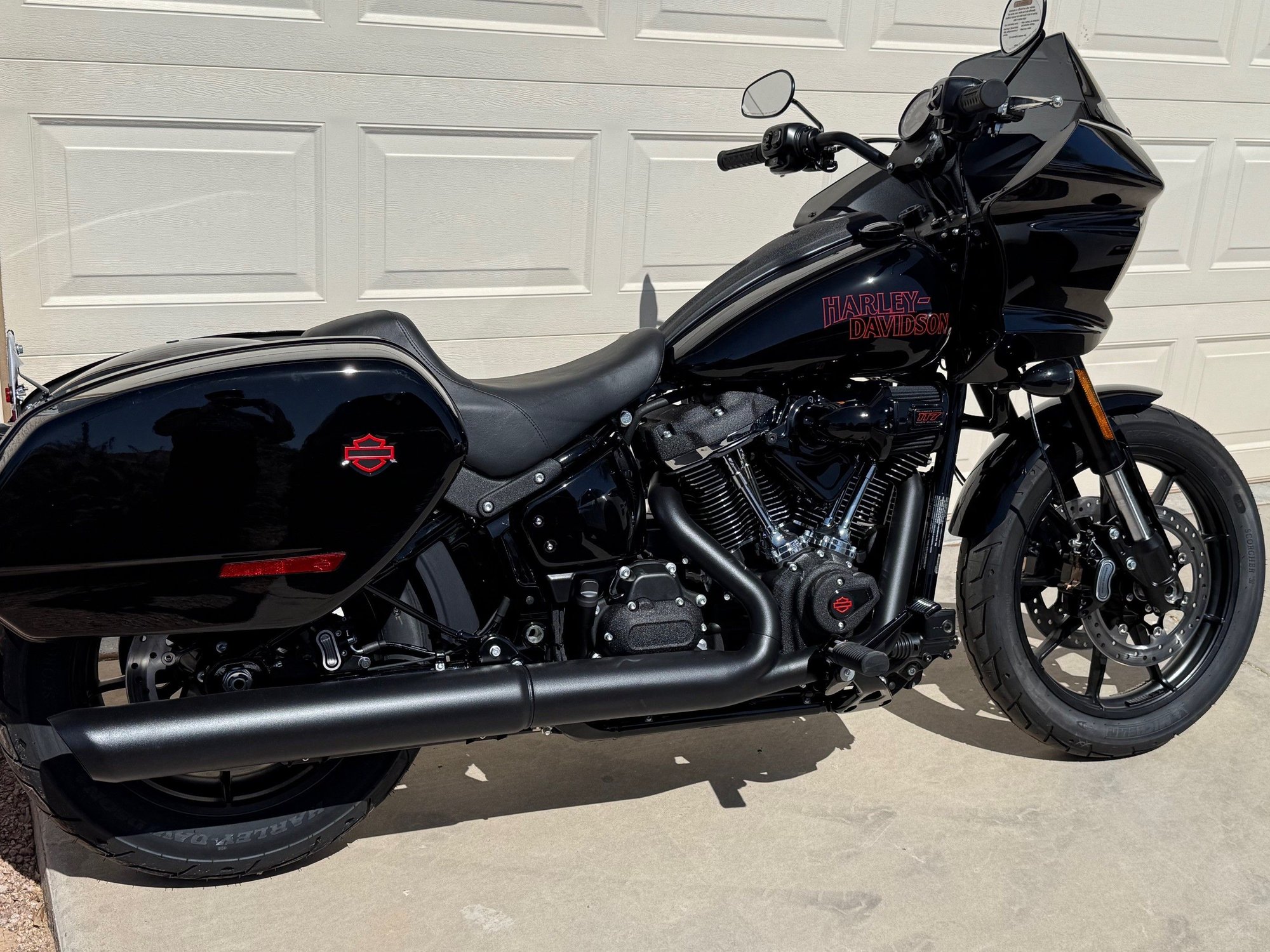

no input but congrats..I was admiring those at our dealership and think they are the hottest new Harleys out there and best value with all the features, functions, suspension, performance, etc. I imagine you will absolutely love it..what color, better yet, pics please !
It's black. I have a paint set I'm putting on it, but I had to have the side covers and right saddle bag lid painted to match, I'm picking those up today.

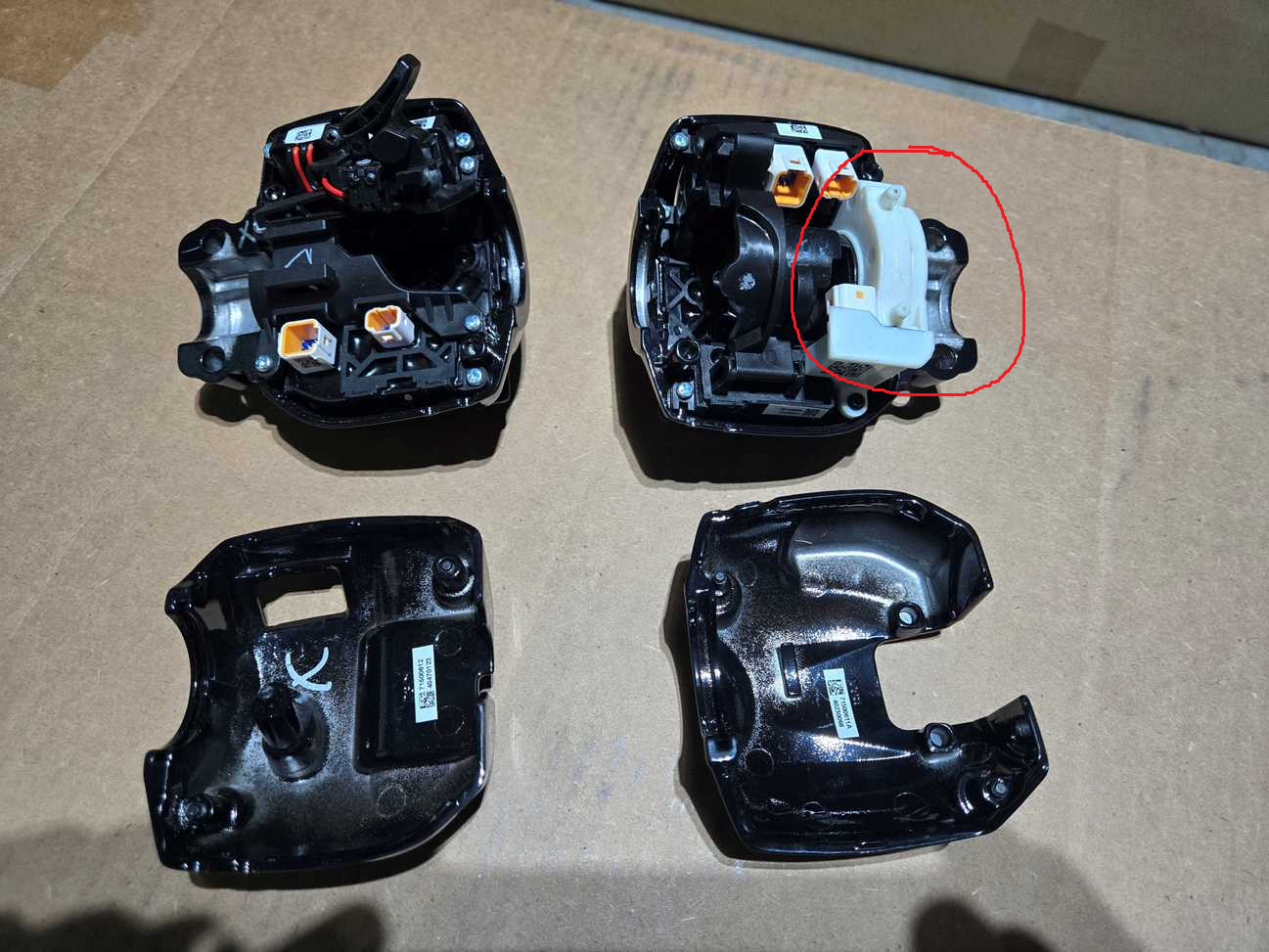

If you have same controls as touring models then yes there are no notches on the throttle side, the skinny part of the bars (over which handle and HCM go) is much longer, to accommodate bigger HCM (hand control module either left or right) and naturally holes for wiring are in different place.

If its the same as the touring controls, then the throttle actuator is part of the controls It looks like a donut , that the grip slides into. So there is no splined throttle sleeve. The end of the grips don't have to seat in a spline like the previous bikes.

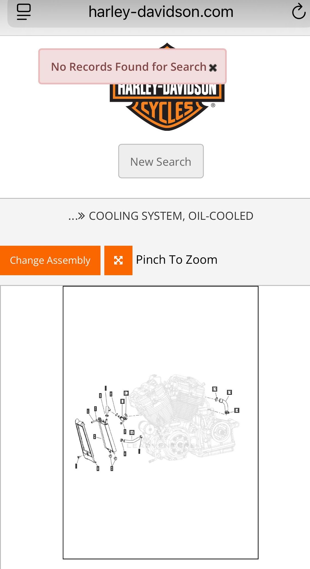

To expand on Andrea 73's post.... 'Center-cooled' refers specifically to liquid cooled touring bike engines with a single radiator mounted on the frame The previous liquid cooled touring bikes had two radiators, one in each fairing lower and are known as 'Twin-cooled'. This is described in the HD service bulletin in the link below.
https://static.nhtsa.gov/odi/tsbs/20...54120-0001.pdf
"Introduced in select redesigned 2023 and 2024 CVO and
Touring models. Identified by a single liquid cooled radiator,
centrally located, and having a coolant reservoir located next
to the left frame downtube. This system utilizes an electric
coolant pump
