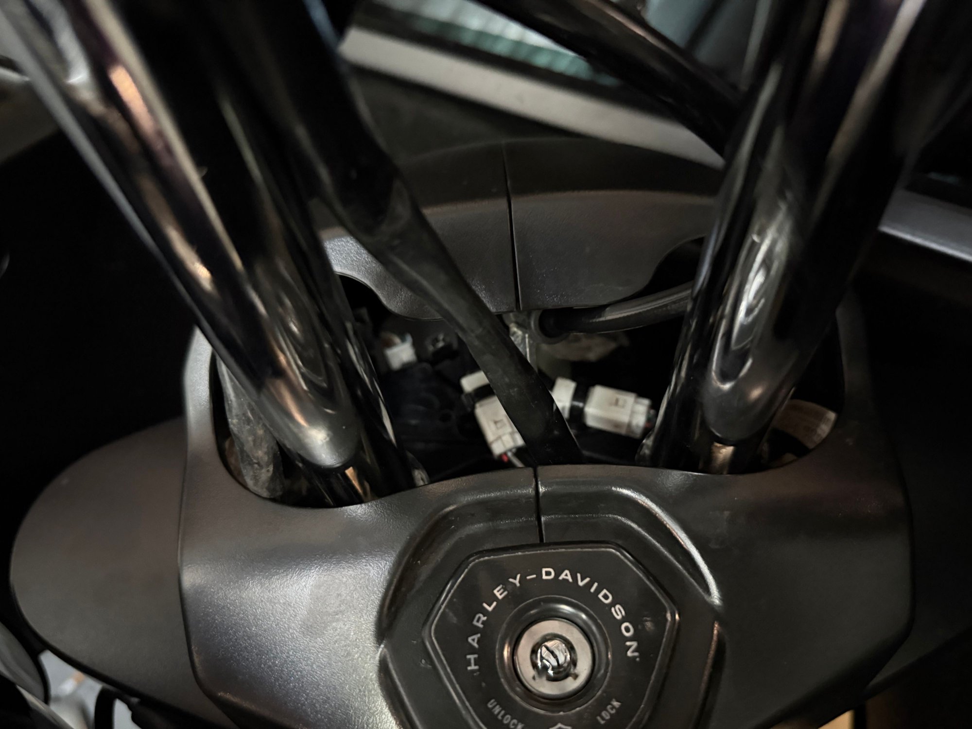

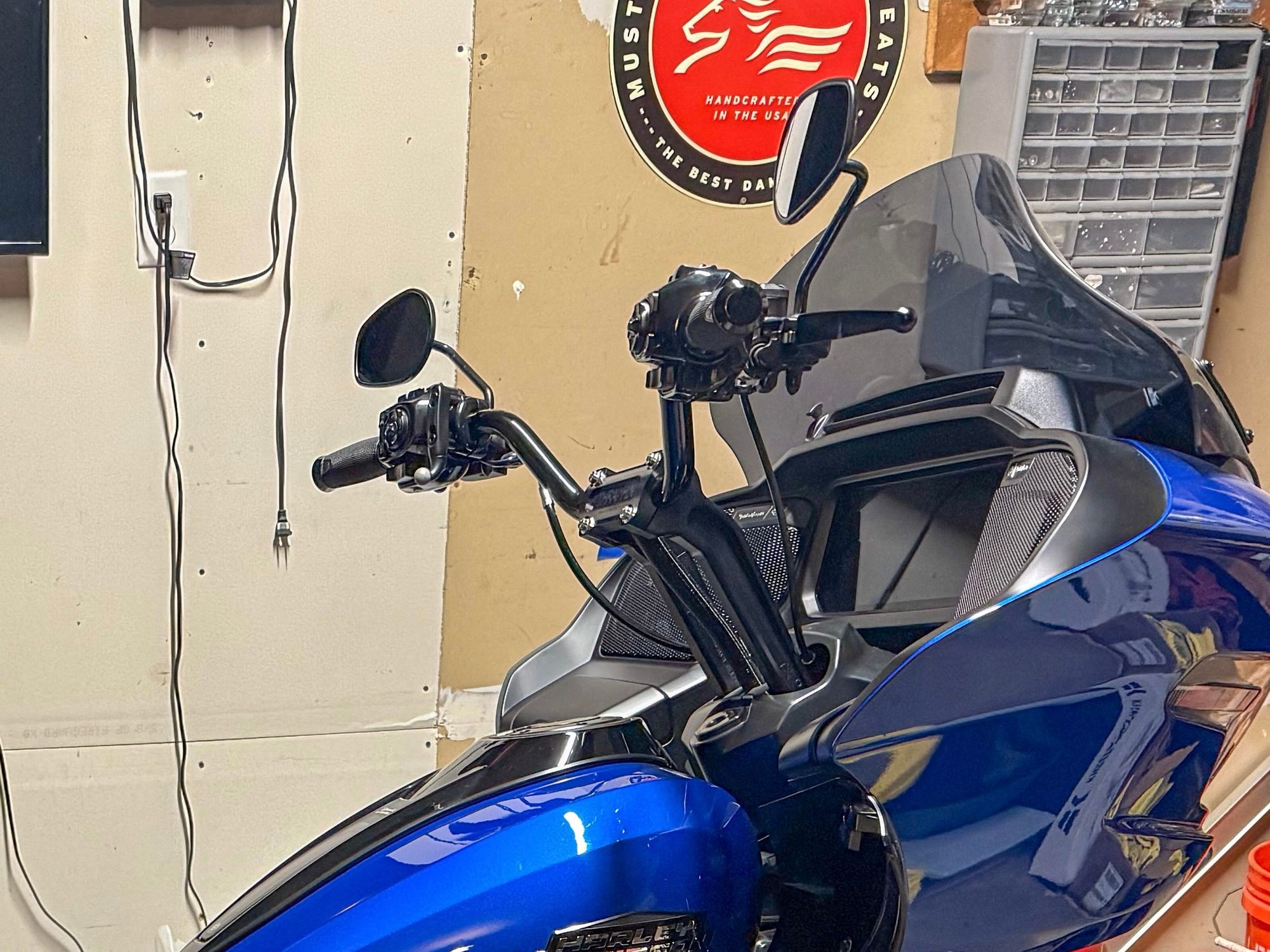

F
Finally got around to getting my bars on. 9in risers and 5.5in rise bars fit with room to spare. Definitely didn't look like it was going to when I first looked at it a few weeks back. Now I just need to find something to cover the plugs. I know they're waterproof but it's just for peace of mind. Probably gonna grab the trashin' top and bottom triple tree.

I'll look for the part# But Harley ( as well as others (facebook) make a clip in plug for that. CVO??
