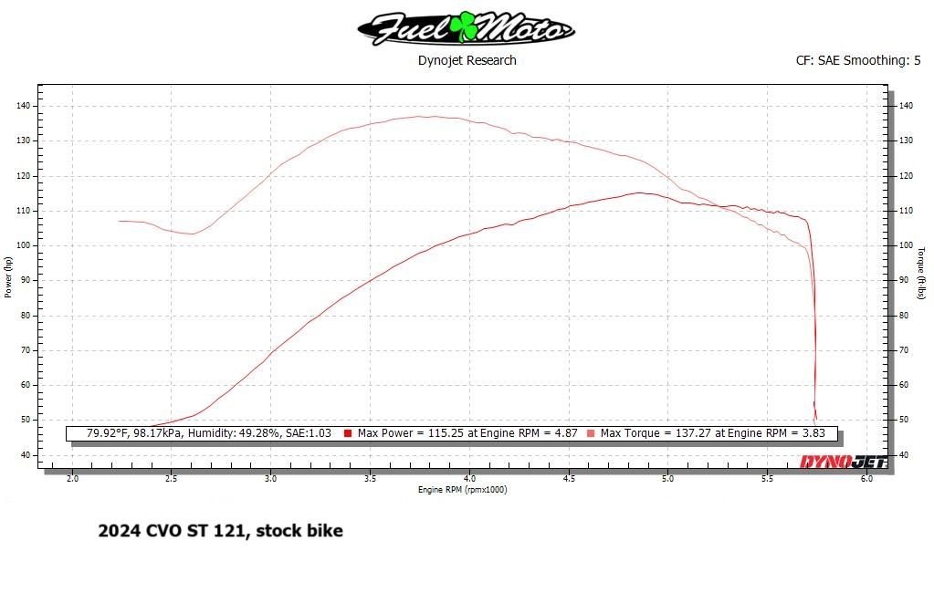

You said it better than me, lol. With its taller gearing, the stock 121 HO motor in the CVO ST's doesnt like the lower rpms unlike the 121 vvt models. The charts are from fuel moto's testing, probably why you feel the motor lugging around 2000 rpm.

This is my sons 121VVT CVO. 4th gear runs. Red is all stock. Orange is with 2.25" Krusher baffles in stock muffler shells, CVOST air cleaner, and SE Tuner. No reported issues with lugging.

My apologies, when you said lugging at low rpm I automatically assumed you have a CVO ST. I just noticed in your signature you have a VVT CVO. You should not be experiencing any lugging unless you are dropping below 2000 rpm regularly in 1st gear.
