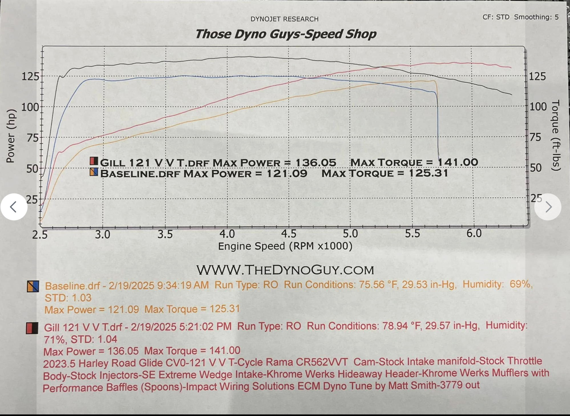

I simply cammed it and kept the 121 VVT in tact. (Details on the dyno sheets).
The results are plenty for me as I'm a 2500 - 5500 rpm type rider.
Rarely do I ride above 5500 unless it was a missed shift or something.....lol.
Remember to watch where the peak hp & tq hits and be sure your it aligns with your sweet spot otherwise most of us would be wasting our money on the hype.

Did you upgrade the pistons? I've been reading a lot about the cast pistons being too thin between the top ring and the top of the piston. Something about putting too much timing in the tune. Some tuners refuse to tune the 121's without upgrading the pistons.
