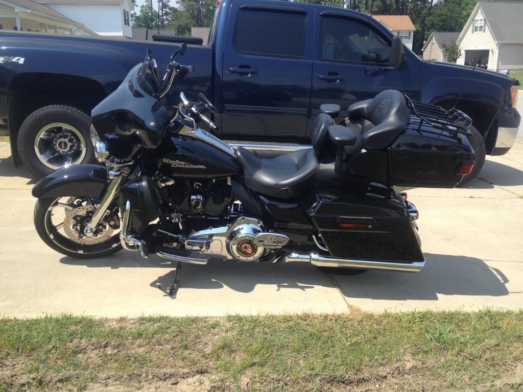

In this pic you can see my Harley brand arm rests, they swivel around the stock size speaker pod on each side so the passenger can get on and off. I'm thinking they would hit the 7.1 pods if there much bigger than the standard size one. I don't suppose anyone has taken a picture of the 7.1 pod beside the stock size pod?

BT pods would definitely interfere with those
