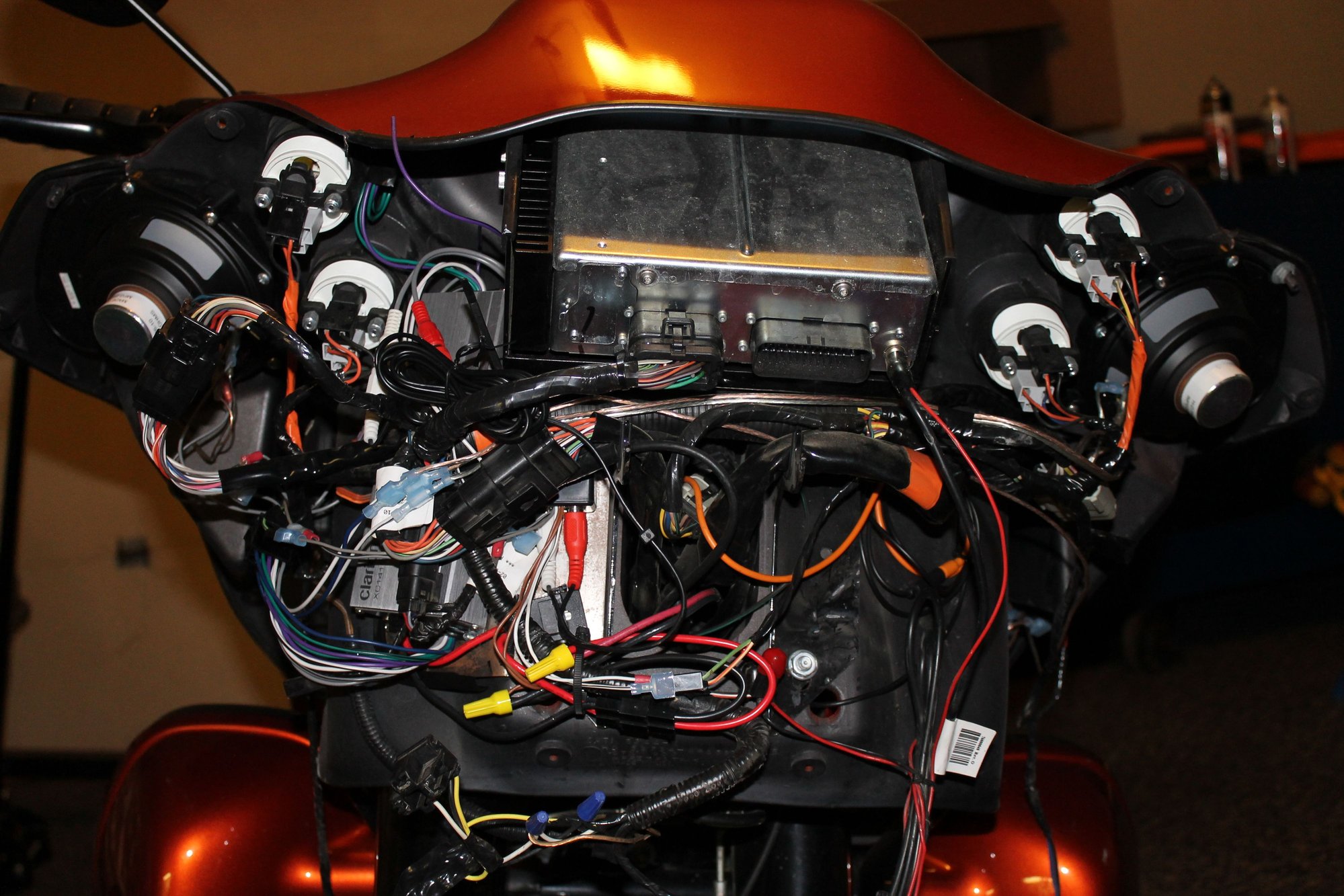

The first task I had was undoing what the previous owner had done. After pulling the fairing I was met with this mess. The only plus that came out of this is the discovery of the blue connectors you see. They are a typical blade connector except that both the male and female sides are fully insulated and they fit together tighter than any other connector I'd ever seen or used. Took me a little bit to find out where to get them so to save you that footwork they are available at Home Depot

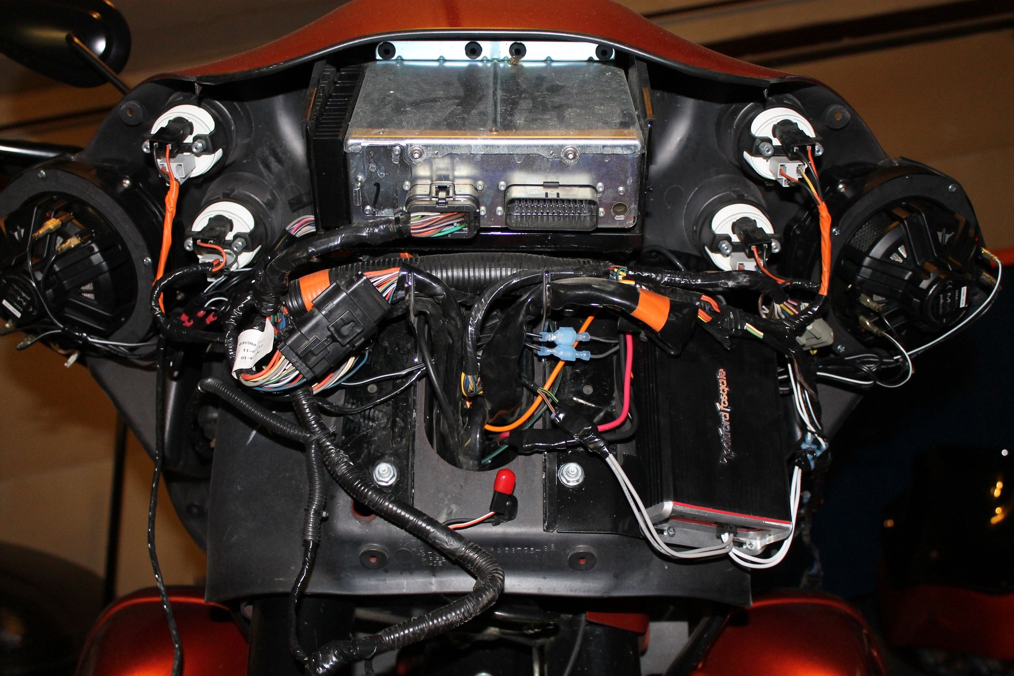

After removing all of that crap I had a much cleaner inner fairing to work with. As you can see in this next pic there was plenty of room now. I had already installed the adapter rings in this pic. If you have a Roadie as I do and you get the ARC adapter the orientation is very important. At least if you want to ever get your outer fairing back on. In the pic you can see that I set them with the flare portion pointing toward the outboards side. That was incorrect! When installing them the flare needs to be pointed either inboard or down. Especially if the speakers you're going with have a larger magnet or speaker basket.

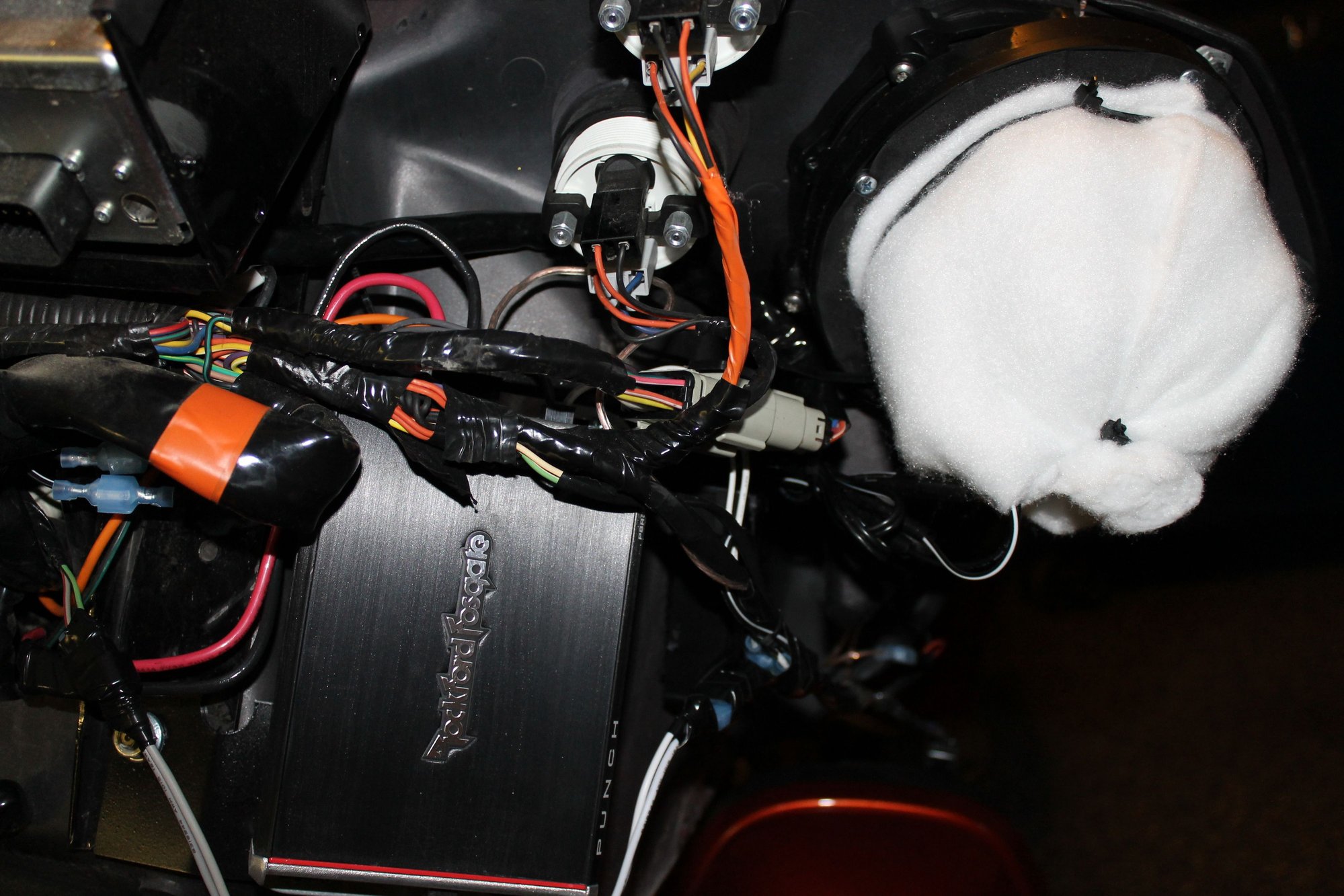

Here you can see the amp and speakers installed. The amp is mounted using a bracket I purchased on Amazon from a seller named HD Parts for $30. They also sell a bracket for batwing fairings, also for $30. It's well made out of solid steel. It does however come unfinished so a quick coat of primer and gloss black automotive paint to prevent any rusting was in order. In the pic is a pair of Polk MM651's. I ultimately went with a pair of Infinities thanks to help from Gannicus, more on that at the end. I know a lot of folks don't recommend using connectors and I do understand why but I figured I'm likely to be making changes, at the very least an aftermarket HU, and the disconnects will assist me in those swaps. Once I have all the components I'm sticking with in place I'll likely splice and solder everything in place permanently.

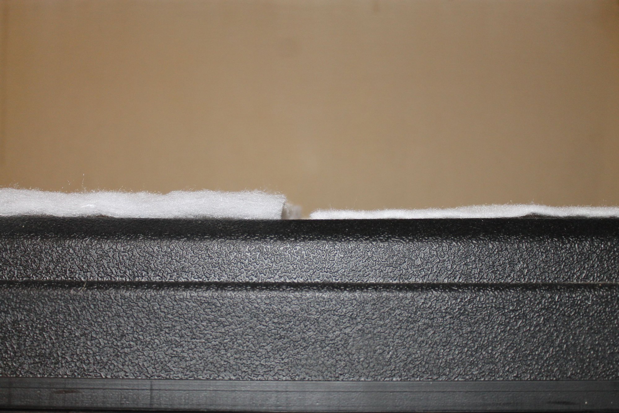

Here are a couple showing the wrapping with the polyfil. Including one showing the difference in the polyfils. As has been said in other threads use three layers and either tuck it up or you can do as I did and zip tie it in place. For clarification, from UltraNutz, that's three layers of the thin stuff. It's about 1/16th of an inch thick which is different than the higher loft stuff.
