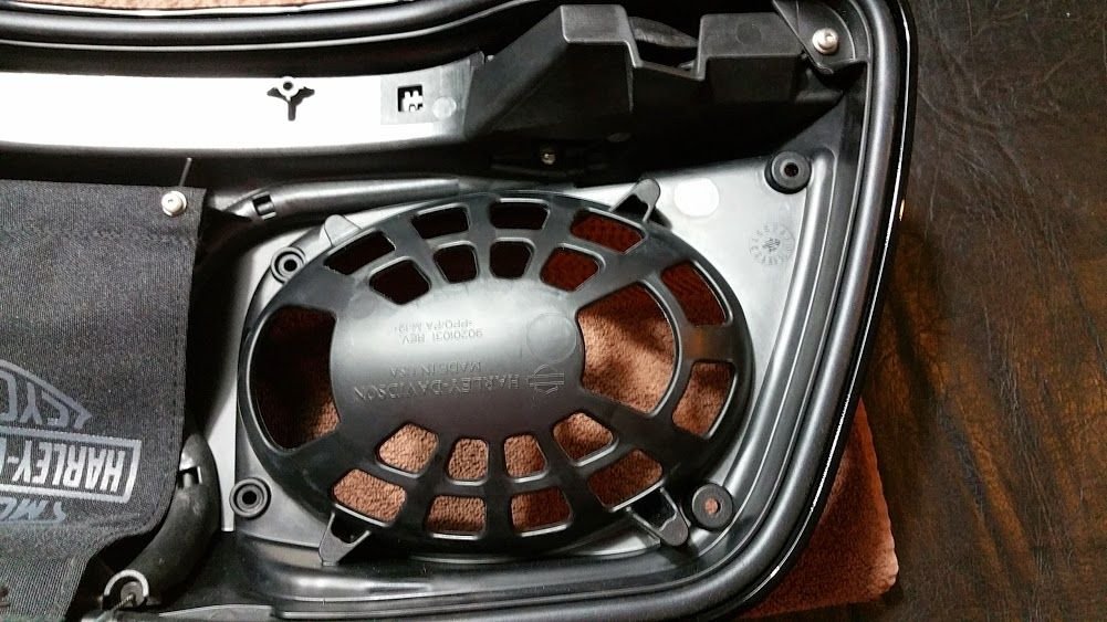

As far as the weather stripping...yes between the speaker and the lid to keep water out.... and I too used a dremel to make the mounting work.... took all of 5 minutes and a few drop-ins to check....
One more thing... you will have to cut the baskets off the lids for clearance of the speaker....

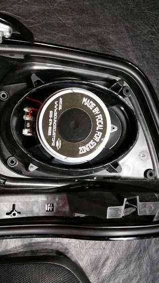

Well, my HAT I57-2's came in today - a quick 10 minutes with a Dremel to remove the speaker baskets and the speaker fits in the space allotted for the Boom speakers. There can't be much magnet in a Boom speaker because those baskets are SMALL. I need to modify the mounting holes in the rim of the speaker to fit the odd shaped space the stockers are supposed to fit but I don't think that will take long either. Biketronics stuff has been shipped - getting excited!!
Pick up some 3/4" high density weather stripping and split it down the middle... that gives you 3/8" for each speaker to give a watertight seal and a bit of cushion to snug down on... worked great for me and no water gets in either
