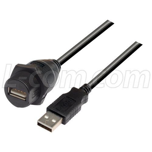

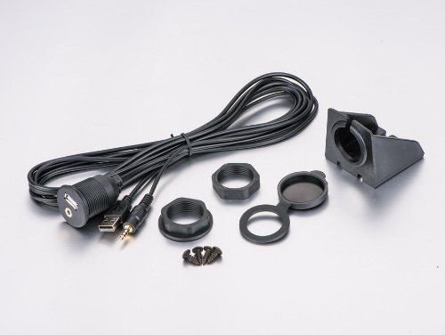

USB out of the cig lighter? I don't use my cig light nor do I plan on it. Could basically run the rear USB from the headunit to the cig light outlet, with slight modification. Any pictures? I'd probably prefer having a usb stick in out view than on the actual headunit it self
Originally Posted by Smokey Stover
Hmmm, Ok must be a stupid question.I suppose full time on would not be so good, How about using the Euro Light connector that comes on with the ignition switch on? Or the empty acc switch? So I can use the cig lighter socket for a USB charger.
I'm talking about the little cig outlet adapters that have one or two USB ports on them that are just for charging. Smokey may mean a full charger plug that goes out to mini/micro/whatever USB for a phone or something.
I think you're talking extending the USB input from your headunit. The adapters I'm talking about are only wired for charging, not data sync. It may be possible to do what you're talking about by removing the cig outlet from the faring and making some kind of plate to fit in the hole using a USB keystone jack or something similar. But I haven't come across anything that would be a direct plug-n-play solution.

Old Mar 18, 2015 | 03:34 PM
osuhd's Avatar
osuhd
Posts: 327
From: GO BUCKS
pretty much what I was thinking, but I could also run it out underneath the fairing to where the maing wiring harness and and zip tie to those wires. Could pretty much tuck it underneath them to have it hidden.
