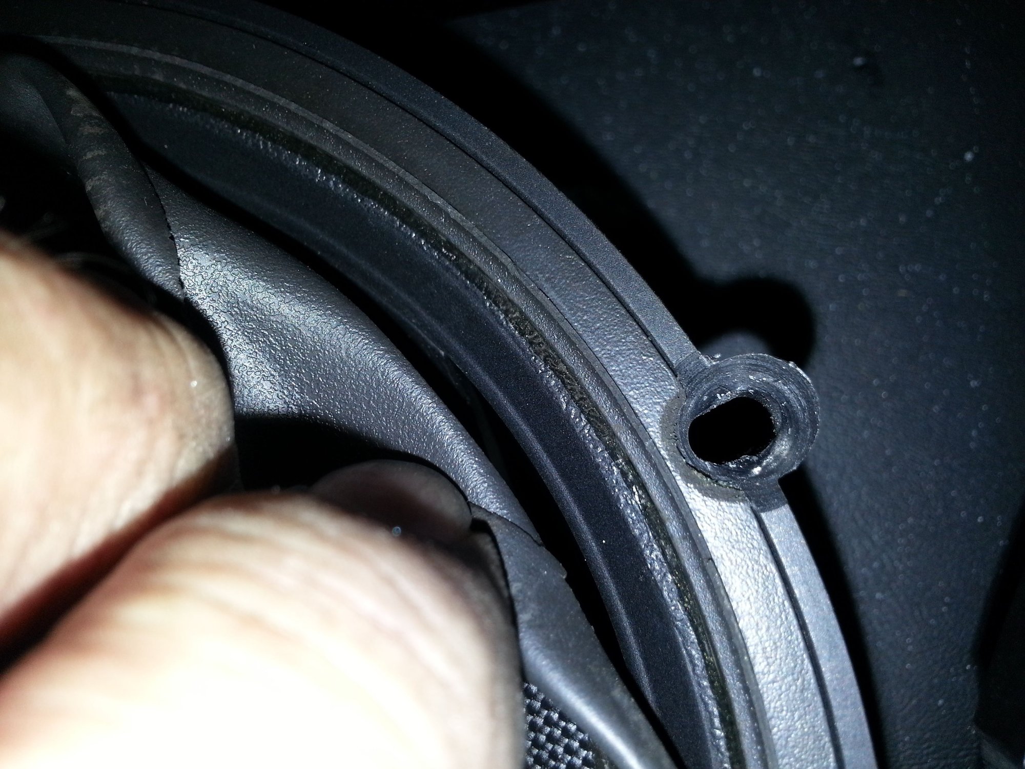

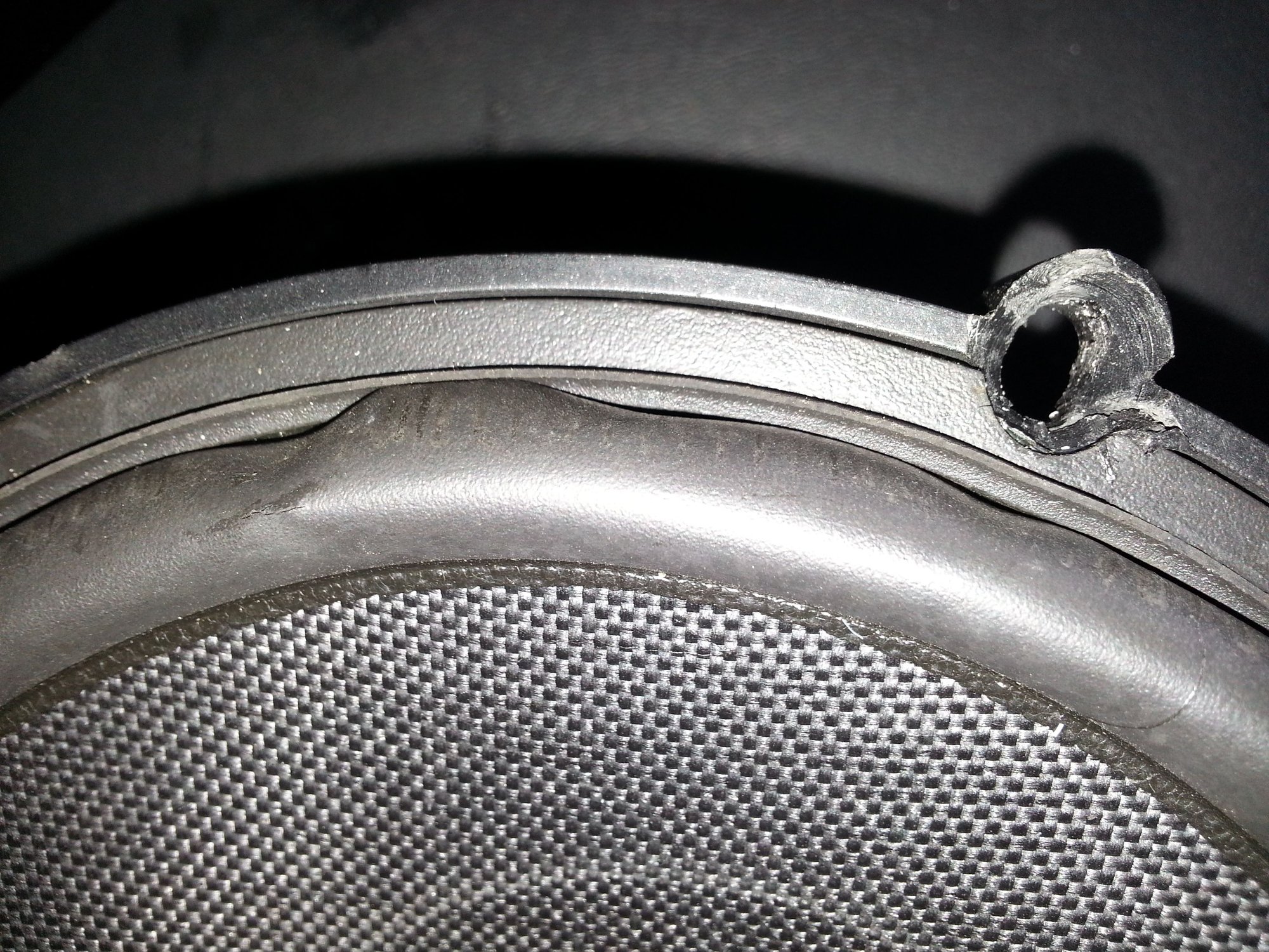

Just got done replacing both Kappas in my '15 Limited Low. They have been buzzing for a while now. Does this look like just normal speaker blowing, or is something else going on here...
Both speakers look the same. I've been running a PBR300 @ about 6 on the gain, seems reasonable. It does get hot here.... the speakers have seen 105+, but that's well below what they might see in a hot car with the windows up in the summer. Also, they have been wet a couple of times from careless hose spraying at wash time.
Just wondering if this is what I have to look forward to? They've only been installed for 4 months now, not too promising.
Thanks for any advice.

Those speakers are normally pretty durable. I've not seen any in the condition of your pics. Gain on the PBR is a little high. The weather should not be a factor. The infinity's like clean power and I'm not so sure the PBR is the right amp for the Infinity's. Now guys might disagree but those speakers sound much better with the Cerwin Vega B2 IMO. Not saying it's the amp but if you are running the gains at 6 and high volume you're probably getting distortion with the PBR. and as we all know distortion kills speakers. Turn the gain down a hair. Bout 5 is where the PBR sounds best.

Thanks for the info. I did turn the gain down to 5.5, next time I have things apart I'll turn it a bit lower. In the mean time I'll just watch my volume.
Hopefully Infinity will replace them under warranty, I bought them from Crutchfield & still have the receipt.
