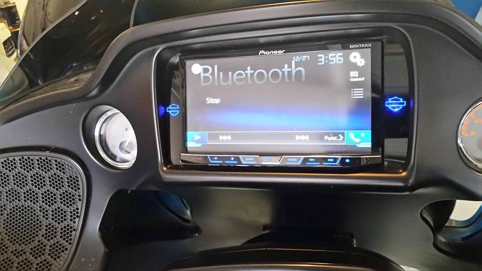

Hey guys/girls, I see people installing single din head units into their Rushmore bikes,
what is the reason that we cant install a double-din in place of the infotainment unit?
Is it fitment?
Is it that no one makes a faceplate kit?
or some other reason?

I think its the bracket? But im not 100% sure. Hit up vtwin audio though, brian was working on a double din for an alpine install.

There's a piece of the inner fairing that's in the way. If you're not afraid to cut your bike, it shouldn't be a problem.
Problem is, because it requires more modification than most ate willing to do, I don't imagine anyone's going to make a mass produced face plate.
That being said it has been done, search the forum, there's at least 2-3 threads on the same setup.

there's a group on facebook, Harley Davidson Bagger Stereo, there's a guy on there selling a kit with a cutting template included.

You beat me to it Bunker, saw that post a couple days ago!
https://www.facebook.com/groups/HDBa...9654554784435/
You may have to join the group if you don't already belong. (need FB account too)
But here's a picture of it.
