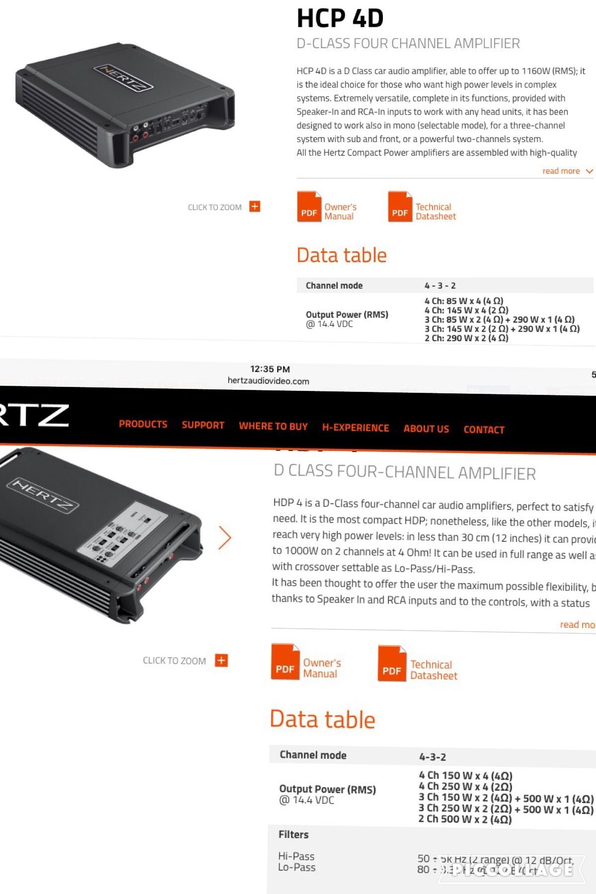

So the difference in the 65 watts is that significant? I have no idea that's why I'm asking. Thanks for the input guys.

Oh yeah! HUGE DIFFERENCE! Here's the thing Brian. The Hertz Millie's are rated at 100 RMS i.e., Continuous power handling. Ideally you always want an amp that will produce twice the RMS of the speaker for the speaker to perform at optimum level but 1.5 will suffice. If you take 100 rms X 1.5 = 150 watts. The HCP 4D only produces 85 watts @ 4 ohms. This amp would underpower your speakers.
On the other hand the HDP4 is rated at 150 watts @ 4 ohms. Perfect for the Millies.
