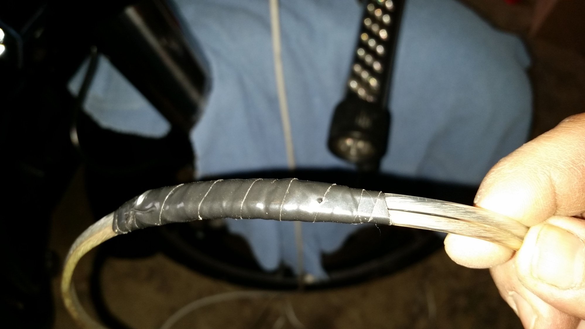

First up I used some 3M super 33 electrical tape to fill in the gap where the speaker wire enters the pod.

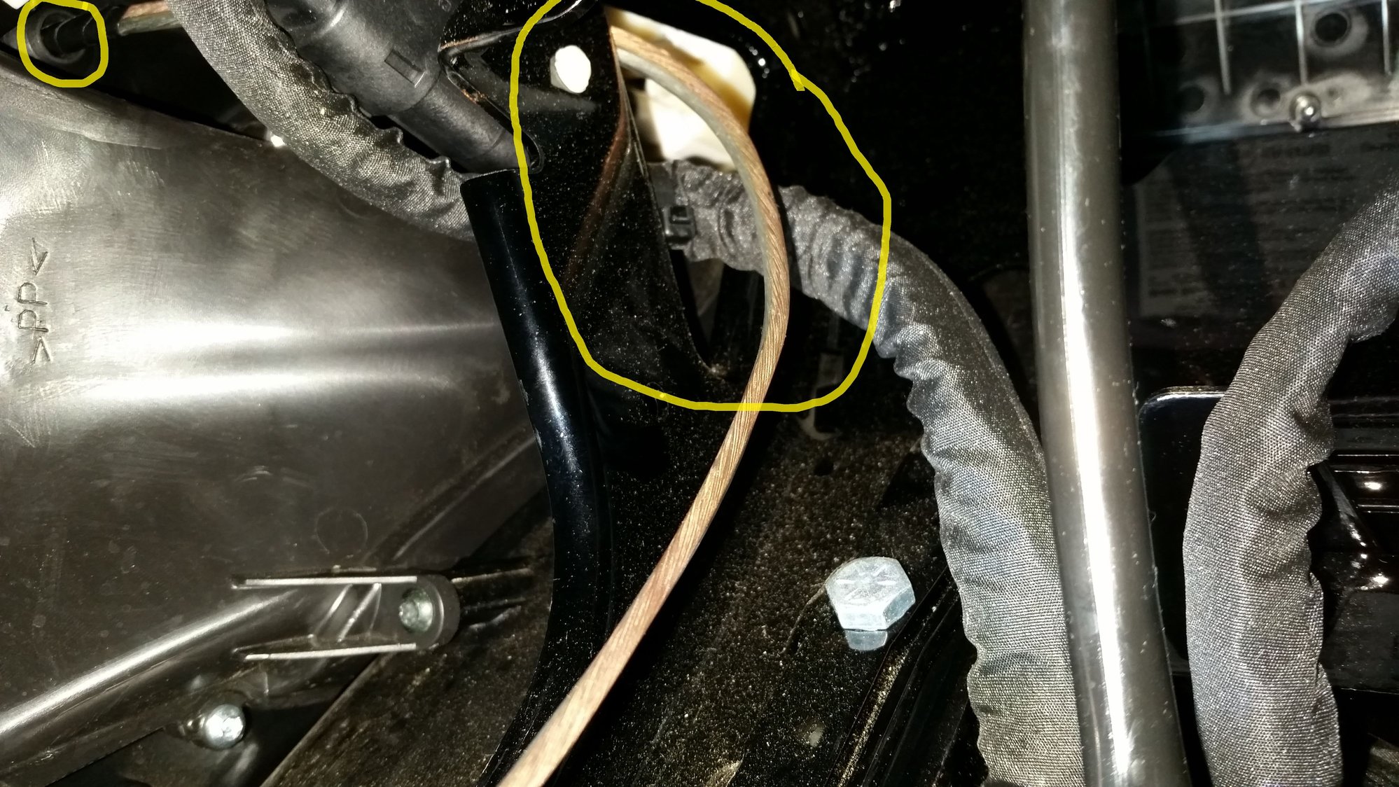

This next pic shows the wire entering the pod and also a nice little spot on both side head unit mounting brackets where wire goes nicely.

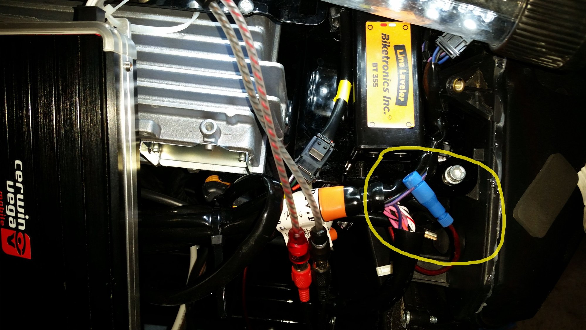

Next is where I tapped the cig lighter wire to get power for the amp remote. I used the Posi Tap Tapits that I ordered from Custom Dynamics when I got my PlasmaRods.

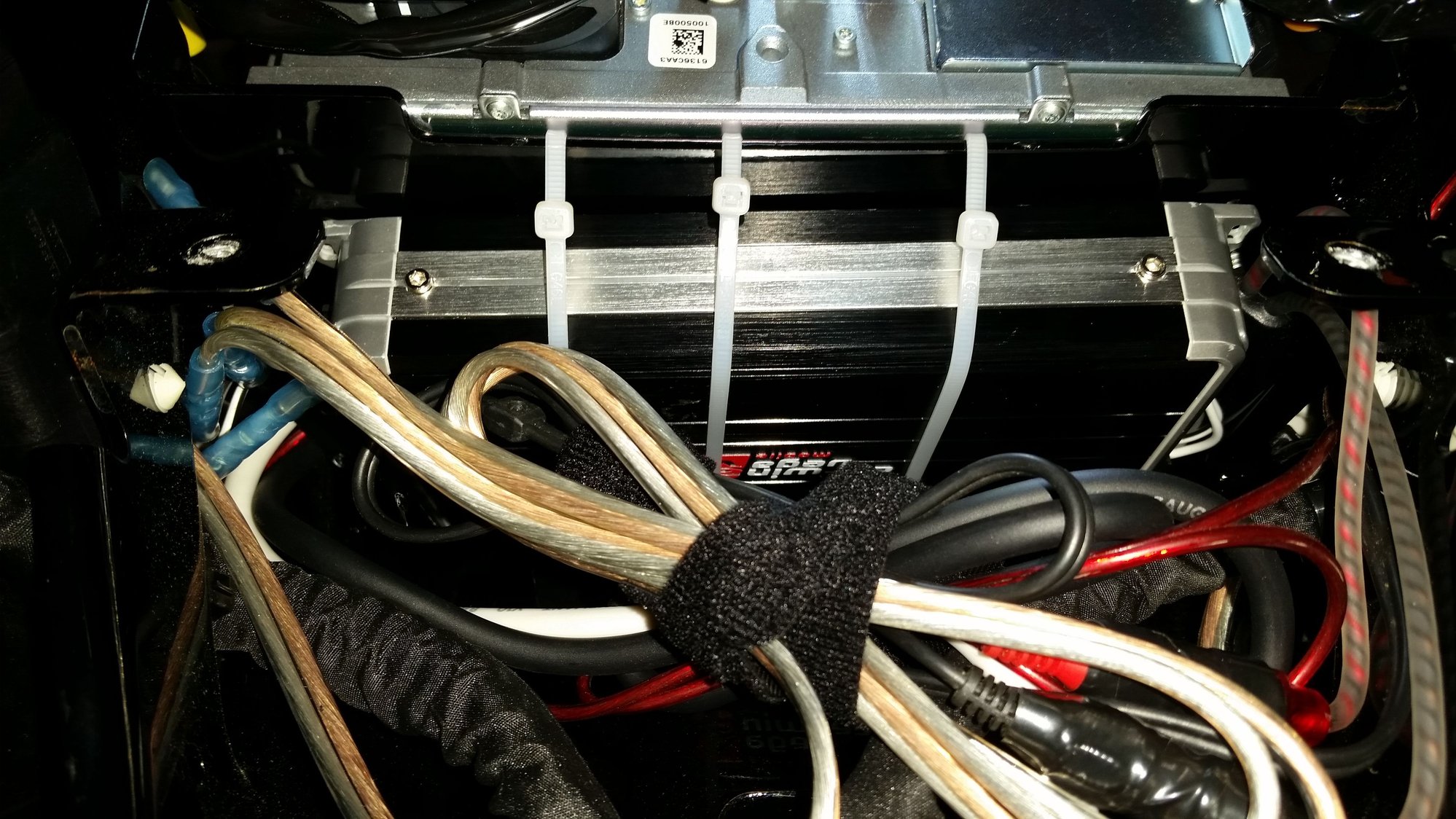

After tuning the amp, I used zipties to secure it in the space directly below the Rushmore headunit. Its a perfect fit for the B2 but not sure about any other amp. You can always mount it length ways and use velcro but I liked how it fit this way so I ran with it.
I decided to use Velcro loops instead of tiewraps just in case in the future I need to take it out for retuning or what have you, I think its easier to use these. YMMV

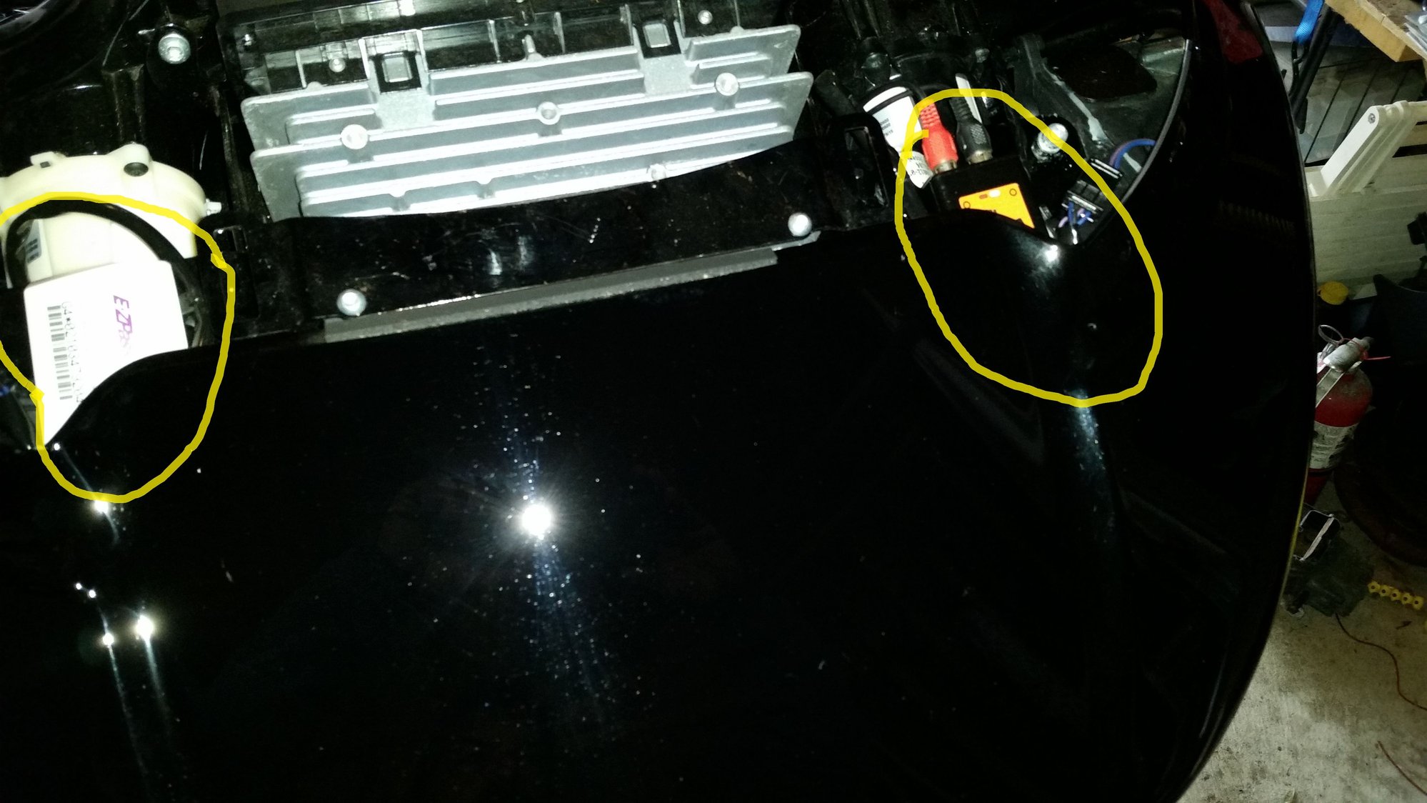

Ok so the faring is back on and I almost forgot to take this pic but as you can see if you have the new EZPass transponder which is more rectangular than square, it fits perfect in the space where the pod mounting bracket is. Same place as the BT355 just on the other side.

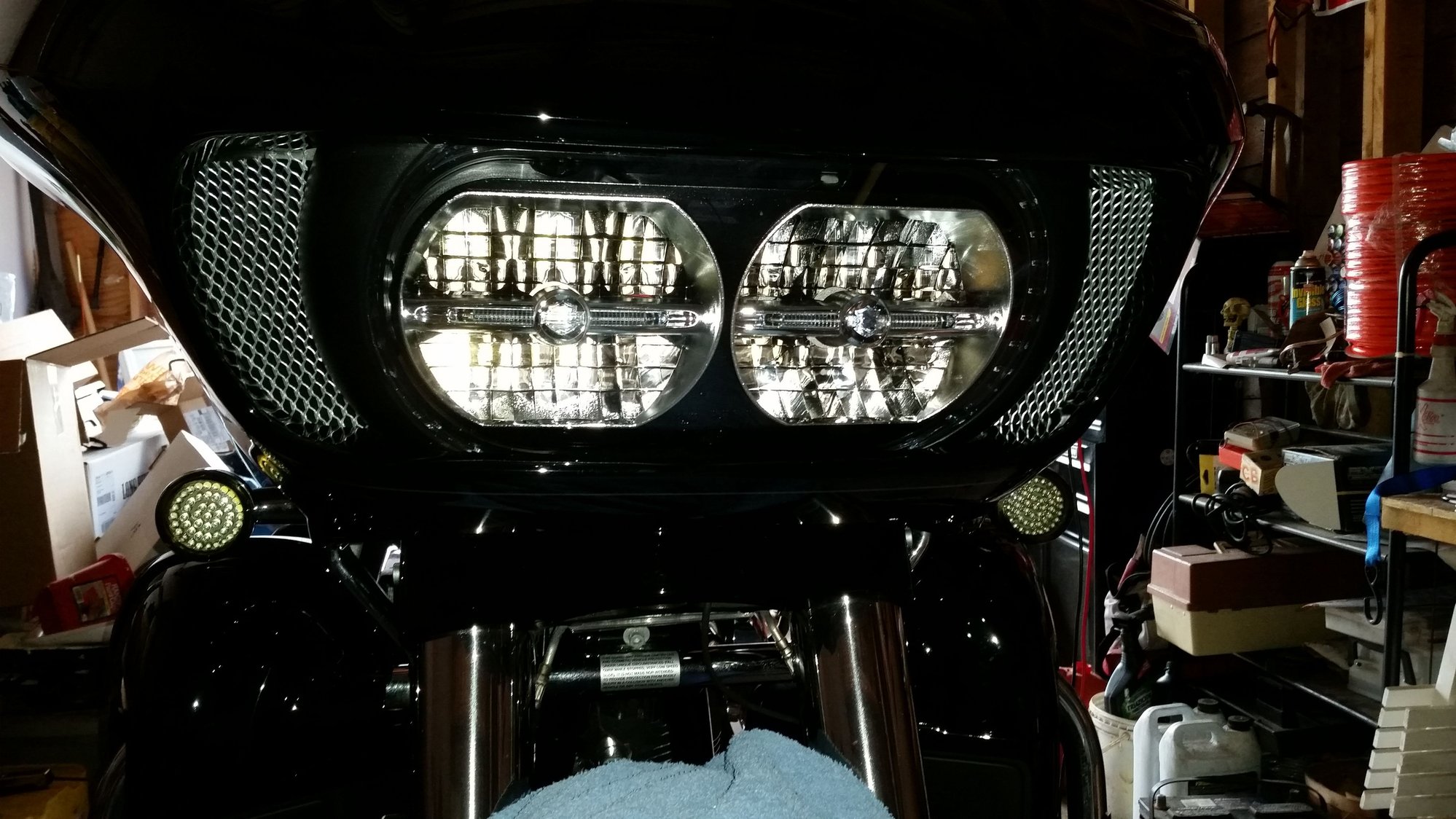

This last pic is of my 3 dollar vent screens. I figured since the fairing was off already I may as well see what I could come up with and there it is.
