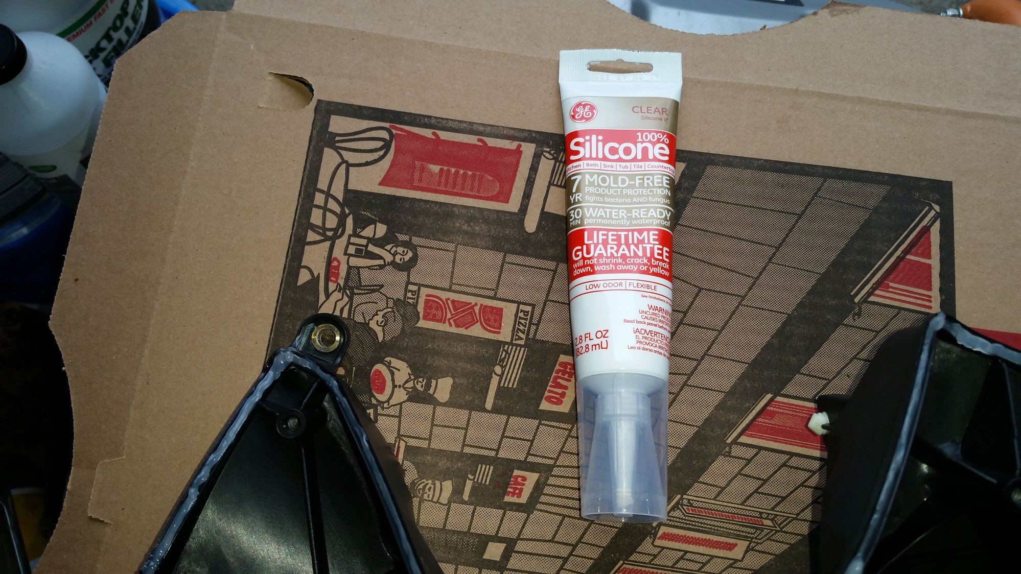

I used this to seal my pods, as was suggested by more than a few people on this site(thanks for the tips guys).
1 tube will probably do 3 pods and it was like 3 bucks.

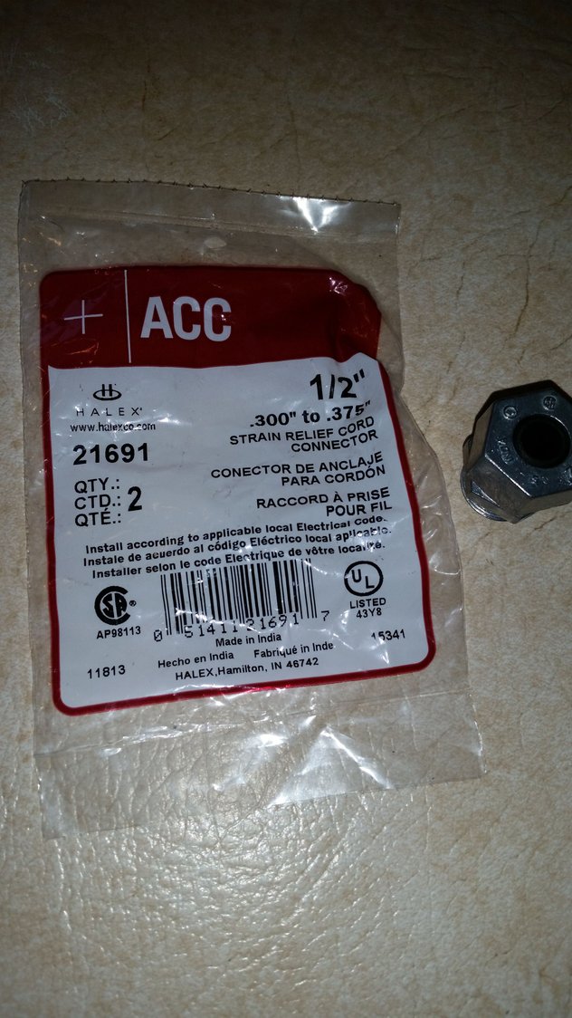

I removed the factory speaker harness and used the rubber strain relief from these to insert into the vacated hole. Its a bit of a tight fit but with just a bit of work it fits in nice and snug.
Lowes and Home Depot both have them it is in the electrical department and is a 1/2 inch strain relief. A 2 pack will run you a couple of bucks.

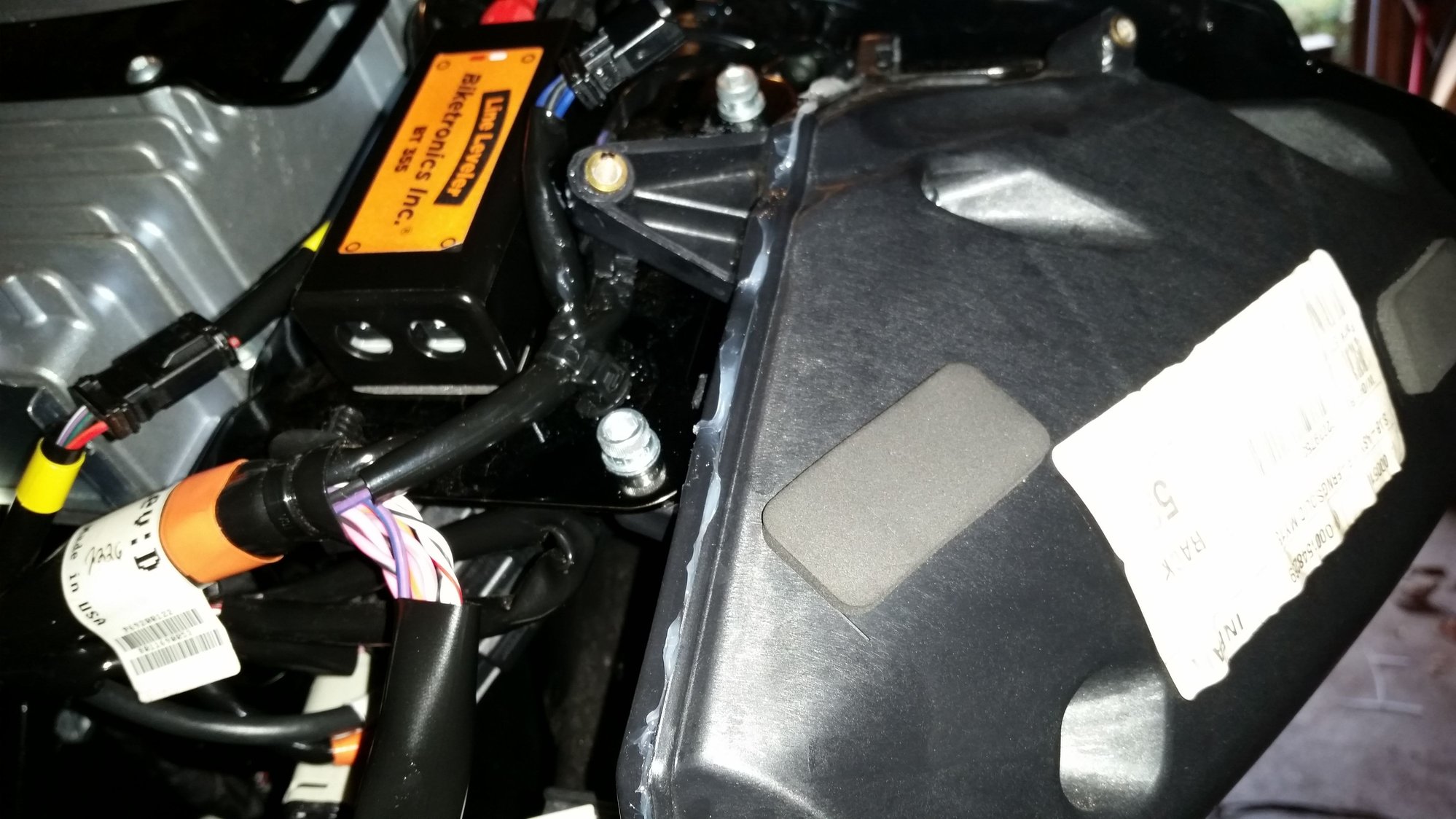

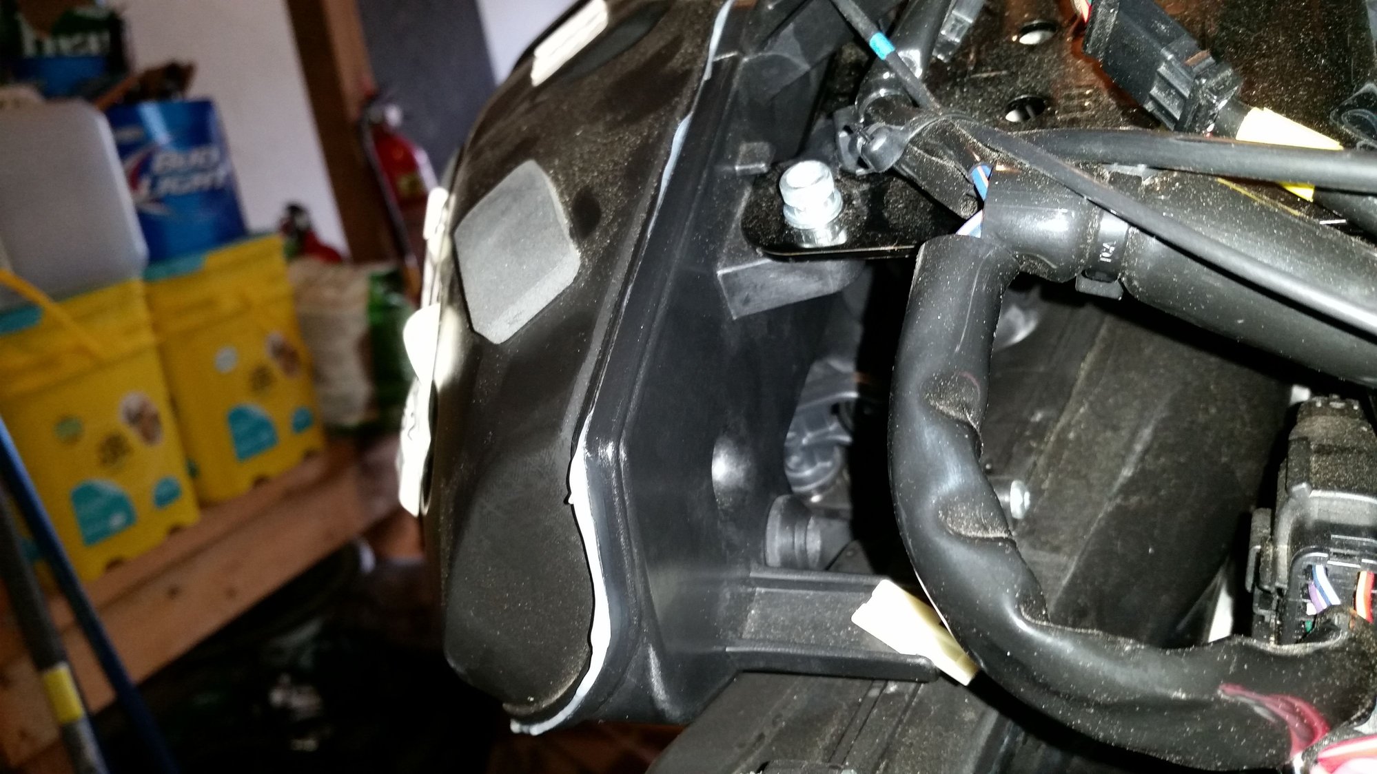

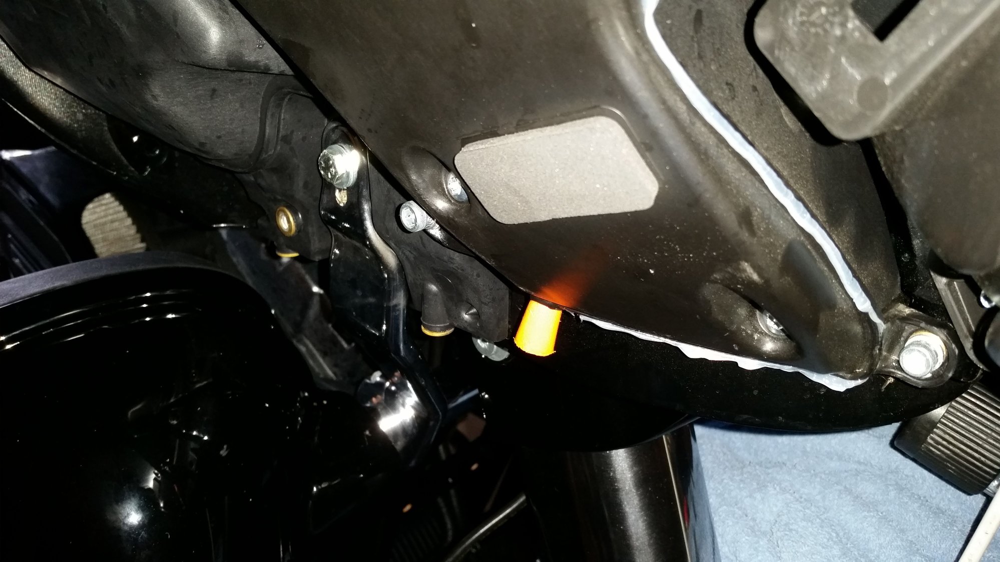

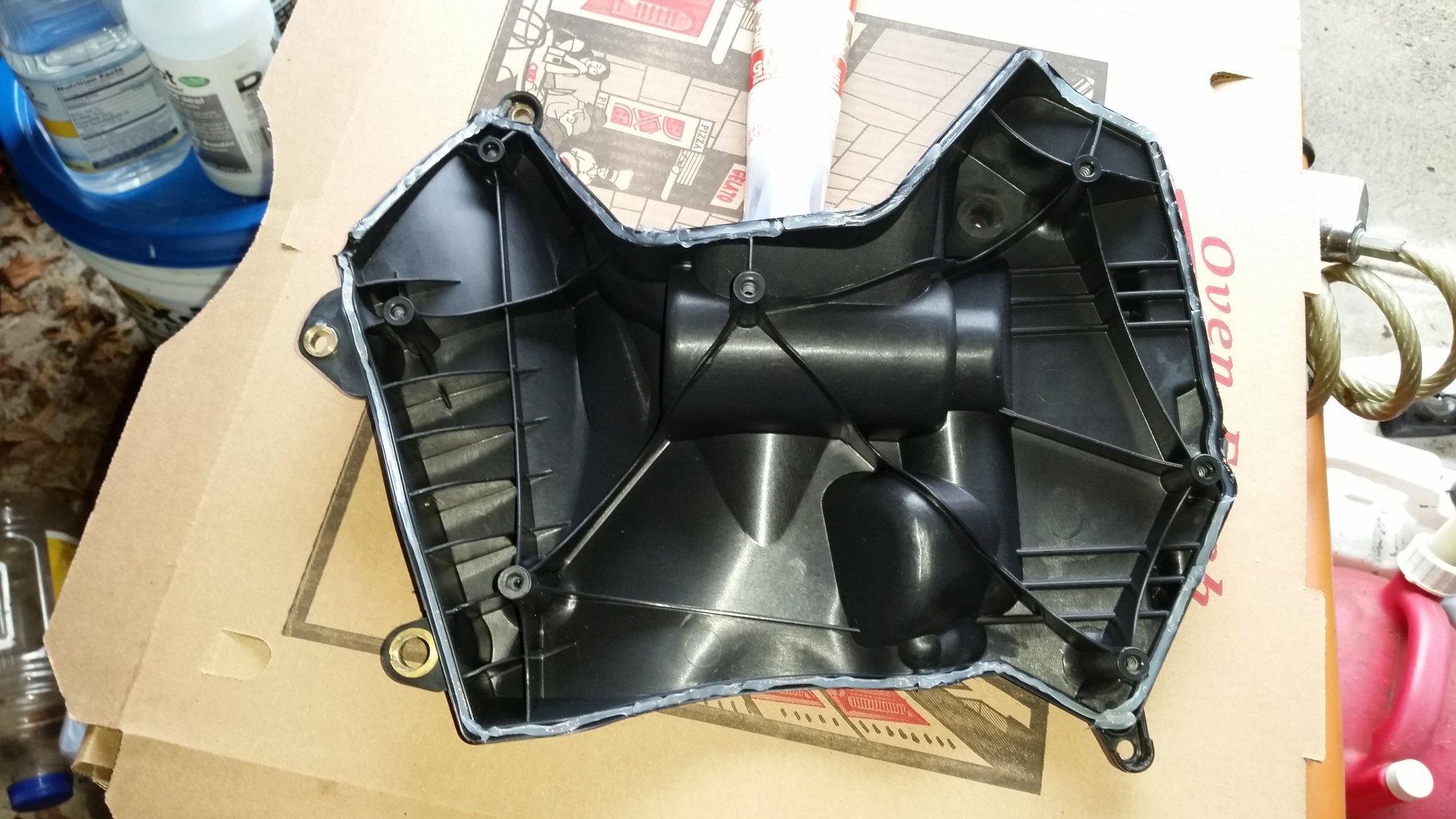

Next up is the use of the sealant.
Notice in the upper left of the pic where there is no silicone, that is the drain hole. You dont want to fill that in, instead you can use a sponge ear plug to put in the hole. It should be enough to seal the hole but easily removable in case of excessive water in the pod. I can not take credit for this idea, I read it in one of the threads and wish I could remember who it was who pointed this out so as to give proper credit, never the less, it was a great idea and thanks to the poster who first suggested it.

Here is a shot of the strain relief in the pod on the bike.
