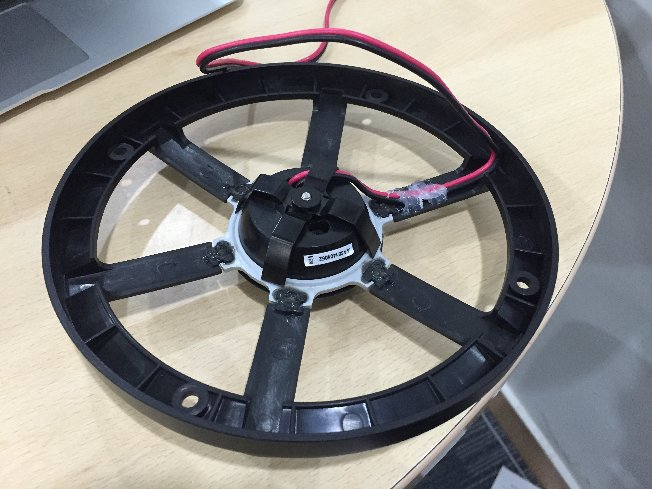

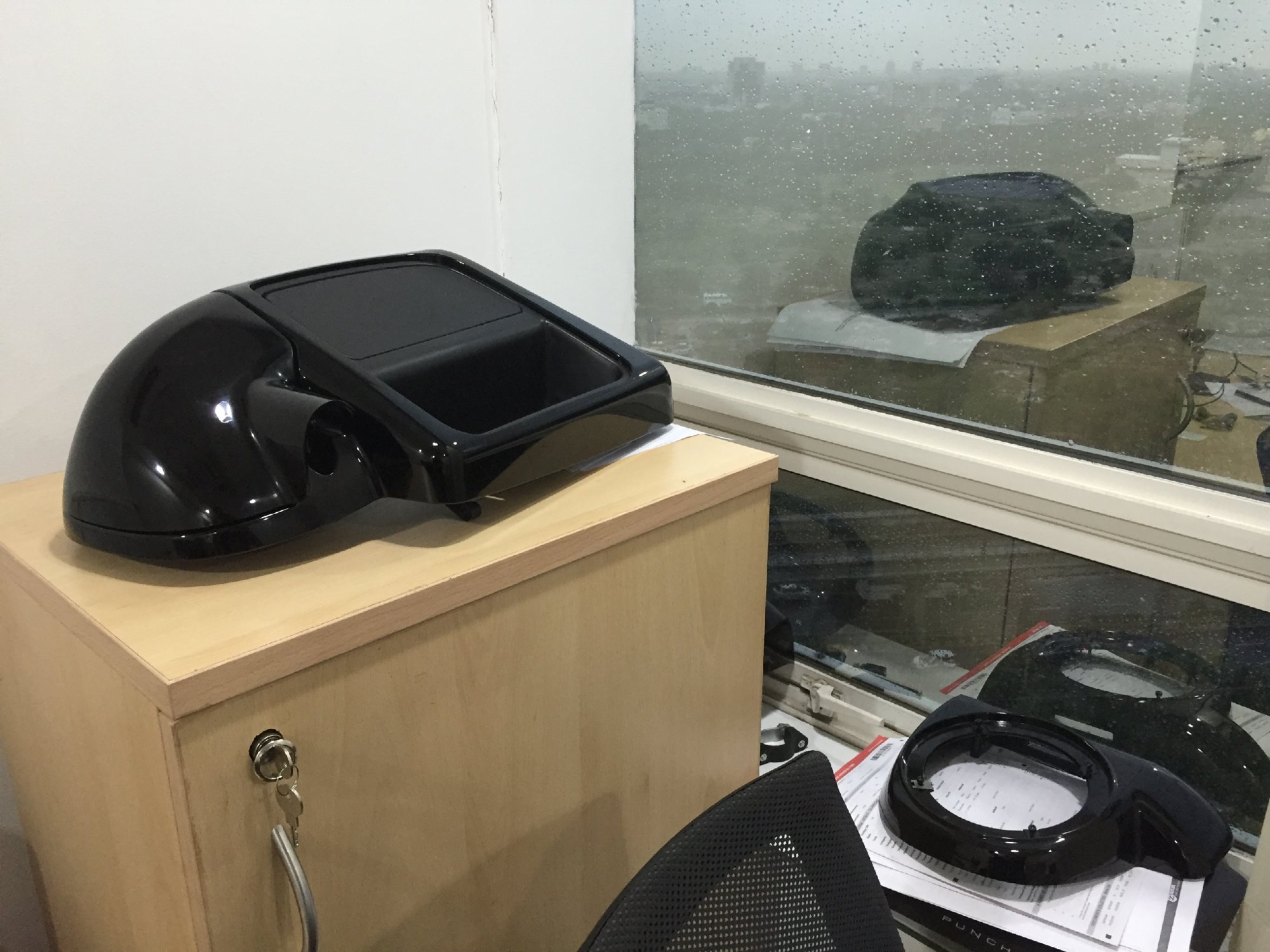

Lower fairing and pods painted and buffed.. i think i did a decent job given this was the second time i was painting.
tweeters attached to Grills
Back of the grill, Hot glued the wire from middle to make sure the wire and glue doesnt touch each other when woofer start to move up and down. also had to chop off few mm;s from the steel bracket holding the tweeter pods

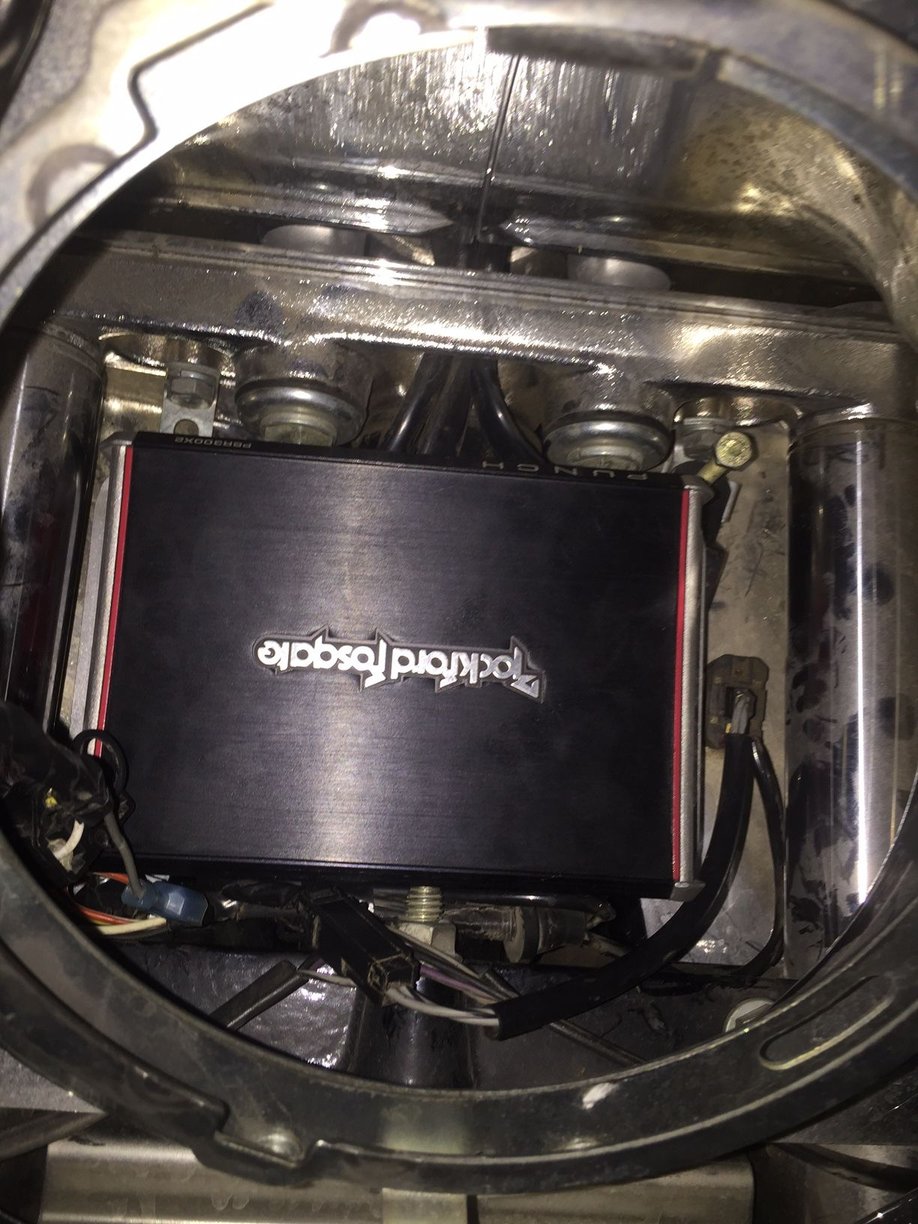

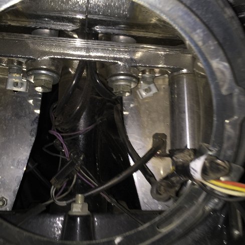

I have also being doing some research as to where to mount the amp and thought i could do it inside the nacelle. i opened the nacelle this weekend and boy what a real estate it has inside, i can easily fit 1 1/2 times the size of RF PBR300 still with a room for more.
the amp easily fits between the top and bottom bolt. just working on creating the mount, hopefully would be done with the mount this week.

Finally amp fitted inside Freight train nacelle, took me to create 2 Z type bracket and it fit flush. will start final wiring tomorrow. should be finished in couple of days.
here's a pic of amp sitting inside the nacelle.
all it need is a bit of rubber cushioning between the amp and bottom screw.

Looking good. Did you try fitting the headlight back on?

yes Bert, it does, infact there is nearly half an inch or about space in between amp and light.

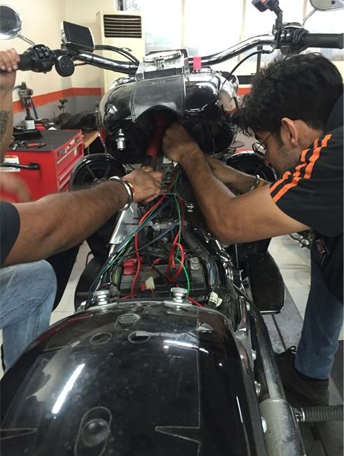

couldnt take out the Tank, so had to take the bike to dealership for tucking in the wires, having a creative technician has its plus.. lol
a shot from the WIP :

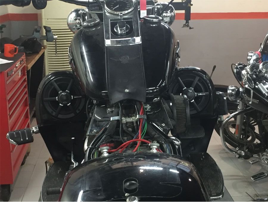

wire being tucked inside the tank.
all wires hidden under tank.
