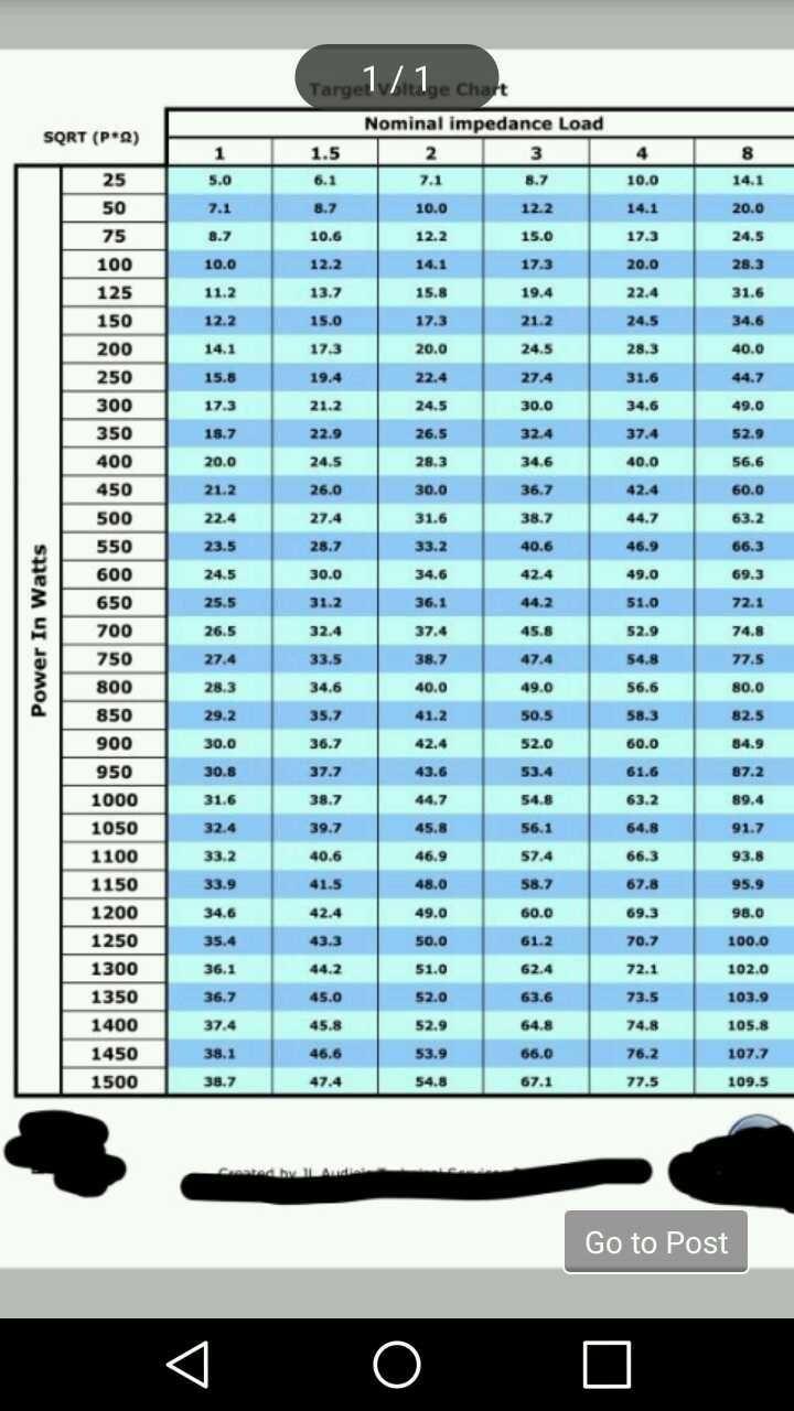

Setup is an arc xdi 600.4 BRIDGED. RMS is 300 (bridged) per channel
Speakers are Hertz Millie MLK 165.3 300watt MAX/150watt continuous @4ohm
If my calculations are correct that equals a line out voltage (tested with DMM using a 1k test tone) of 34.64 thus giving me the 300 watt output bridged, per channel/speaker. There's only one gain adjuster for this amp in bridged mode.
Here's what I'm needing, I need to dial the amp gain back to get an output of approx. 200 watts to the speakers. I'm informed that this would be the highest I would want to run the wattage to these speakers.
How do I get it set to 200 watts??
I'm assuming that if a take the 34.64 and divide by 3 (since its based off of 300watts and I'm wanting 200watts , 11.55 is equal to 100watt per the above calculation method 3x11.55=34.64)
Is it safe to say that if I DMM it to 23.1 then that should be 200watts output, correct?
Any help or insight would be appreciated.

28.3 vac

There is a free app in the apple App Store called "Ohms Law" and is as simple as it gets.
28.28
