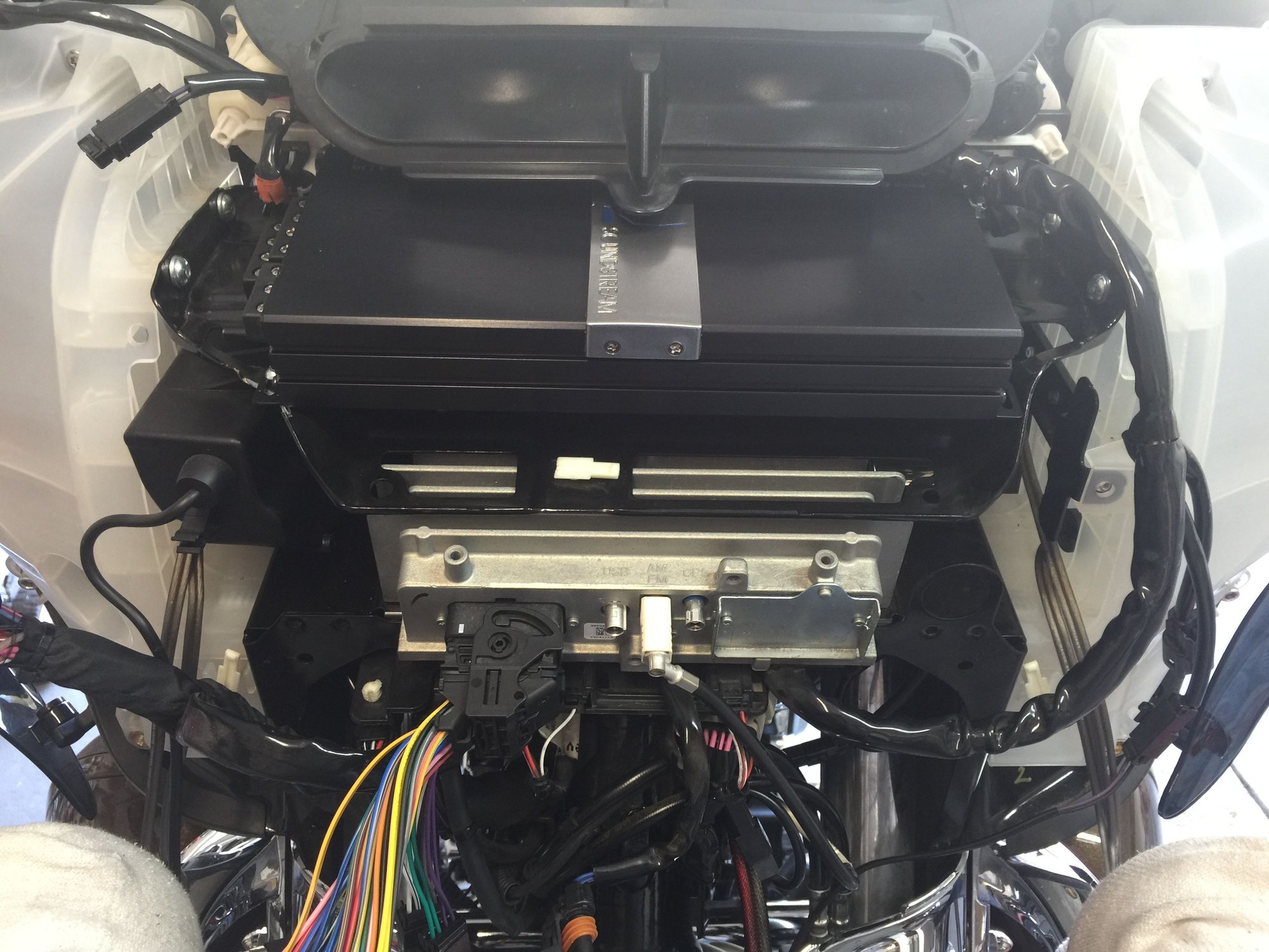

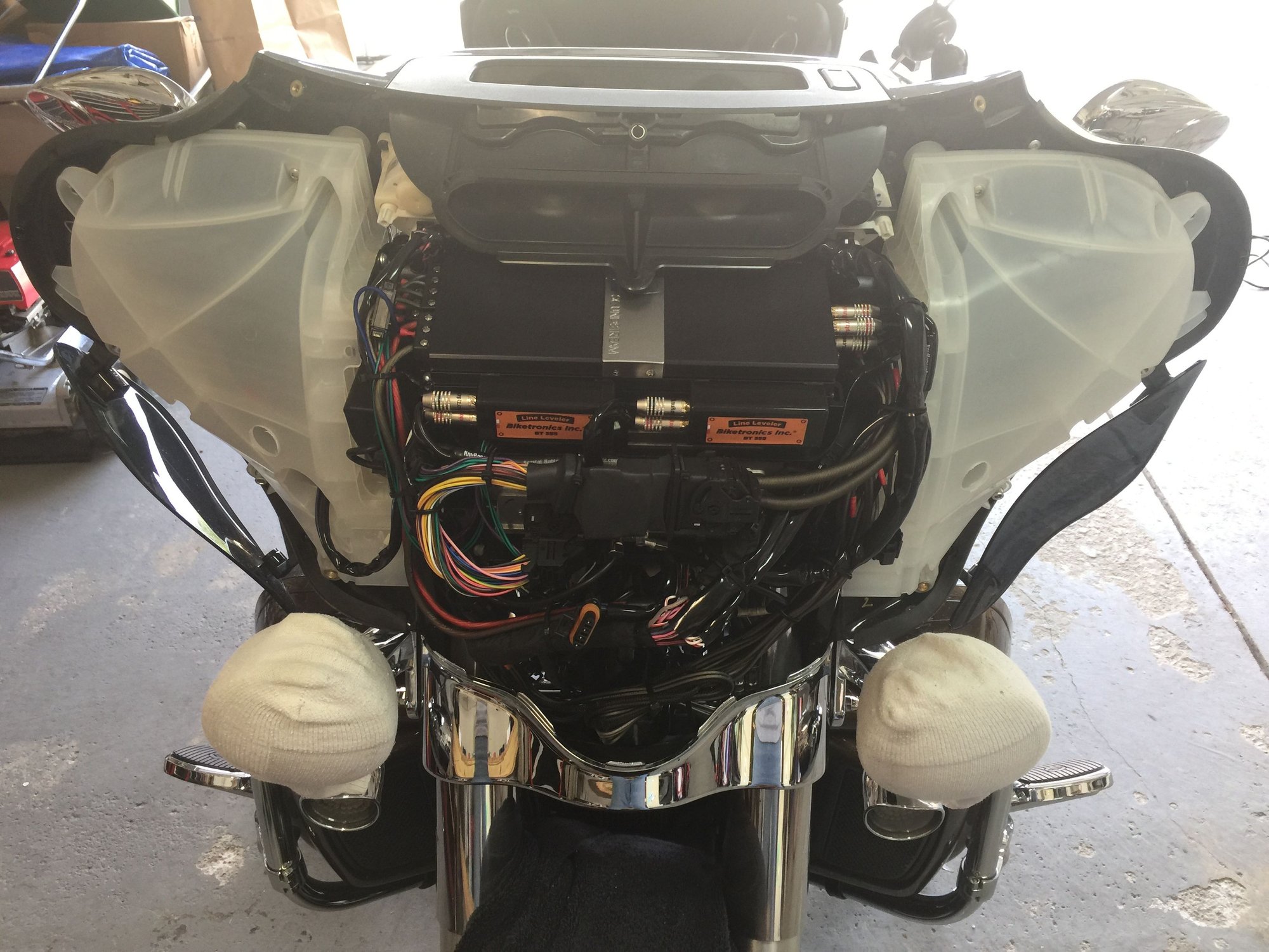

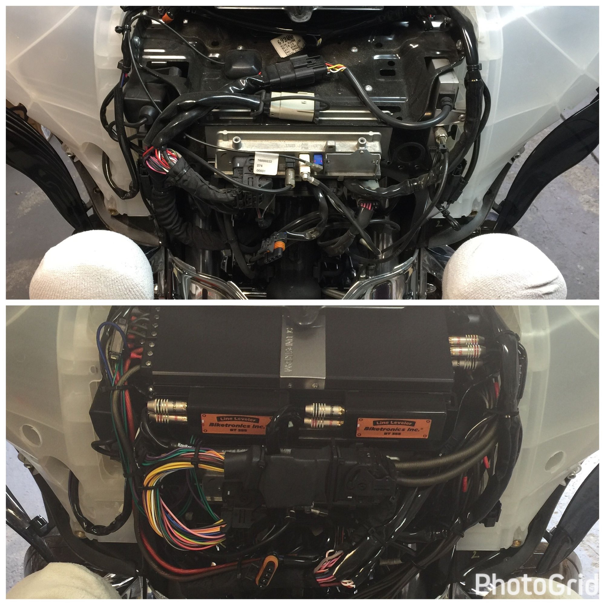

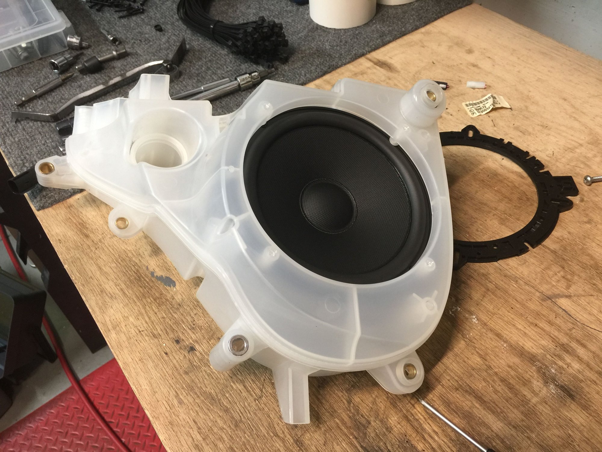

Just finished my first audio install/upgrade on the bike and I just wanted to drop in here to thank those who suggested things and answered questions. Chris and BBoy thanks a million for your responses and time. This forum is invaluable and many contributed to answering my questions without knowing so thank you to everyone!
The goal was a $700 or less upgrade so that I could actually hear more than just the words and distorted mids that the factory system produced at speeds >50mph. Although budget and dealer stock constraints kept me from going with BBoy's all DD suggestion (BO harness kinda jumped the budget) I have to say i'm VERY happy with the sound coming from the system I pieced together. Here's what I ended up with and some pics (if they load) and where I got the components from:
Infinity Kappa 60.11CS 6.5" (front) $170 - Amazon
Biketronics BTBOC Rushmore PnP kit $214.48 w/forum and military discount
Infinity Kappa 62.11i 6.5" coaxial (rear) $100.95 - amazon
Sound stream PN4. 1000D Picasso Nano $128.99 - amazon
EFX Harley-Davidson Amplifier Wiring Kit $49.99 crutchfield
Krystal Kable 2 Channel 1/2M Twisted Pair RCA Cable $22.18 shipped
Xscorpion SP-DE65 Stackable 6-1/2-Inch Speaker 1/2-Inch Up Depth Extender $6.99 amazon
Dynamat 10425 18" x 32" x 0.067" Self-Adhesive Sound Deadener $26.49 amazon
Misc Speaker wire and connectors ~$7 - Columbus Car Audio
