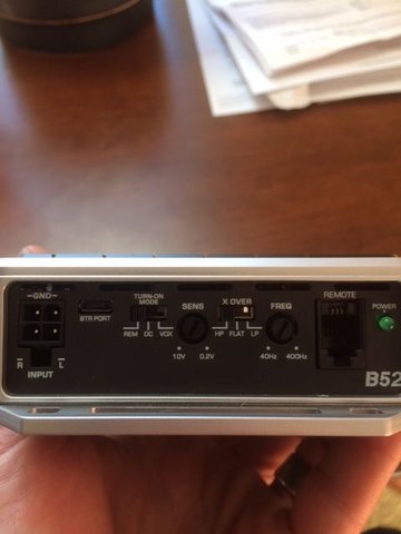

This is my first amp install, please excuse stupid questions.
I picked up a Cerwin Vega B52 and INFINITY KAPPA 62.11i for my 15 RG.
I am using the BT 355 line leveler & Hogtunes bracket.
Reading the direction that comes with the amp is above my head, may as well be a different language :-)
I have looked at quite a few great post and have a question on initial amp setup,HOW DO I DO IT
I saw one post that talked about the X-over/Freq & gains setting but I cannot find it.
If some could advise or point me in the right direction that would be much appreciated.
Colin

Cross over I believe is the frequency. Gain is the sens. Depending on the HU/ Head unit the xover is set. I have a Kenwood X998 best on flat. Not sure what the far left switch/setting is. Not an expert. but learning. good luck.

As far as setting the amp up you can either use a test track( 1000hz) and a multi meter or just play a song your very familiar with and turn the gains up until you hear distortion then back down a bit. Head unit settings for bass and treble set at the middle. With the kappas try running the switch on hpf on the amp and the frequency between 80-90hz

I was playing with the BT355 gains & HPF, oops
So as Budda109 says, the "Gain is the sens" on this Cerwin Vega?
Honestly, I though guys meant to set the gains on the BT355 as that is the only thing I saw gains on, I will set back to default or as close as I can.

Before you damage any of your investment on speakers I would suggest that you contact Biketronics and see if they can send you the procedure to reset the BT355 to specs or send it back and have them reset it for you.
Those adjustments (gain and hpf filter)are hyper sensitive to movement and if not done correctly they will destroy any and all speakers hooked up in your system at higher volume by sending the wrong frequencies out at boosted levels.

Just talked with Biketronics (EXCELLENT support)
Told me to turn HPF all the way counter clock wise for the HD head unit 4.3 and put gains to 11 o'clock.
Also told me how to reset the HD radio.(Attached .pdf)
