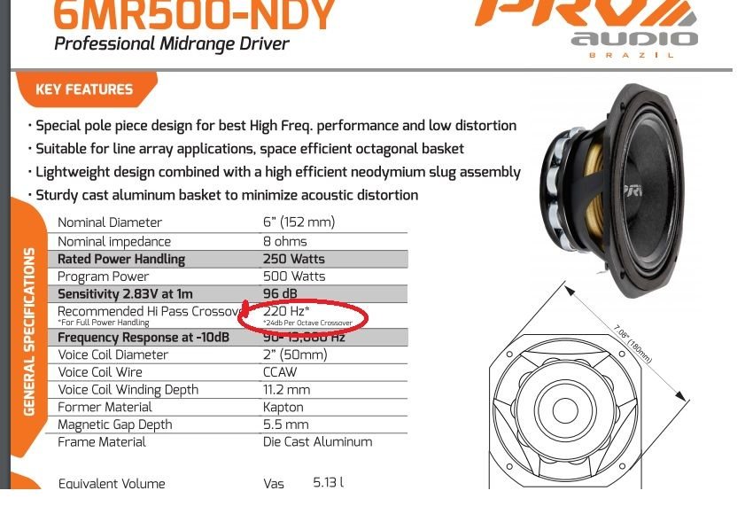

I have taken them down to 120hz, 12db slope and they are warm. But I have enough low end and put them back as I am sending them a stupid amount of power.
But with that said look at this!
I know we cross these lower than recommended, with plenty of power!
