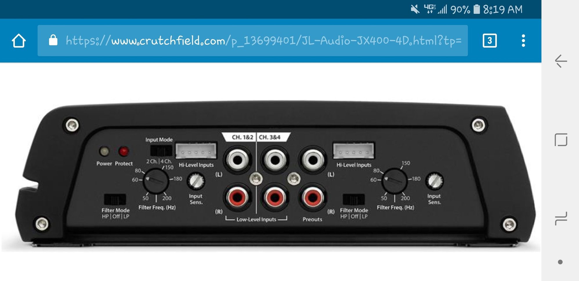

Should have the line leveler tomorrow and as soon as get it I can finally fire this bad boy up. Is there any settings I need to change in the head units (bass, treble, etc)
also what about settings on the amp? I am bridged across channel 1 and 2 on the output side of the amp. On this side that is pictured below, I have the rca cables plugged in to the channel 1 and 2 low level inputs. Which filter should i be on? High or low? And the frequency should be adjusted right below where I start to hear distortion, correct? Will I need to adjust the input sensor. Dial at all?
thanks again all for the help!

Set your hu flat (in the middle) on both treble and bass. Volume around 3/4. HP filter around 80. Then start turning up your gain until you hear distortion. When you hear distortion back the gain off a bit and you should be good. Also start the bike and fine tune the gain while the bike is running. Easy peasy.

When u refer to "gain" is that the input sensor. Dial?
