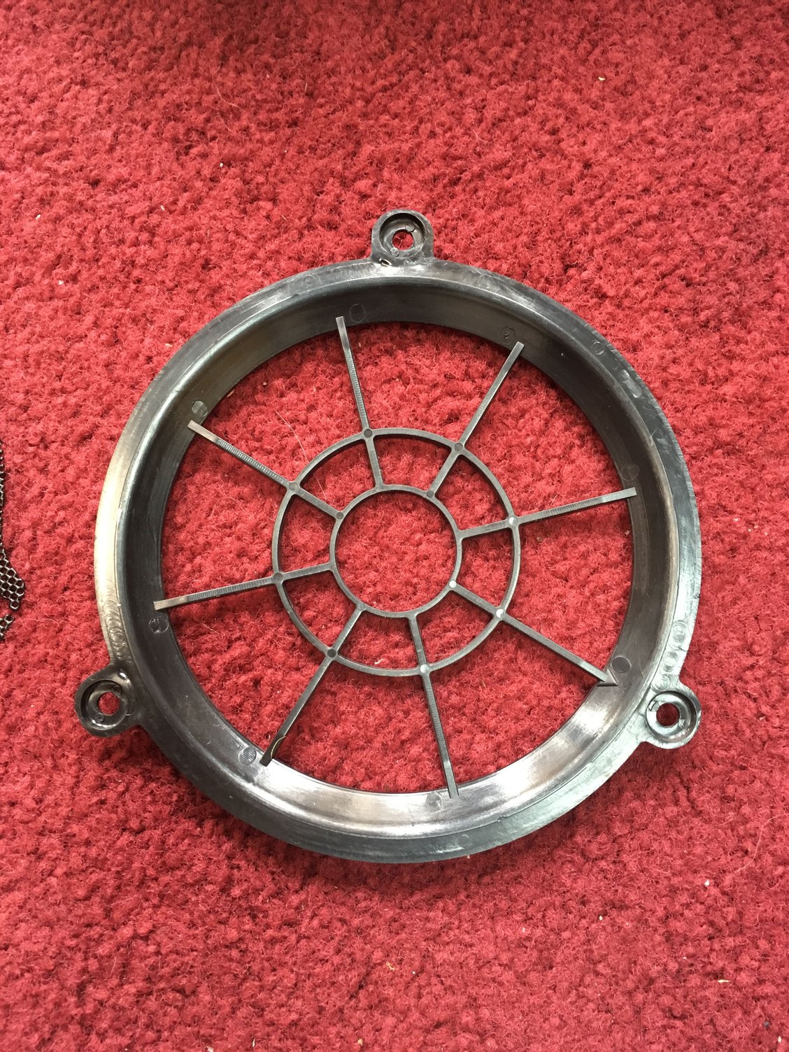

I took the back off the stock grills
I flipped them around and cut out the center and put my BT-30s in there.
I had to use 1/2" spacers on the speakers today make sure I had enough room but they are working fine.

Originally Posted by Rufnek100
Great insight thanks! How are they secured in the grills - the stock clips, silicone, etc.?
The BT-30s come with a screw ring that holds them in. I don't know about the AT-28s. The AT-28s may be too deep for this approach but I'm sure you could figure out something that would hold them in place.

Thanks for the clarification and good point on the depth comparison. I bet there's a way to make it work and flipping the stock plastic brackets around was a good idea - I could probably make a spacer to go between the tweet & bracket if it's too deep.
