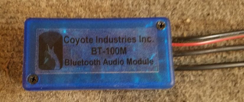

I used this Coyote Industries Bluetooth module when I had a stock radio. It work just fine. I upgraded to a after market HU with built in bluetooth so I don't use anymore. If your interested in it let me know.
