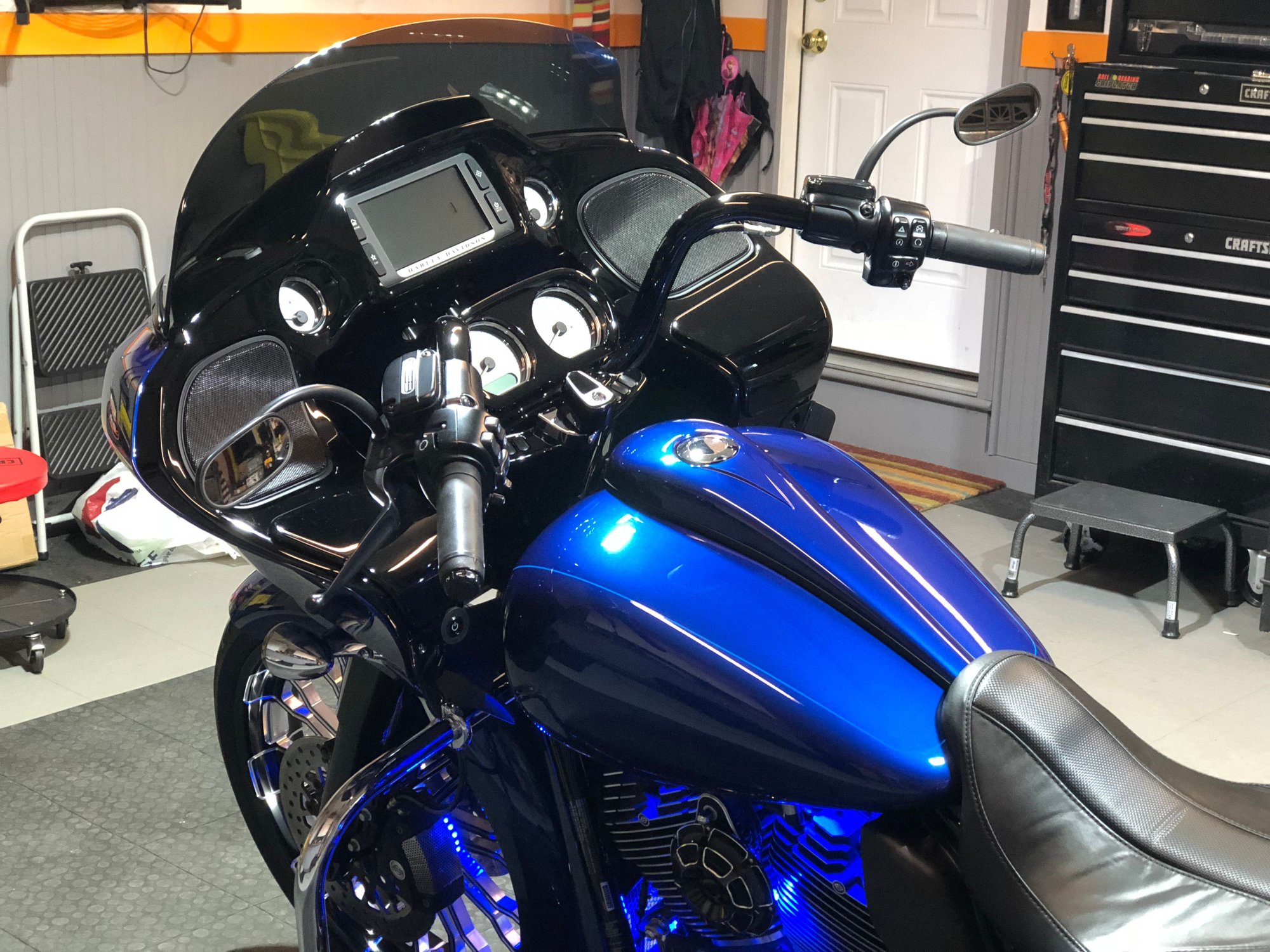

If you zoom into where the 12V power outlet normally is, you can see the switch mounted
looks nice. What switch did you use and how is it mounted? Is there a trim piece to fill the hole?
Old Apr 23, 2018 | 12:06 PM
  #50
DE-Glide's Avatar
DE-Glide
Joined: Aug 2017
Posts: 36
Likes: 5
From: Wilmington, Delaware
Thanks!,
Here is the switch used:
https://www.amazon.com/gp/product/B071H9KWL6/ref=oh_aui_detailpage_o06_s00?ie=UTF8&psc=1 https://www.amazon.com/gp/product/B071H9KWL6/ref=oh_aui_detailpage_o06_s00?ie=UTF8&psc=1
and I did have to make a filler piece. I just dug around through my miscellaneous screws, nuts, bolts, washers box and found a piece of circular plastic with some height to it that worked out. I used the power and ground from the original 12V power outlet that was there previously, and then connected the output to the orange wire. I am only running 2 separate presets right now. I also wired it so that when the switch is activated it illuminates blue at the same time. This way is it very easy to tell what preset you are on.
