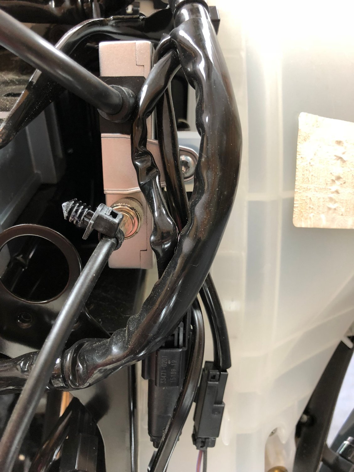

Sorry if this is dumb question to be asking. Had my fairing off today for a new handlebar install as I’m waiting for my audio parts to arrive. Looking at the radio and pods I could only seem to locate the molex’s for the left and right front pods. I didn’t see where the wiring was/would be located to head to the tour pak pods. I’m sure I overlooked it or just didn’t pay enough attention to it.
Here’s a couple photos.
Thanks for the help again.

Breakout harness instructions w pictures/diagrams are on BT website.

On an Ultra the rear speaker wires are in the big plug coming out of the head unit. They are not broke out into 2 separate plugs like the front speaks. Hence the reason for the name" breakout harness" from Biketronics.
Thank you very much for the clarification.
