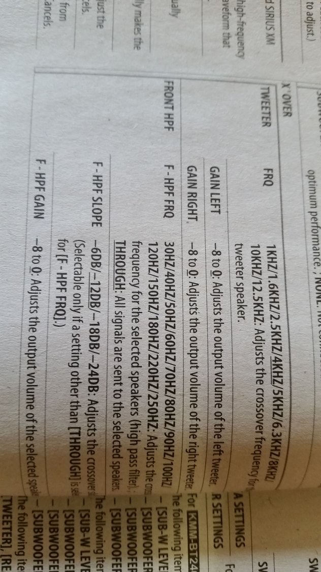

Originally Posted by Uncledeadly
Sorry to be a bug but....what should I set the crossover to on HU? I know you said 80 but...
Here's a pic of x over section of manual:
Front HPF freq @ 80hz

Also rear HPF if you are running them

Also, set your front HPF Slope to -18 and front HPF gain to zero.
