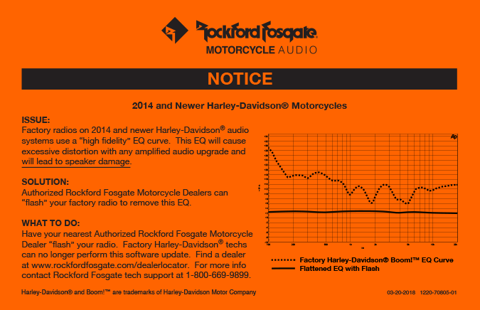

Originally Posted by Tailwind
Any idea specifically what a "Rockford Flash" is.
Thanks!!!
T
This is referring to flattening the EQ when flashing the radio. It's not a specific "Rockford Flash", but rather the settings within the software when flashing the radio (2 Speakers - Upper Fairing/1 Amp). If you don't flash the radio you severely clip the radio outputs feeding your amplifier. Using passive or in-line filters just attenuates an already clipped signal, so it will be distorted even before the signal is amplified.
Harley-Davidson uses this EQ on their BOOM! Audio systems that are not equipped with external amplifiers.
Harley-Davidson removes this EQ when upgrading BOOM! systems with external amps.

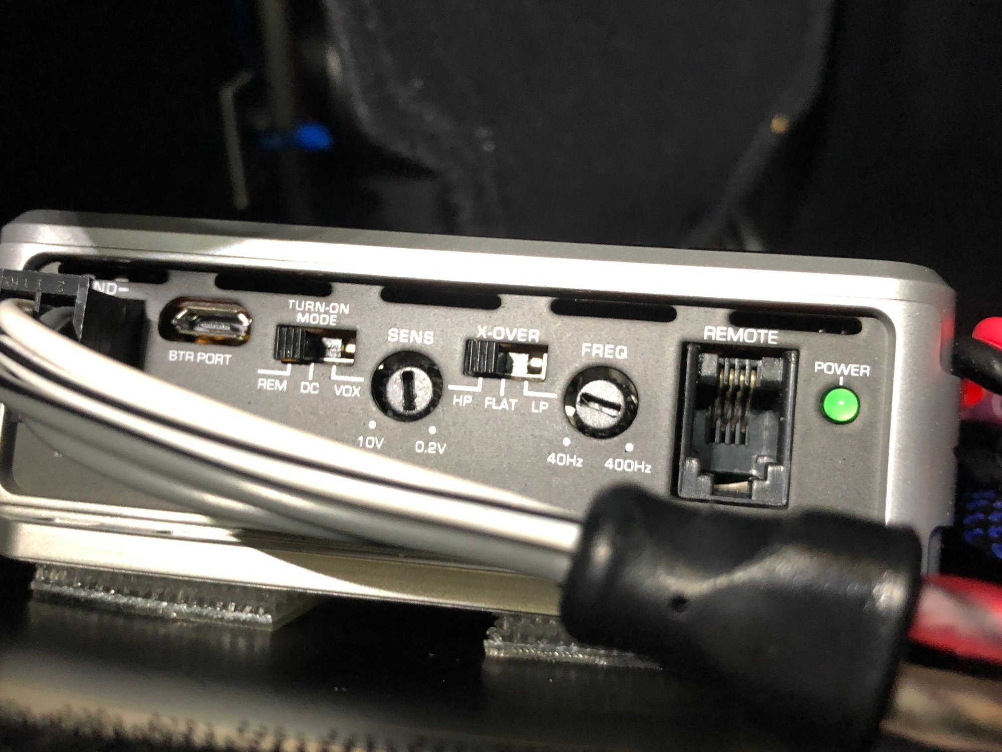

Originally Posted by Lastride
I’m not saying there isn’t a problem with these speakers. I’ve got a set with a RF Tm400x4 powering them for 4000 miles. I was riding in Virginia on vacation a week
ago in 90 plus degrees and had no issues. Speakers got warm but not hot, bags were full.
i Was running them off a b52 with hpf. Tuned by ear (although I did put a dvom on them at one point and thought it was ok). I’m a noob at tuning so wrote it off to operator error.
I have an RMA set on the shelf waiting to play with again. Crutchfield got my bad ones so no idea if the told Polk.
this is the b52 settings when I pulled them.
Excellent!! Thank for this info.
Just curious what the RF strategy currently is as our audio brothers seem to be all over the map regarding what flash will deliver the bust results. Most folks are using the zero amp 4 speak flash and has delivered fairly good results for a wide range of aftermarket products.
