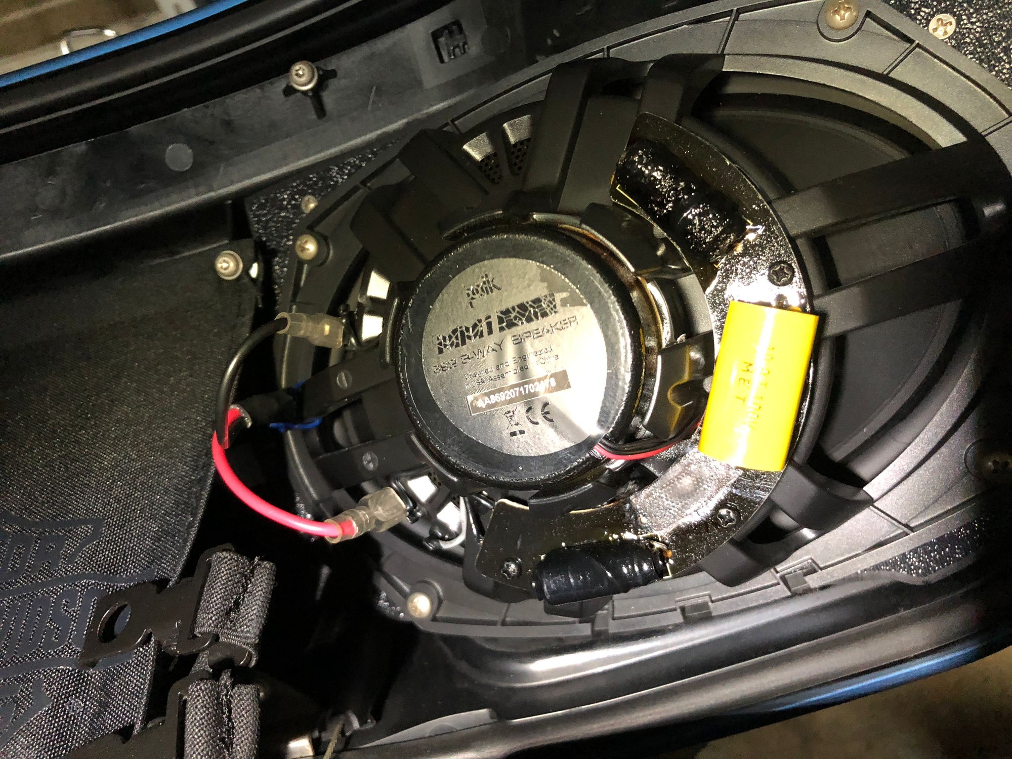

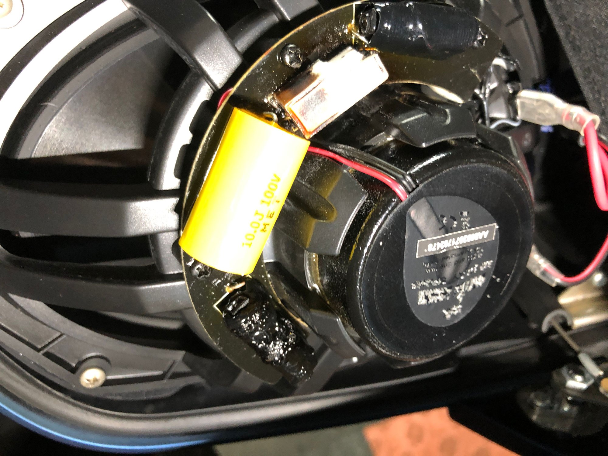

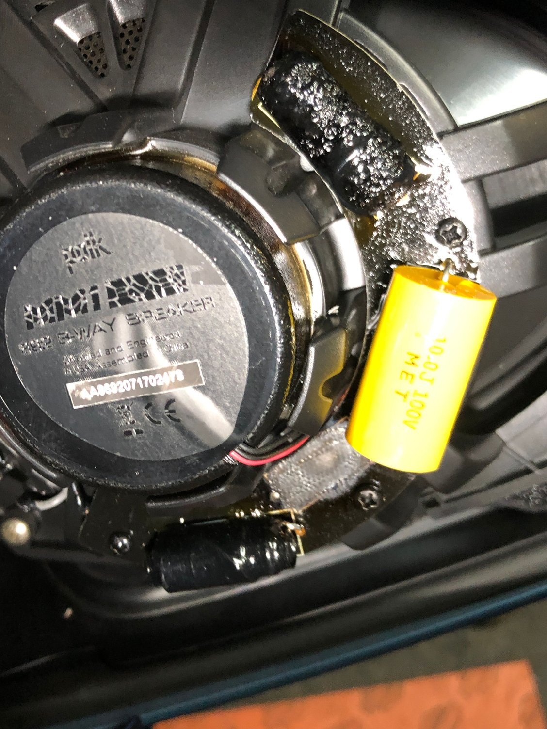

Just did an about an 1100 mile week of riding thru the smokies running Polk mm692's in the rear. Sound damn good and are water resistant but they got real hot. Hot enough to melt the cover off the coil over on the speaker. I am running about 120w to each of them so Im not over powering them. I will say it was around 90-93 most days but these just got real hot. The wdx 6x9's are decent but with lots of power, the highs can be ear piercing sitting still. Going down the road at speed, those highs are what you need to hear them. They are just a bit $$ for what you get to me. The hertz mpx 690's are damn good (about the best in my opinion) but $$ also and not water resistant. A bit of frog skin on your grills will take care of that. Sony xs-gs 6921's are damn good too for the price as the tweeters in those are soft dome and the highs aren't ear piercing. DD VO's are damn good too but no highs from them, just damn good mids. I've got a set of the new cpx 690 hertz that should be here by the end of the week and I will review them also. I don't suggest infinity kappa 6x9's as they have a history of the baskets (frames) breaking as they are just cheap plastic.
I believe if you are tight on cash, the polk mm692's can be had for around $200 a set, just be sure to keep any thing from touching them and not loading the bags up with stuff to keep heat in. The sony's are around the same price but have exposed coil over also.

I was thinking about the Polks but the melting thing sounds kind of weird. I figure they would get pretty hot in the rear deck of a car as well.
In looking at the two models of Polks I see an MM692 and a DB692. Am I correct in thinking the MM692 is the better sounding of the two? The DB692s are so cheap it almost makes me suspicious.

My first set of polks melted. I just assumed I had the tuning wrong. Maybe not. I
