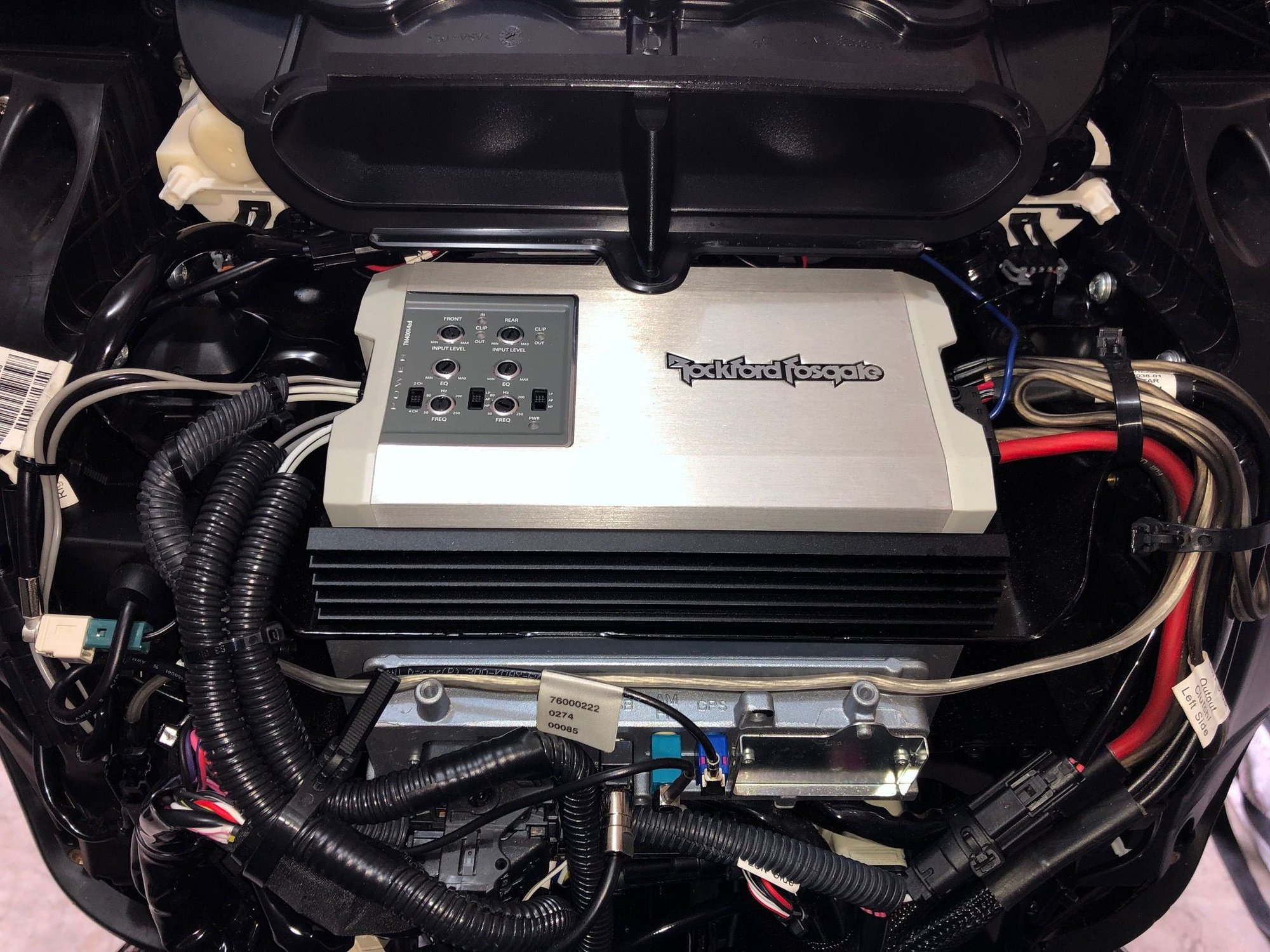

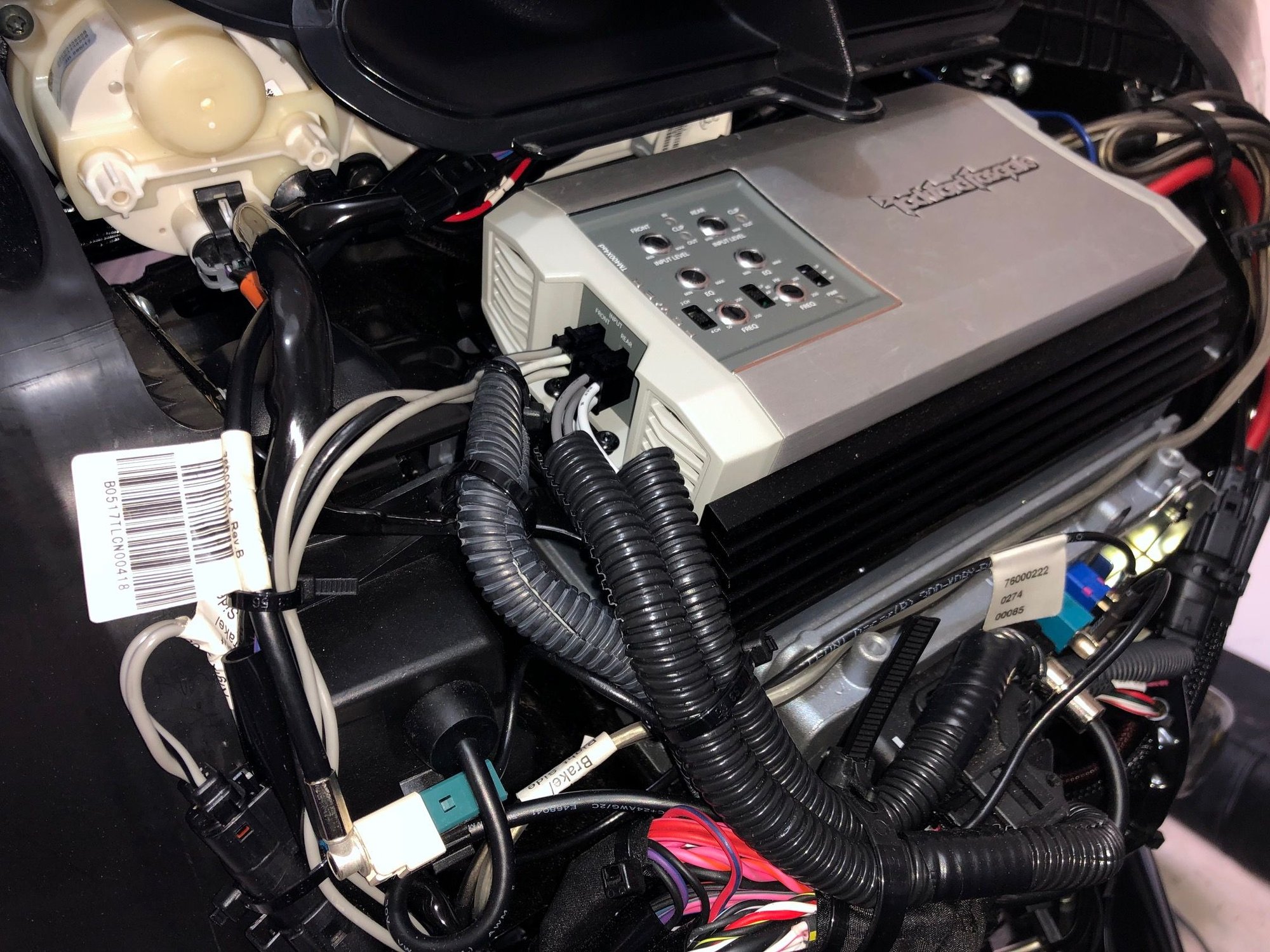

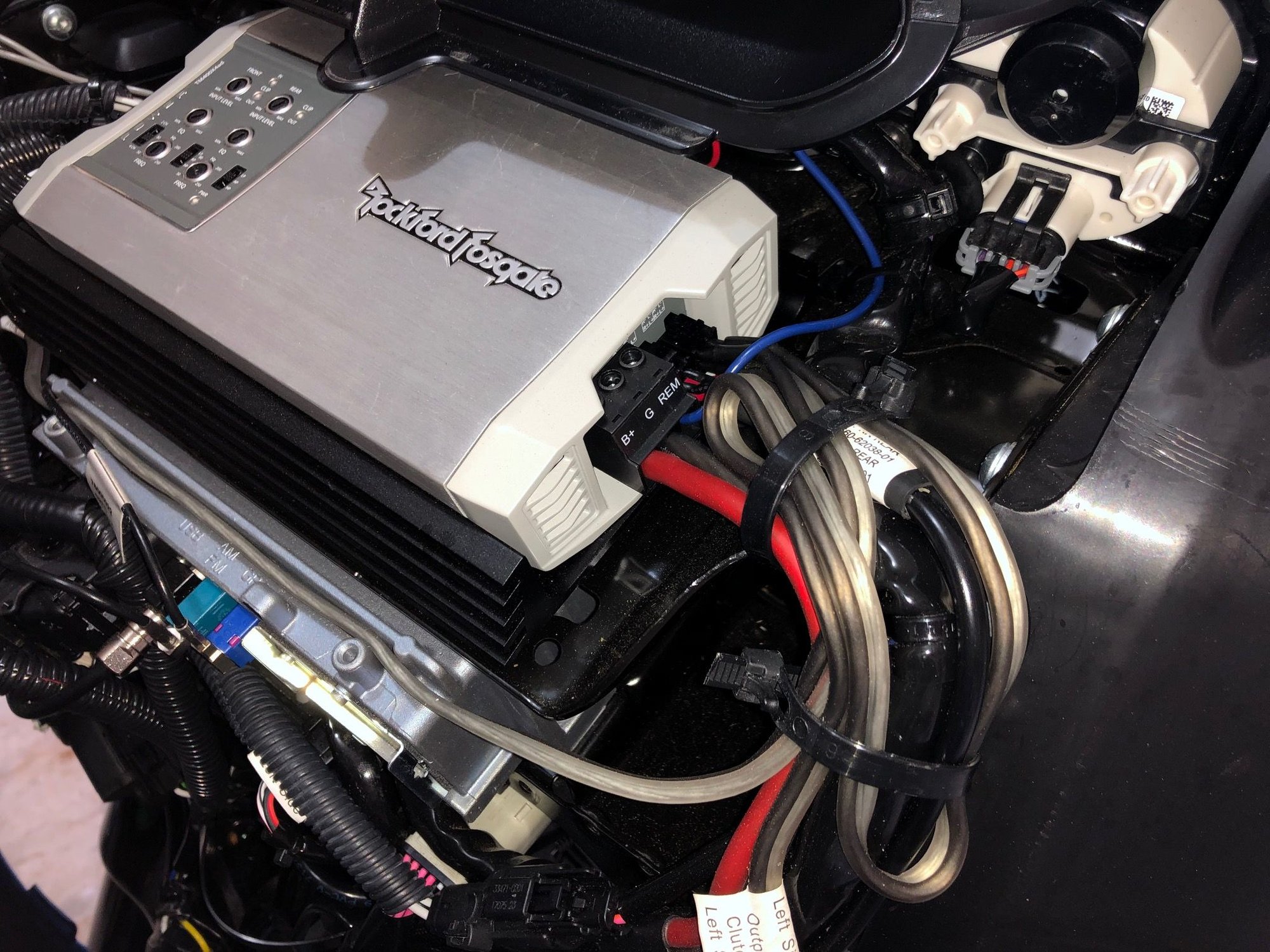

Thank you, valid point to keep in mind. Even with a correct flash, for front/rear fade to work, you need to have the amp connected with front/rear. I will attempt to post photos of my connection setup.
-Fastdog
Photos:
Left side Amp - Rockford Fosgate TM400X4ad
2018 Street Glide RF TM400 Amp
Right side Amp - Rockford Fosgate TM400X4ad

Thanks for those pics Fastdog. I don't have any experience with the Rushmore units but my neighbor has one so I like to learn about them when I can.
Seeing as how the amp is a TM400x4ad I'm wondering how strong the audio signal coming out of the head unit is with this flash. That amp seems to be set up for speaker level outputs more or less. I have one on a preamp output and had to boost the signal to it to get proper volume out of it. Rockford lists an input sensitivity voltage of 12v. Most head units seem to be around 4 or 5.

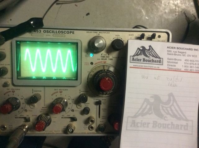

Having a DSR 1 already install with 8 speaker 2 amp flash (if I remember well), that give me RCA level output ( 4 Vpp @ 1Khz before clipping) from
the Harley Davidson HU, I wonder if the JM flash provide the same signal level output from the HU when following their procedure?
My systerm is Harley Davidson 6.5 Boom, DSR 1, RF TM400x4, Hertz MLK 1650.3.
HU output after the flash.

Sorry, 8 Vpp or 4 Vp. My bad.
