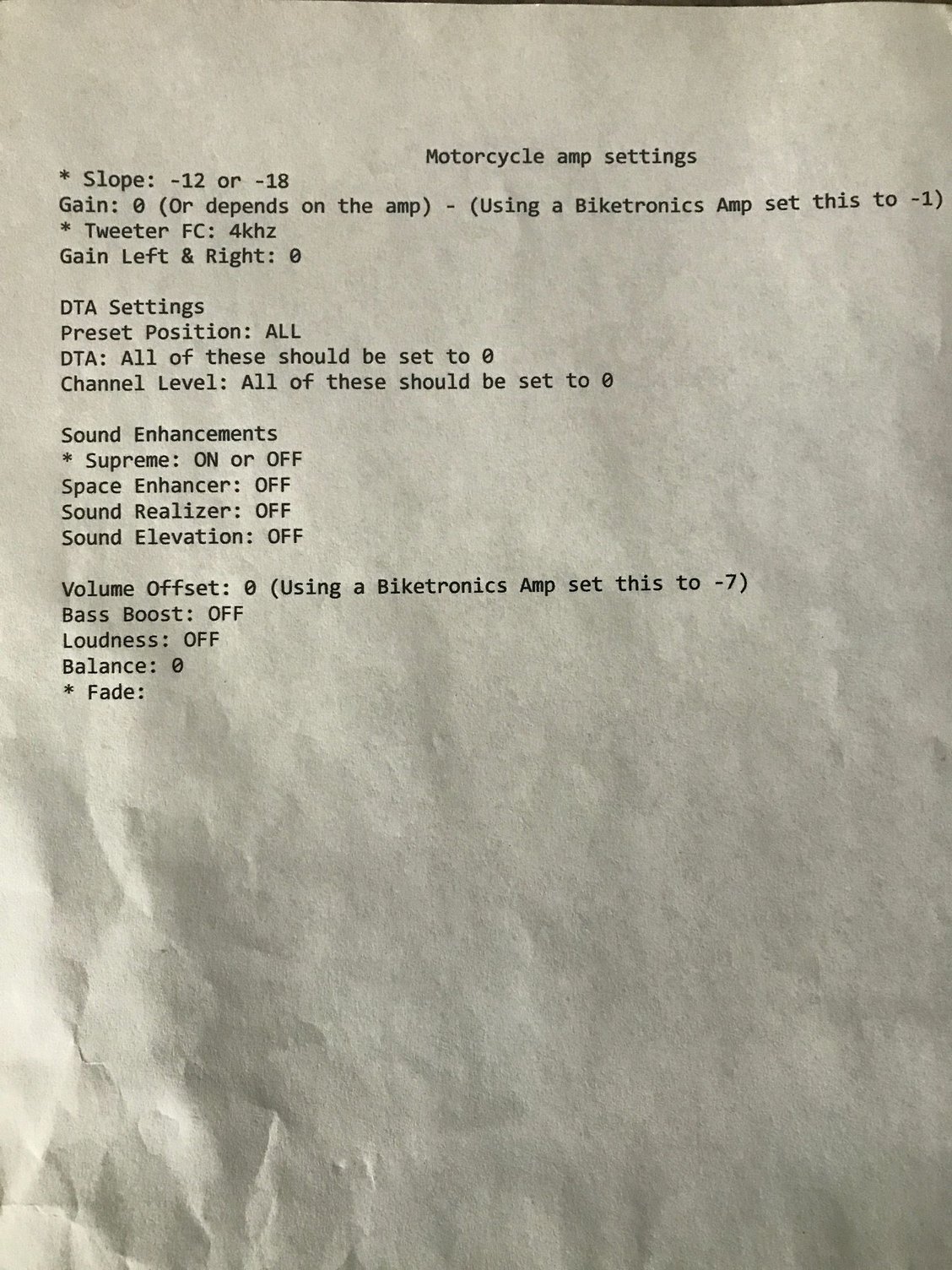

I have the amp at flat and run the crossover settings thru Kenwood x998. Pulled settings from another thread. Awhile ago I when I started playing with the sound system. Someone posted settings at that time which I printed. Might have been Haze324 or Gannicus? Can't find thread now sorry if I did not credit right person. I attached settings.

Second page. Any suggestions welcome thanks!

Looks good to me. Dont be afraid to play with eq and slope a bit to see if it gets any better or worse
