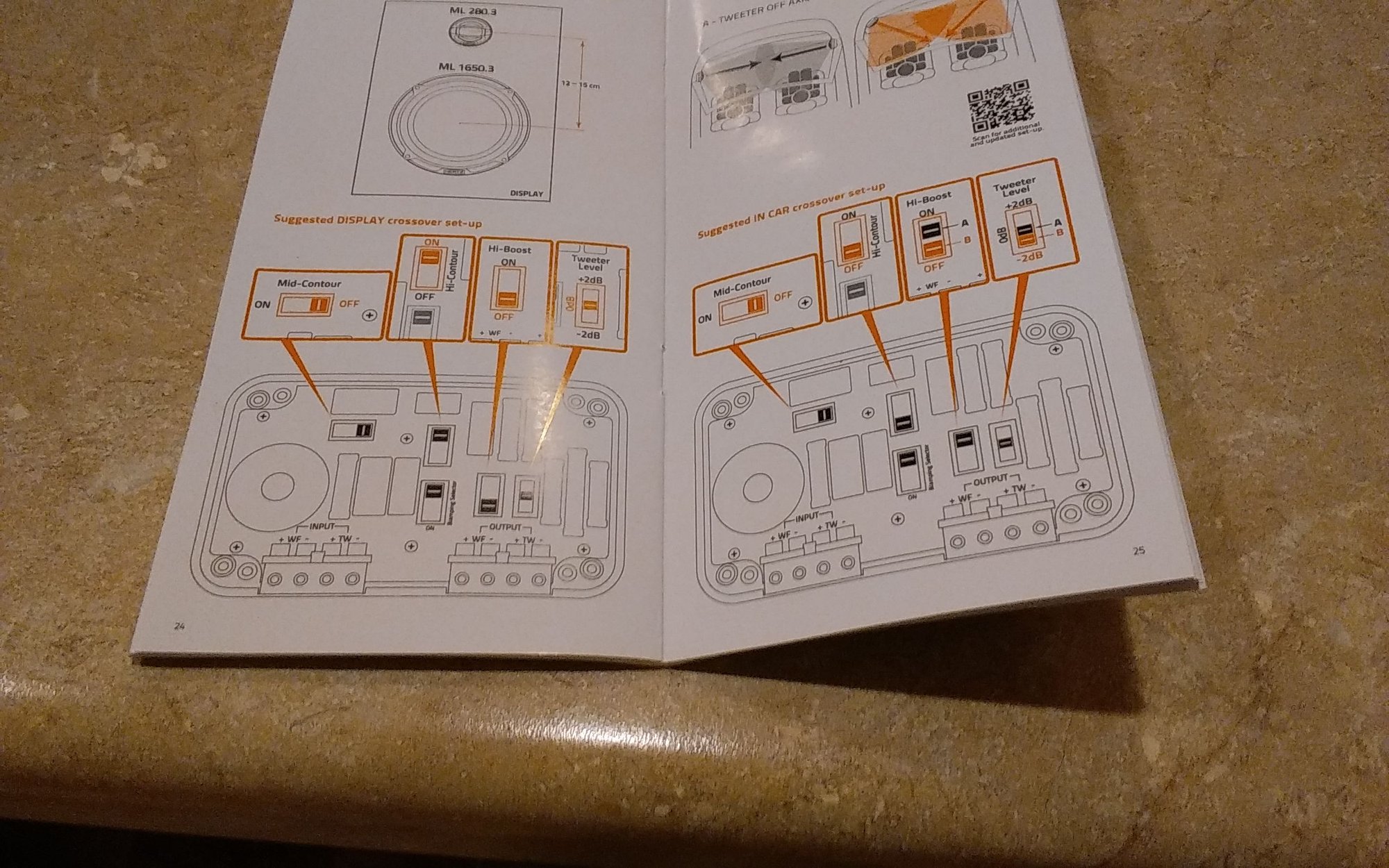

What should these switch settings be placed at?
I have the hertz mlk1650.3 setup, including the mlcx 2 tw.3 passive crossovers. The manual shows suggested settings for display and a couple depending on tweeter location in car.
So what about on bike, with tweeters located directly in front of woofers?

unfortunately you are going to need to try the positions and see what you like best for the sound, everyones ears are different. if it was me i'd try them in whatever middle positions there are first and see if i wanted more or less from the setup.
