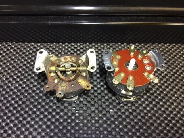

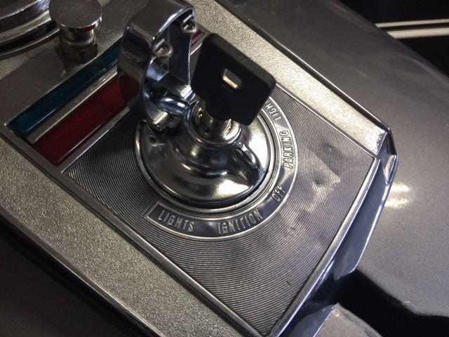

If you want a direct aftermarket replacement, check your service manual or pull your dash to determine how many terminals you have on your switch. I initially bought a standard 6 terminal switch for my year and model bike but found out my switch had 5 terminals...so bought a Fatbob 5 terminal Ignition Switch #495611 so I did not need to rewire the switch.
Stock switch with no keys
5 terminal switch with key
6 terminal switch
According to the parts guy that knows older bikes at the dealership, get the switch with the brass bar across the underside of the switch. The 6 terminal heavy duty switch from J&P Cycles shown above did not have that brass bar

I agree with the others. When I bought my bike, the previous owner gave me a new switch. After removing the old one, I realized the new switch was not like the old. The old one had the brass bar underneath and the new one just felt cheap compared to the old. I found an exact one on ebay for like $25. Works great and now have 2 keys.

Here is a pic of the stock ignition switch with the bar and an aftermarket switch without the bar

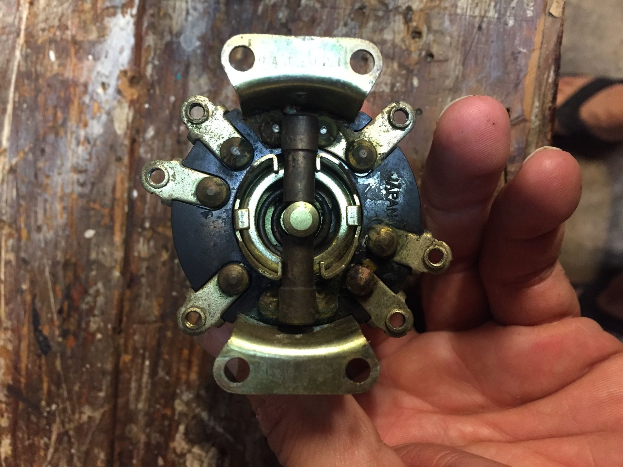

Here is the switch. It has 2 markings on it. "Japan" and "9aj 021"
