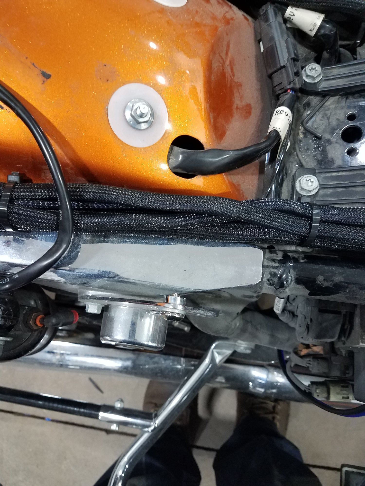

MORE PICS!!!
Hope this helps get you guys motivated. I am happy with the way things are going so far, other than the way you can see the wire across the engine guard.
-1st Hole is Stock. -2nd Hole has 2 sets of RCA's, Remote wire and 1 set of 12 Gauge speaker wire. -3rd Hole 2 sets of 12 gauge speaker wire
-4th Hole has 4 Gauge power and Ground
CX6200nd Fit with the BT brackets and the horns will be wired in parallel with the horns that are going in the lowers.
wired the 1200.4, still gotta run speaker wire from bags to the 1200.1
The seems are good fit and finish are nice on the Dirty Bird Lowers. The wires are a bit more of a choir to hide.
Thick bundle running down brake side.
wire ran and I do have to drill the face for the 8CX300's
Juice
