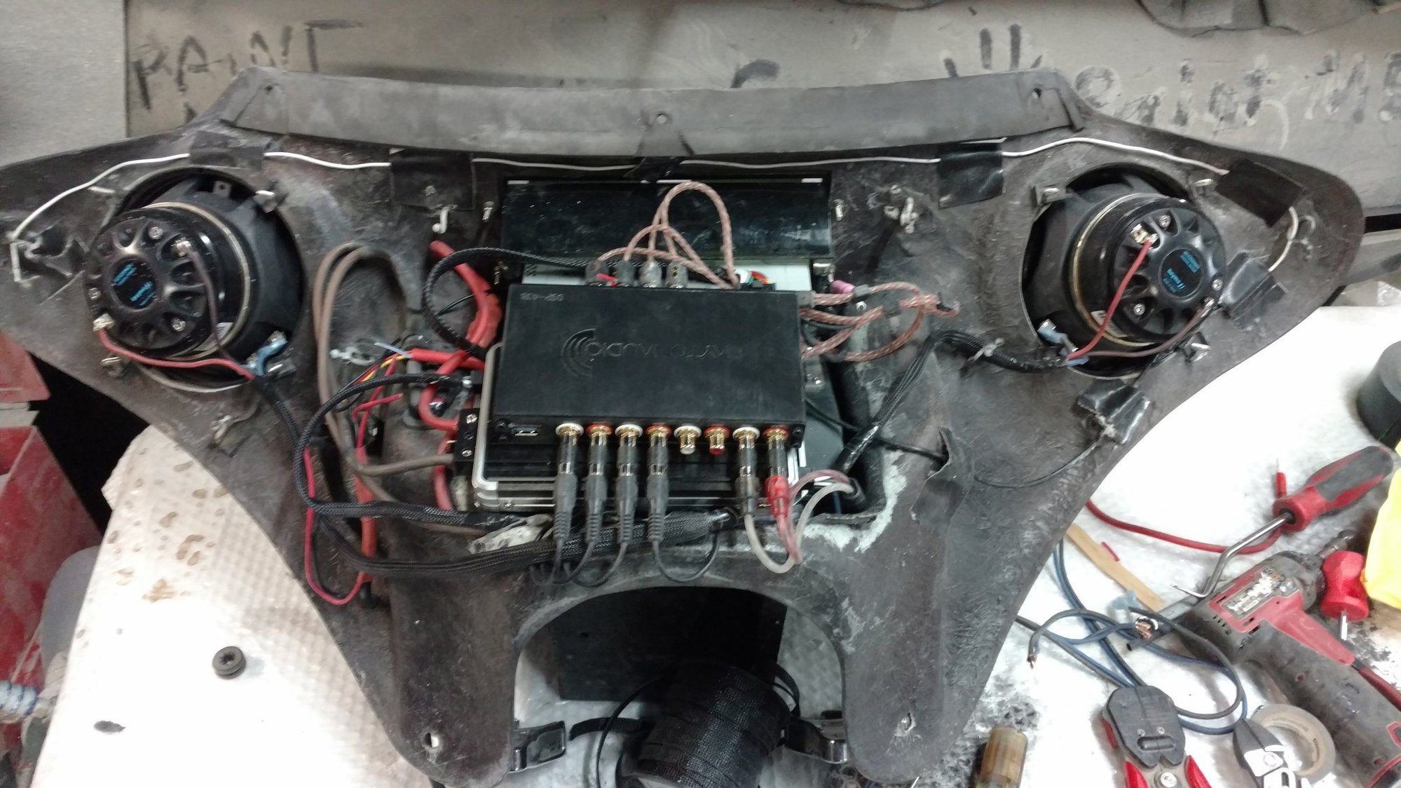

Working on a second project, since my RG won't be ready for Daytona. I am changing the front speaks on my Dyna from Tempesta's (with DB euphoria tweets and crossover) to Beyma coax, and adding PRV 8's to the bags with PRV horns. I had to mold in a 7x9x2 box to the bottom of the small, aftermarket fairing to have room for a Arc Moto 6.4, a CV B52, and a Dayton Audio DSP to fit in the tight *** fairing. It's ugly in there but I'm still wiring it up. The bags and fairing will still be quick release if I wanna strip it down.

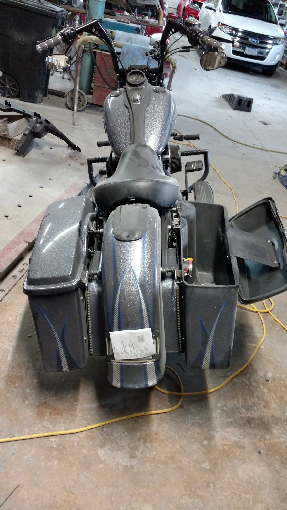

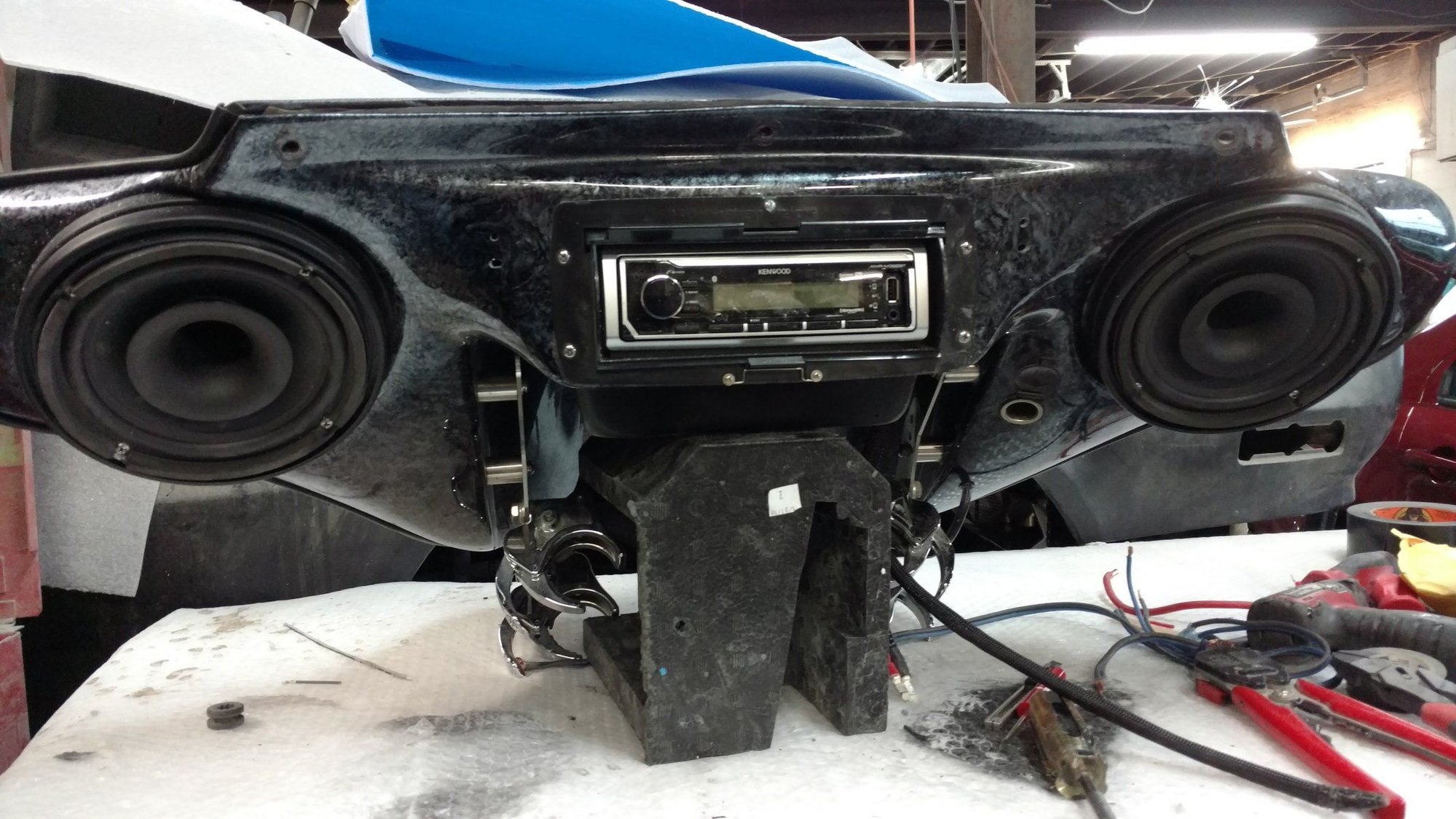

No major winter builds going on here just doing some exploration/fabrication on some 8 inch wethead lowers. It is still a work in progress. I will know more once the bi-polar mother nature finally decides to let the weather change for the better in the Chicago area.

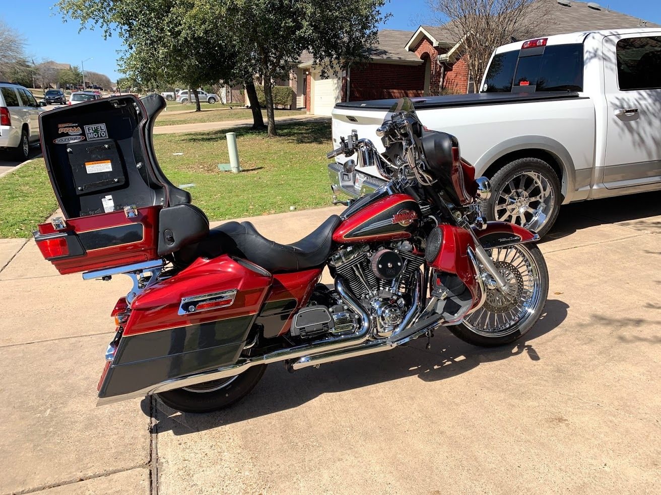

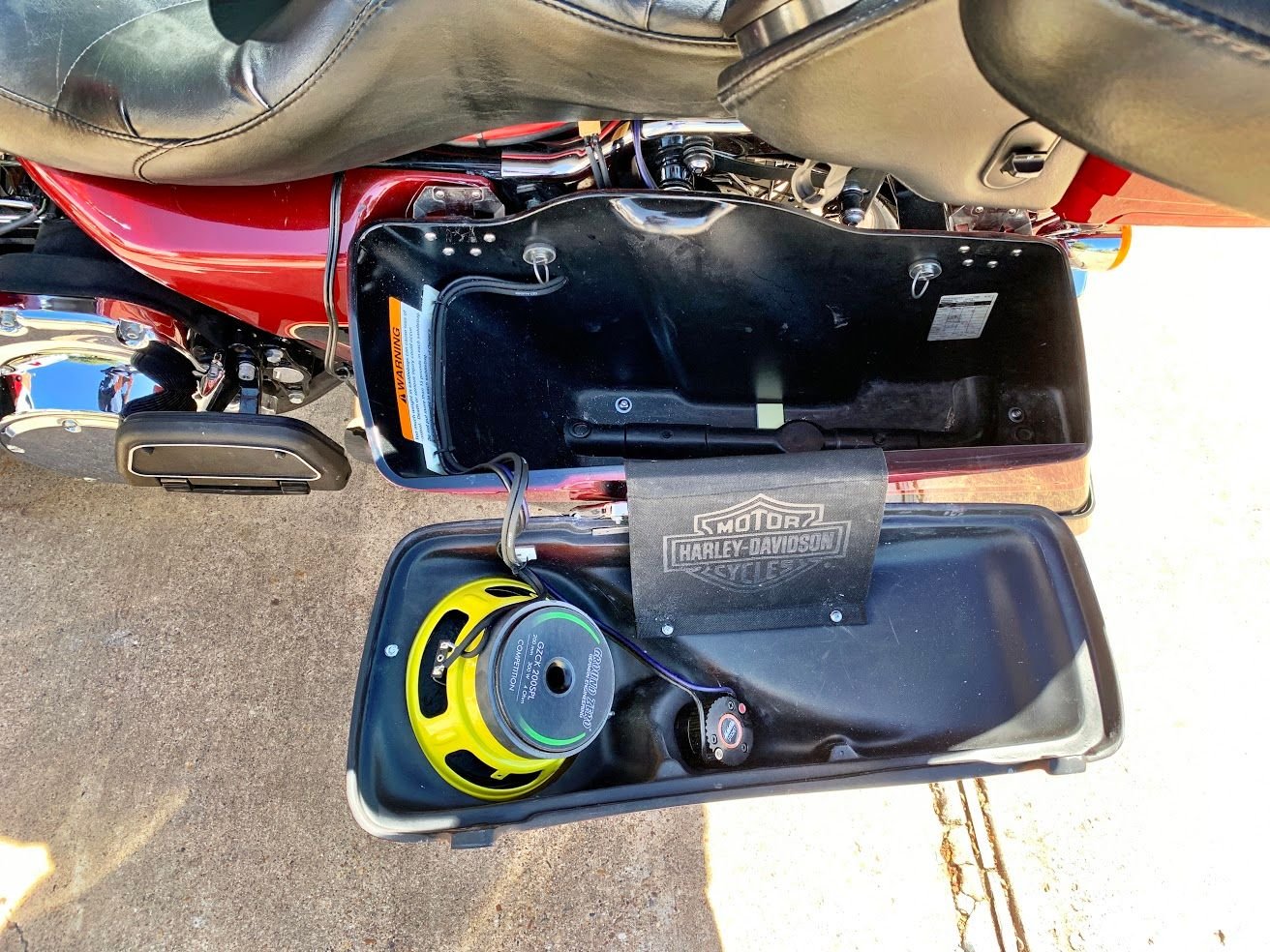

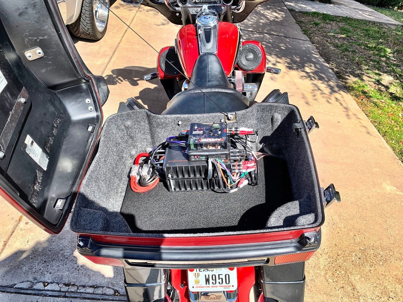

And I'm "done". Sort of. Put power to everything this morning after chasing the gremlin in my fairing. Can't find it and it disappeared. I pulled off every single piece of heat shrink, checked every solder joint, etc etc and found nothing wrong but the problem is gone. Those are the worst kind because since it went away on it's own, it may come back on it's own too.
Small issues, I'm hearing a little noise in my tweeters in the bags, still trying to track it down.
Have a turn on pop, no freakin clue where from. Remote out from head unit to remote in on DSP, using DSP to turn on all amps. everything shares a common ground/power so no ground loops, I'm lost. I'll find it somewhere.
Gotta get some new grills, my previous plan for grills failed miserably so I'll order some and some lid condoms this week.
Couple more hours of break in and I'll start trying to tune it. Very happy so far though, the 8's added a level of depth for rock that has been missing badly. Also, I did weather strip the lids, just got excited to have it off the jack and back together and took pics before I put it on lol. Now I gotta hold out a little longer, save up some more cash I don't mind blowing and have Lucky 7 paint it for me. The fender ext, lowers, and lids I painted myself using Harley paint codes. It's not "terrible" but I'm not a painter. I can airbrush lexan like a champ hahaha, I painted have the RC race car bodies in DFW but painting lexan with acrylic and painting 2 stage Harley paint are a weeee bit different. Looks good enough for a rider for now. Gotta decide if I'm leaving it like this or doing a tail and then I'll have all the red repainted so it all matches perfectly. When I bought this one, I didn't think I'd every really like the colors that much but my wife loved it so I relented (I was going to do blue this time around). I've somehow fallen in love with the colors though because I never see one like it so I'm sticking with it.
