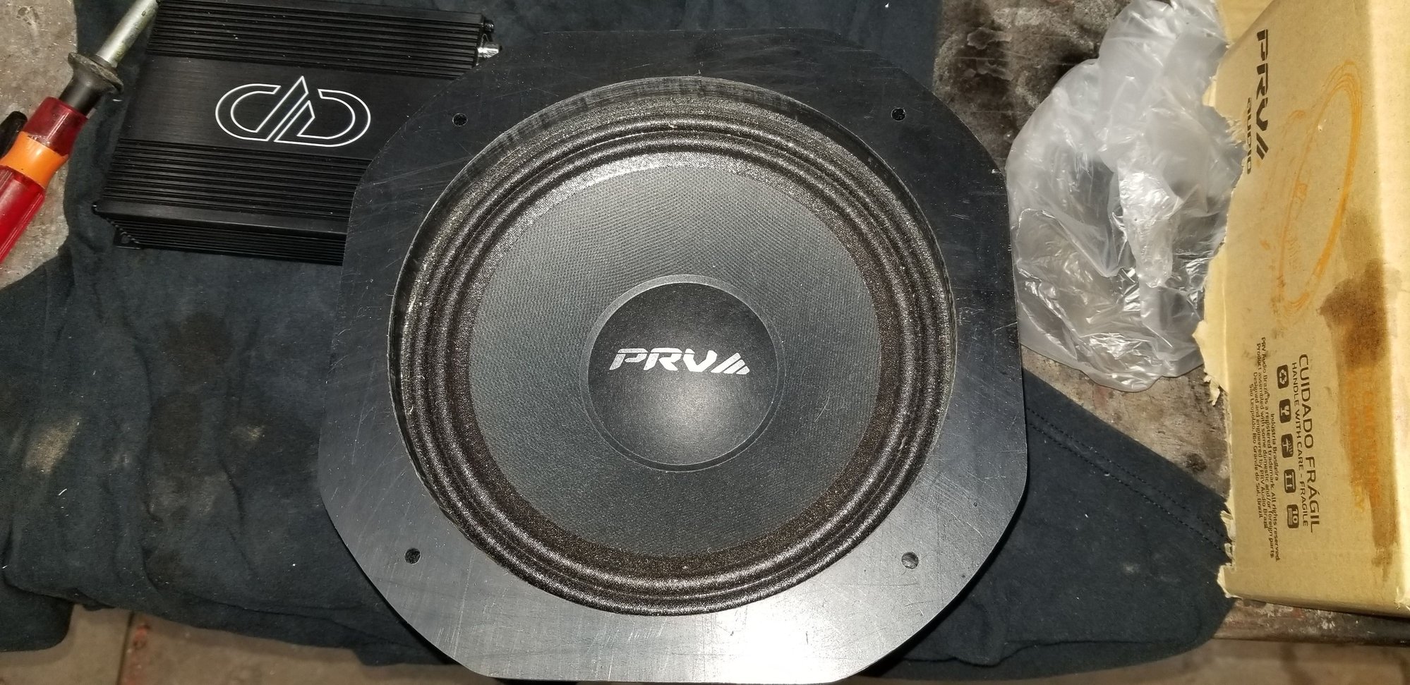

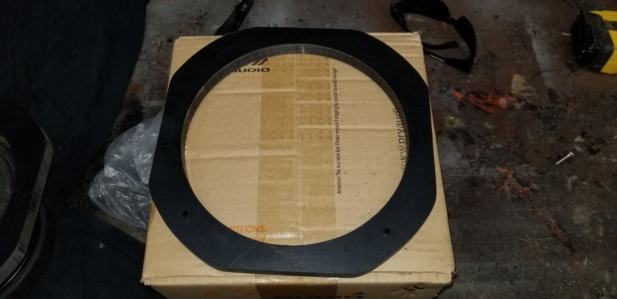

Old Mar 11, 2019 | 07:30 PM
soonerglide's Avatar
soonerglide
Joined: Aug 2013
Posts: 106
Likes: 69
From: oklahoma
Had a friend make these on his cnc router. Not perfect but close enough for me. Just had to do some grinding to fit the bag.
