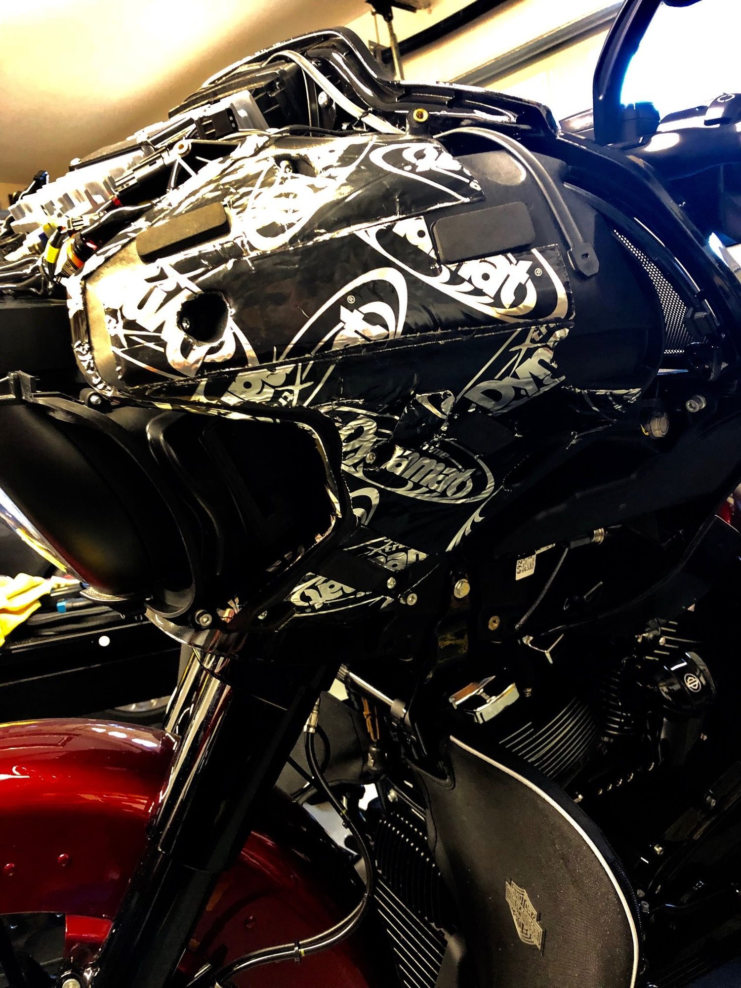

I tried ported, no polyfill, some poly fill, etc. I felt the porting did not work at all, I ended up using dynamat and sealed all the joints, and especially that drain hole on the bottom, sounded like a fart coming
out of that thing. with my setup

Mikes300, Thank you for the feedback AND including the pic! By chance, were you running Boom stage 2, when you ran through these mods?
