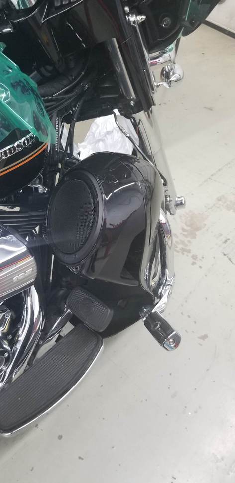

I am planning on adding the hogtunes lower fairing adapters for liquid cooled. I just installed a BT4250, BT7P1 Pro in the fairing and Hertz Mille legend woofers in the pods. Along with the biketronics line levellers.
I am planning to do lids in the future as well. My plan will be to parallel the fairing and lowers then later parallel the pods and lids.
I would like to see what the gurus have for top picks using that combination. As well as what actually fits? I see the hertz SV 165 is mentioned quite often but the fitment seems off. Hogtunes lists a max depth 2.25” and the hertz are 2.6”.
Thoughts? Suggestions?
I don’t really want to add another amp but if needed it could happen.
Thanks!

I did a set of 8" GZ red baskets in my buddies lowers and they sound amazing and I know a guy whose got 6 or 8 of the 6.5 red baskets on his competition bike. They are great speakers. The mmats are solid performers as well.
