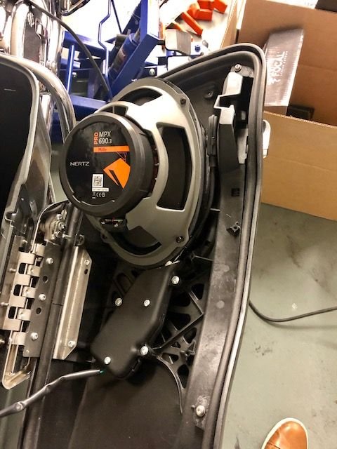

not that I could find, I did however make them work on some Baddad lids, tooks some work though, I had to add a 1/2" spacer under their cones and do some strategic grinding on them as well as the bags, but they work.

That looks like a lot of weight for a bottom mount. Now, I have very little experience with audio, but can barely keep my amps stuck to the back wall of my bags.

I have the same speakers in my bags, pretty typical mount from what I've seen. no problems so far. been about a year on mine.
