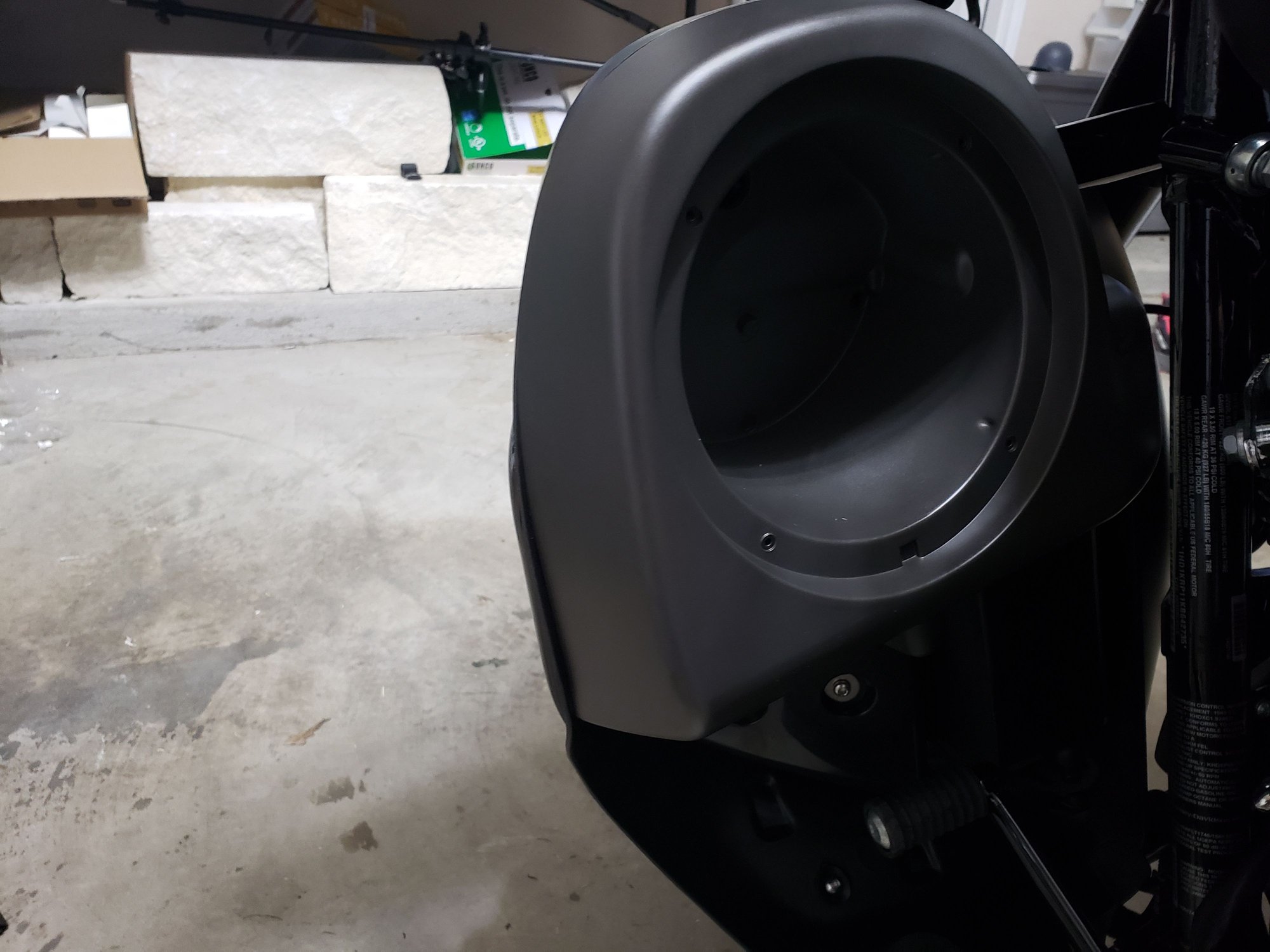

I haven't even unpacked them yet. Hopefully today I will make some room in the garage and get them on. My lids shipped too, so I am hesitant to do all the audio work until Sonic finally sends me my DSR1.
Old Jun 23, 2019 | 04:41 PM
gunslingersnation's Avatar
gunslingersnation
Joined: Mar 2019
Posts: 389
Likes: 16
From: Fort Worth, TX
So, I think the color match was pretty good, and the paint looks smooth. I'm not 100% thrilled with the fitment of the pod on the lower, but maybe they are all that way. I still can't get the damn back piece on. After 5 or 6 failed try, I just ordered a magnetic 10mm socket.aybe that will help.
Old Jun 23, 2019 | 04:49 PM
Ndfastln's Avatar
Ndfastln
Joined: Aug 2013
Posts: 1,083
Likes: 157
From: South Central Va
The ones I've seen/installed were that way. They can be made to fit better, but requires a gluing a guide on the wer to help hold it in place. As far as the bolts go try a little piece of tape over the head of the bolt then put the socket on it, it'll stay.

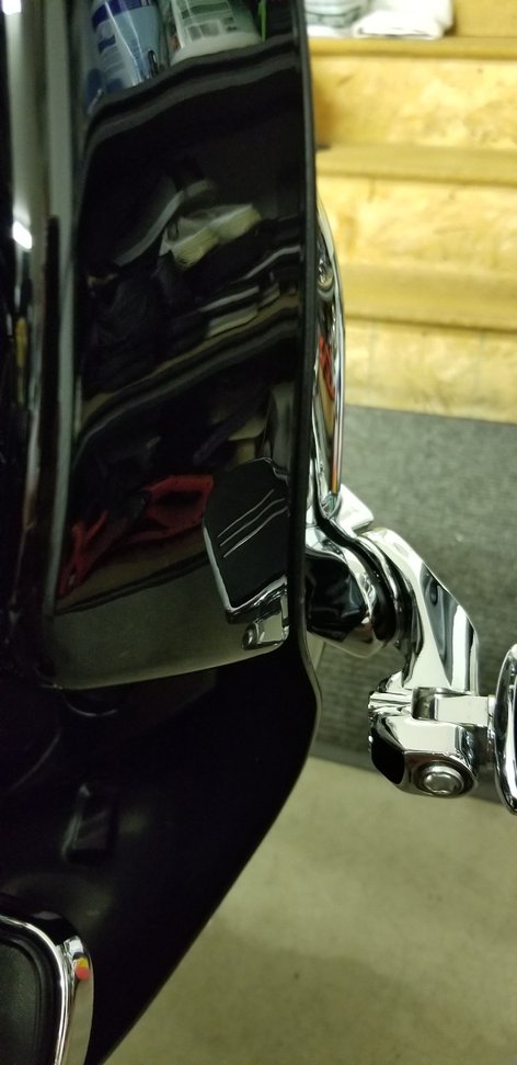

I stuck a very strong magnet onto the 1/4" drive extension when installing that fastener. It can be a pita.
Old Jun 23, 2019 | 05:37 PM
Covert Olds's Avatar
Covert Olds
Joined: Feb 2016
Posts: 679
Likes: 109
From: Minnesota
My pods fit the same way. It's hard to notice in the photo but l tried capturing it.
