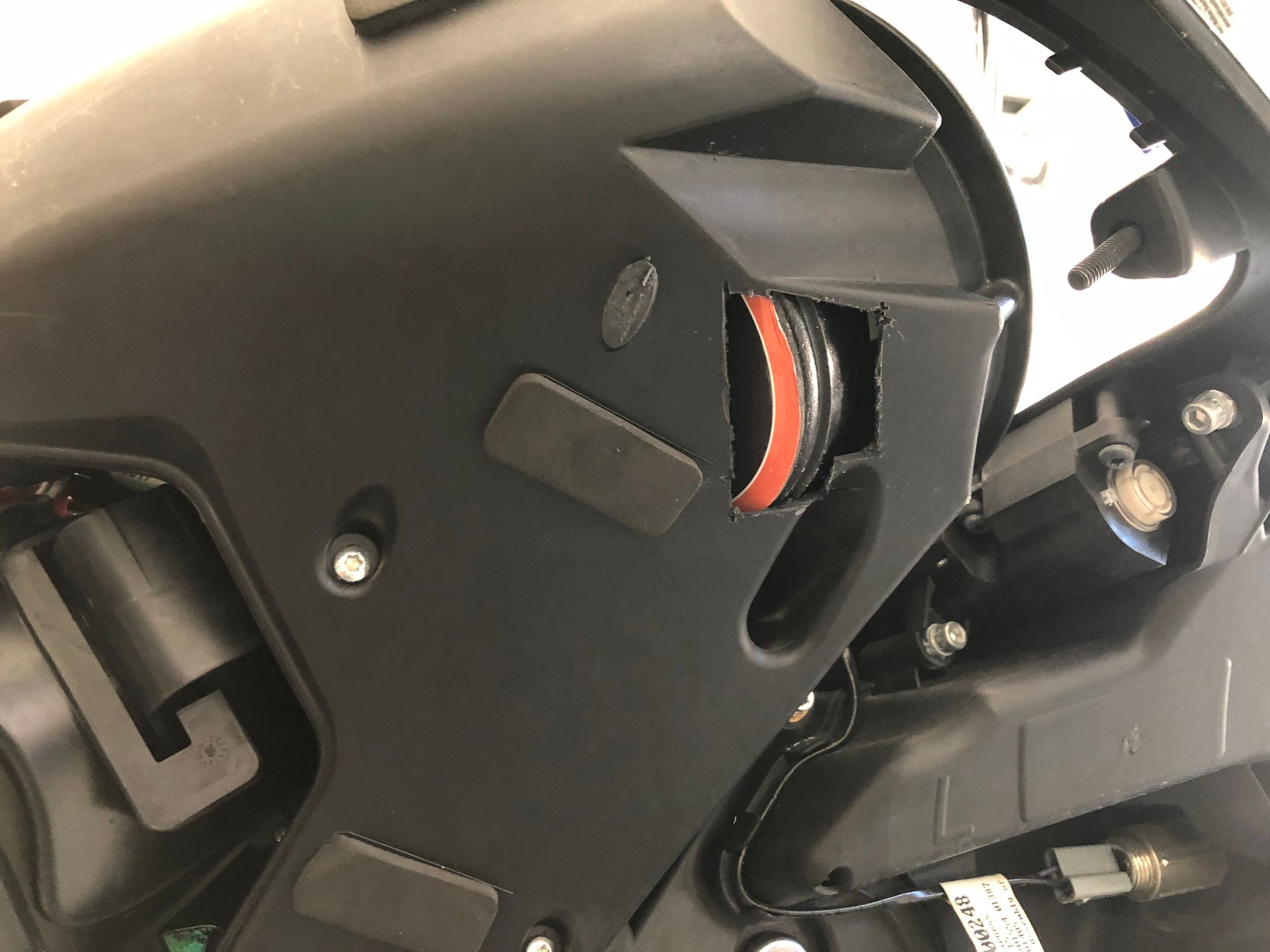

The Mmats 601.cx and the Stinger 700 are a great combo. Putting mine in this weekend. Not sure about your tour pack pods, but I have an 05 Ultra and had to add an adapter plate to the rear pods in order to get the depth needed to fit the Mmats. I used the VTwin speaker adapters. A little pricey, but look good once installed. I also had to make a slight notch in the inner ring inside the pod for the capacitor on the Mmats speaker to fit it into the pod. Easy enough, but wanted to let you know they don't just drop in.

I also used the Vtwin adaptors for my 16 RGU tour pack. The price is going to scare you ($100) but they work and look good too. I also had to cut a relief into the pods in the fairing to get the MMats to fit. I am running the MMats MD4110 amp and 4 MMats PA601.4CX speakers. I am also running the Sony 5000 radio. I am very satisfied with this set up. I will post a picture of what I had to do to the fairing pods.

Here is the picture of the relief cut I had to make to get these speakers in the fairing.
