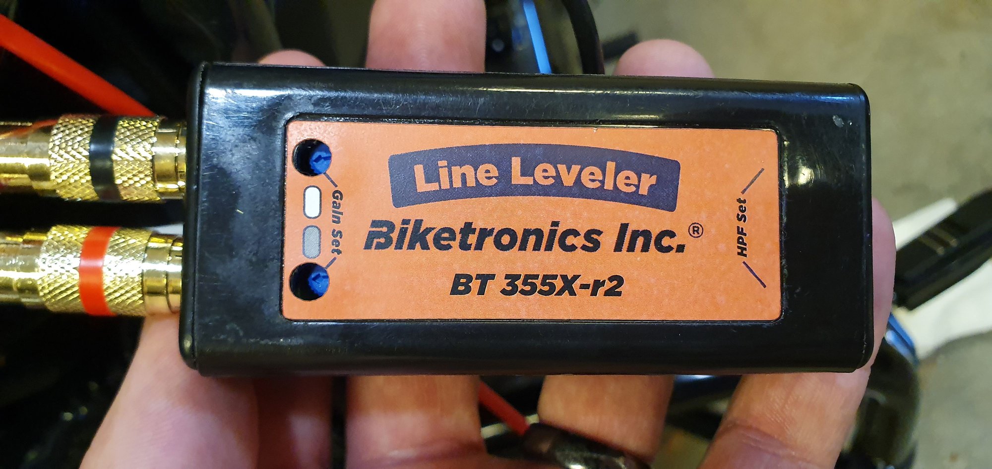

Upon closer inspection, I don't have a BT 355, I have a BT 355X-r2. I'm going to call Biketronics and try to get a manual on that.
Post a picture of what you got including the *****.

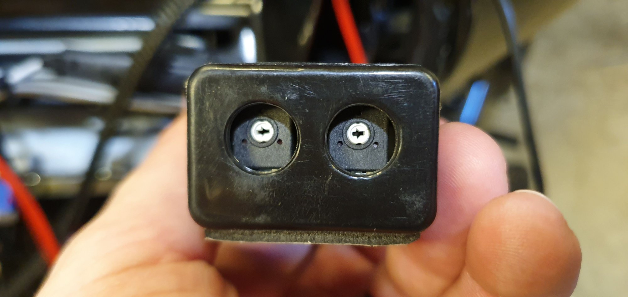

Apparently it's their new "in-house manufactured" design. Functionally no different than the original BT 355, but the layout is different.
The HPF's are on the end now. Both of them are set to approximately 3 o'clock.

My gut feel is that the HPF's are set way too high.
Can someone walk me through how I validate / fix this?
