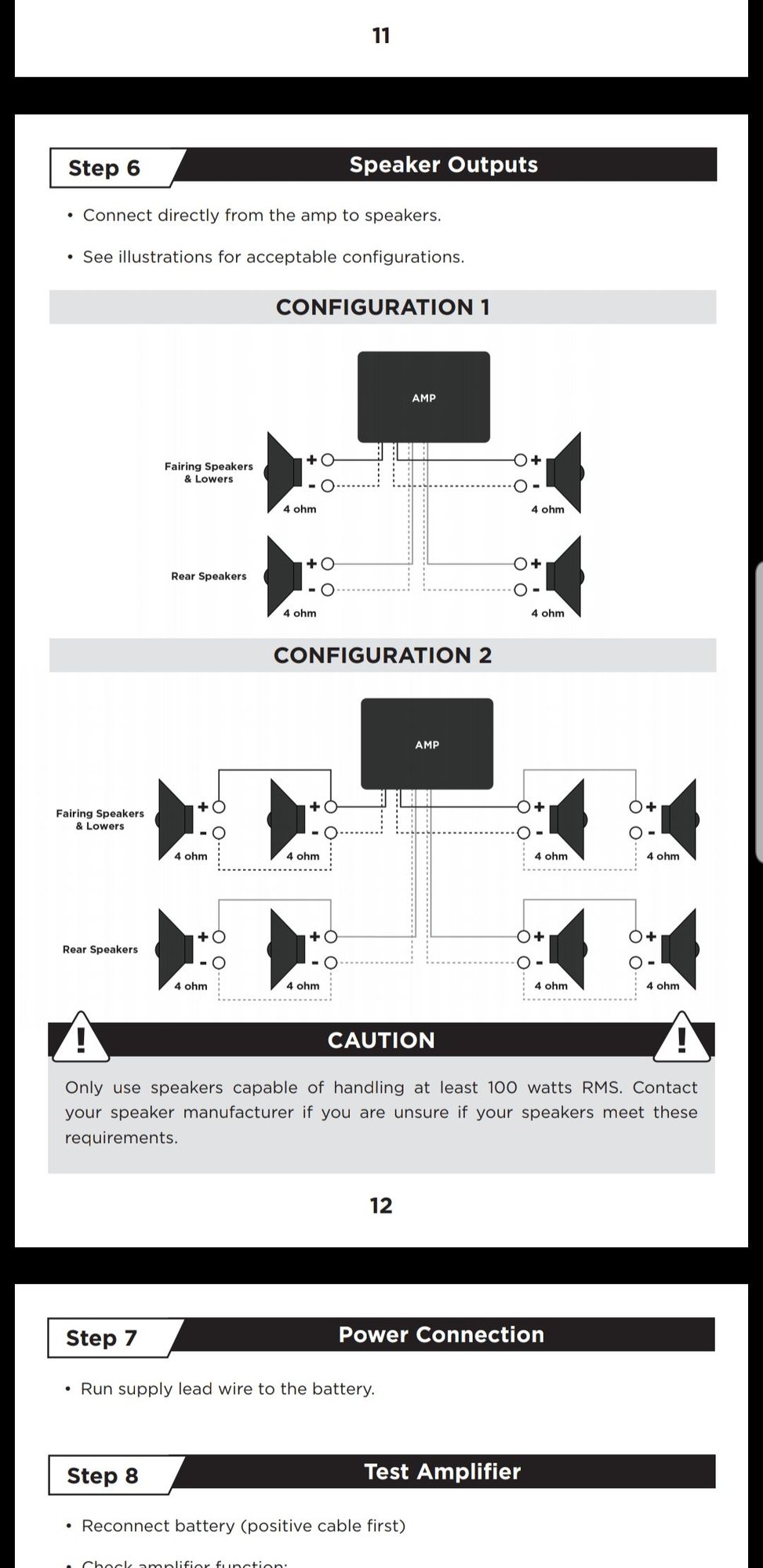

Seems like this is the way I'm headed then. I have to figure out my wiring situation with the Bt4180. I've got 6.5s in the fairing off the front channels and 2 tweeters are spliced into those. The rear is just for the tourpak for now. Should be able to run a line off the same rear channels back to the saddlebags. Or just splice into the line under the seat that runs to the detachable tourpak.
So if I'm reading this correctly, you're running a BT4180, 6.5' and tweeters in parallel off the front channels, and tourpack speakers off the rear channels of the amp correct?
Old Sep 11, 2019 | 12:33 PM
Timberjkd's Avatar
Timberjkd
Joined: Sep 2017
Posts: 534
Likes: 85
From: NC
Yep. Would this be bad to add the RF 6X9S in the lids with just that 4 channel? The manual says up to eight off the amp is good to go and I am definitely not an expert. The system as is sounds great. Just looking for a little thump.
Yessir I'm well aware of the capabilities as well as the shortcomings of the BT4180. Yes it's capable of running 8 Biketronics speakers or 4 of the exact same speakers of another brand on the front or rear channels, but I wouldn't attempt to run a 6.5 and a 6x9 in parallel on this amp or any other one for that matter. The characteristics between the two speakers is huge and you'd basically end up with a 6x9 that you can't play at it's full potential because it's having to play in a range that the 6.5 it's paralleled to can play in. In your situation I'd run the front and rear 6.5's in parallel on the front channels and run the 6x9's off the rear channels.
Ooooh I hadn't thought of that. Well you make a valid point. I have a choice of adding a soundigital 250 2 channel amp to the fairing for the 6x9s or do exactly like you suggested. Thanks. That is definitely something that I had over looked.
