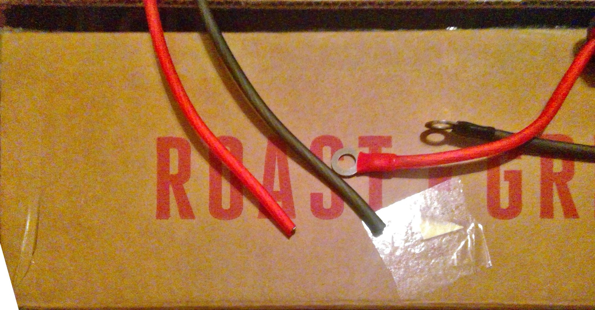

the RCA's to the AMP supply everything sound wise, then you hook up the speakers directly from the AMP to the speakers, nothing to do with the harness, the amp will also need power and ground, usually get these directly from the battery, and a remote turn on wire, some get this from the cig lighter as it will become powered up when you turn the key on.
I have the stinger amp kit with the inline fuse, red to the positive on battery, is the black ground or goes to negative? on the other end of this I have to wires with nothing on them im guessing the go to the amp but not sure how? will I need to put connections on there or cut the plug off on the amp that says power out and splice the black and red wire into this? thanks all

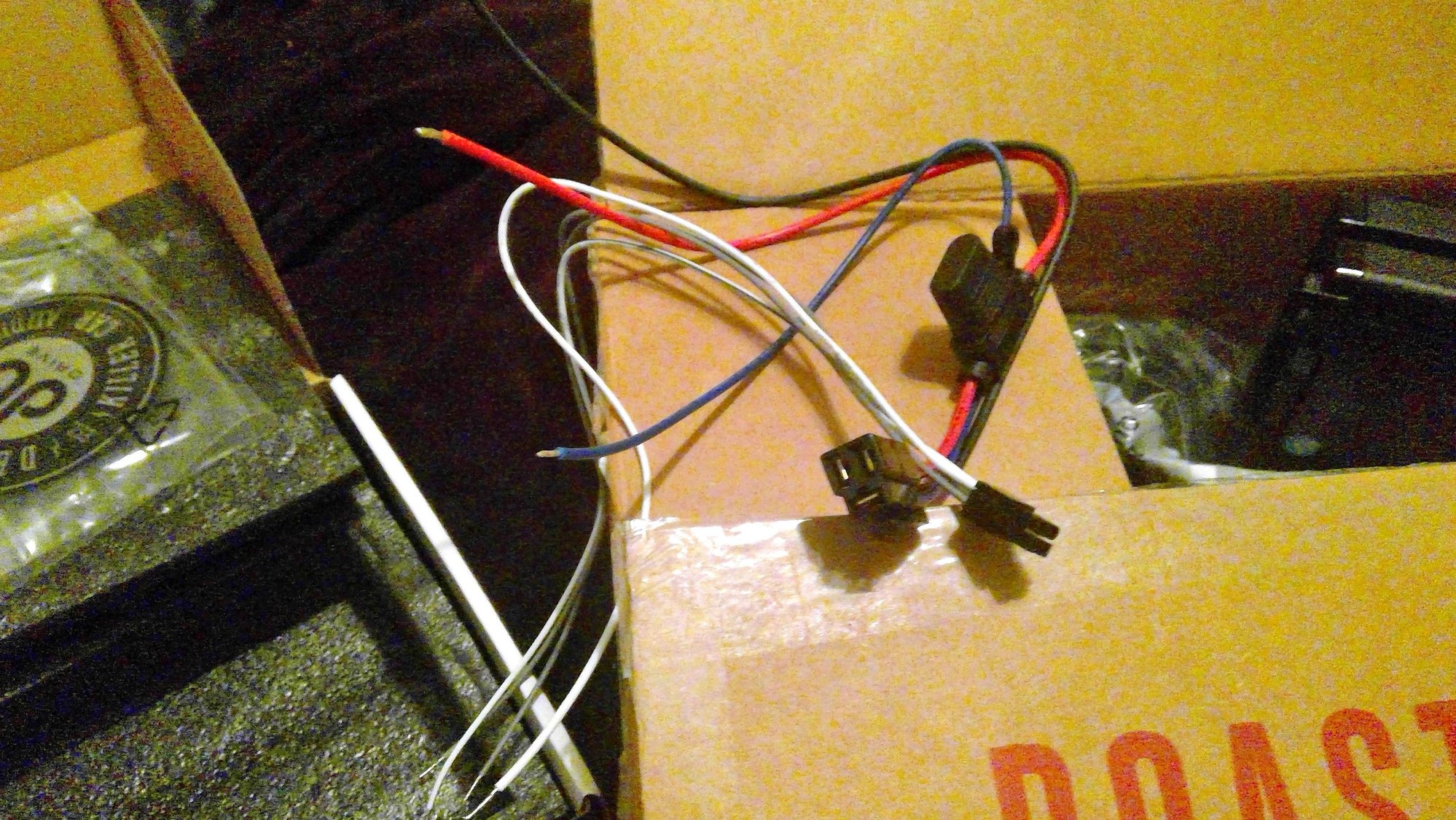

Ok heres exactly what im looking at, so it looks like the 2 harnesses one is for the speakers and the other has the black, red and blue cable both plug into the plugs on the amp power supply and speakers out. I will need to splice the stinger kit with the red and black cable with the power out harness that plug into the amp and the other speaker out with white n grey wire directly to the speakers
yes, red to positive and black to the negative terminal, then yes splice right into the amp pigtail,and blue from your HU to the blue out of the amp, it won’t turn on without the blue connected,

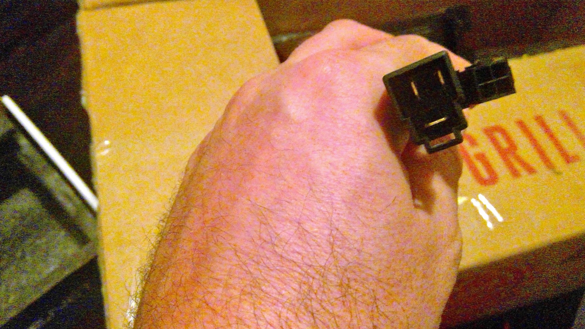

[QUOTE=mikes300;18754965]yes, red to positive and black to the negative terminal, then yes splice right into the amp pigtail,and blue from your HU to the blue out of the amp, it won’t turn on without the blue connected,[/QUOTE
Awesome, I'm getting there slowly. Asking alot of newbie questions and appreciating all the answers and help. The pig tail with the 2 white wires one white n grey and the other 2 grey are for left and right speakers positive and negative, do I splice into the existing speaker wires or take the old ones out completely and put clips on these and attach to new speakers
