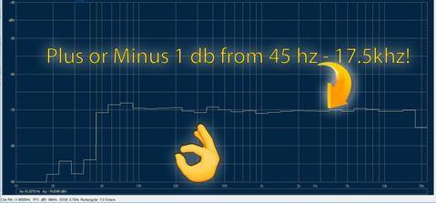

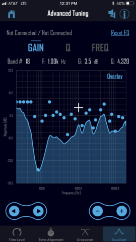

To elaborate on what Haze is saying, 4/0 isnt great for a build. 8/2 is the way to go for the flattest signal that can be achieved out of a stock boom HU. American Hard Bag has some good articles on what they did to the DSR-1 to achieve a "Flat" signal. The EQ looks amazingly horrible. The signal correction to get flat is ridiculous. So why not skip the fade which isn't a deal breaker for 99% of us and try to start flat. Understanding it's not as easy as going to your local HD dealer and getting the 8/2 flash, but you can go to any independent shop with the Techno Research tool and get it done. Most I've seen charge $40-$60 and honestly it takes about 10 minutes total.
This is what AHB did to the DSR to correct the signal
This is what the end result looked like on an RTA
So needless to say, a lot of EQ'ing just to start flat. ARC did the same thing with their PSM to correct the HD EQ and match up to their original Moto 602 speakers.
The purpose of this post isn't to say there's a right way or a wrong way, but to prove the fact that if you want the best sounding system that will allow you to EQ properly, starting flat is your best option, hence the reason so many folks are going the aftermarket HU route.
