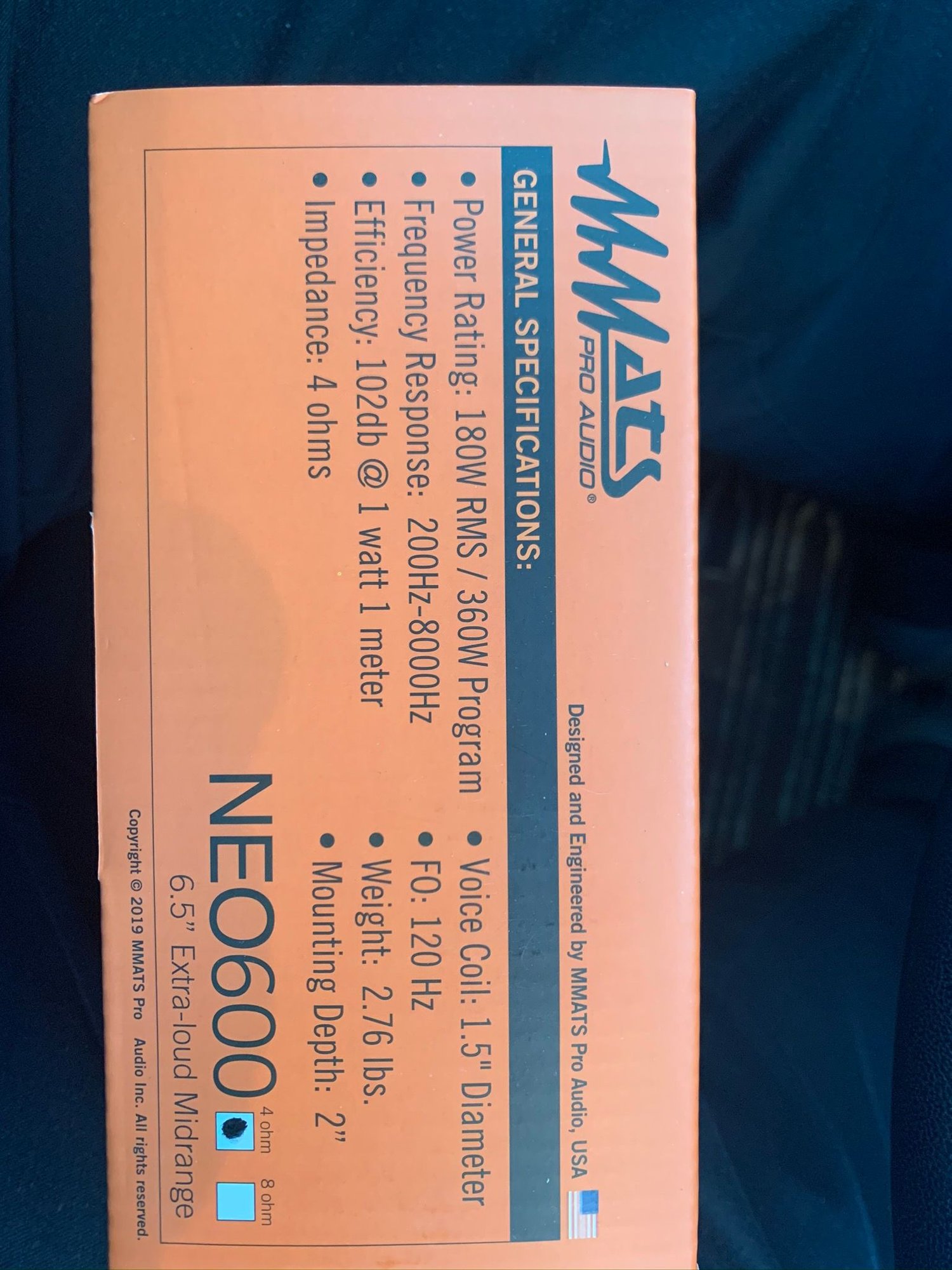

These are Mmats new midrange Neo600. I just replaced six of these on my Road Glide and more than impressed with the results. The are not ideal for a midbass application these really shine above the 200hz high pass crossover pointi used. If you have subs and or capable midbass these are hard to beat. They get really loud and really clean. 102db efficiency! You will need a dsp to get the most out of these I found I need to tame a little in the 800-1200hz range.Just a heads up these should be available now Although not on the website yet. I’ve ran all Mmats in my bike for about four years now with good results. I’m running a Alpine ilx207 head unit, Audio Control DM810 dsp, two Mmats HiFi 6150 amps, six Neo600 midrange,two pa801 midrange,four Mmats dtx26 horns,four Mmats sq tweeters.in each bag a 10” Mmats sub as well as one 10” Mmats in tour pack.
