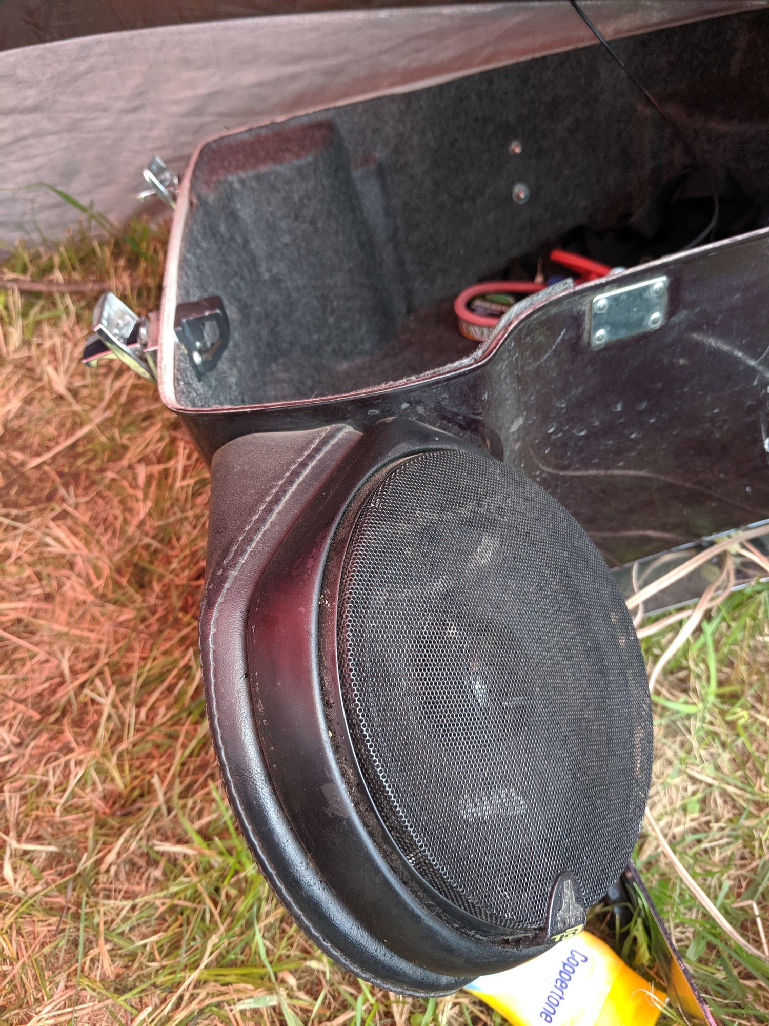

There are plenty that are better. How much are you willing to spend? For the tour pak you will need a spacer. I use the Vtwin adapter it is a good looking piece.

Fireball jack- do you have a picture of the vtwin adapters installed on your tour pak?

Here is a picture of the Vtwin speaker adapter plate. It also comes with it's own grill. I didn't use the grill as I chose to use some JL Audio grills I had to match the ones I used in the lowers.
