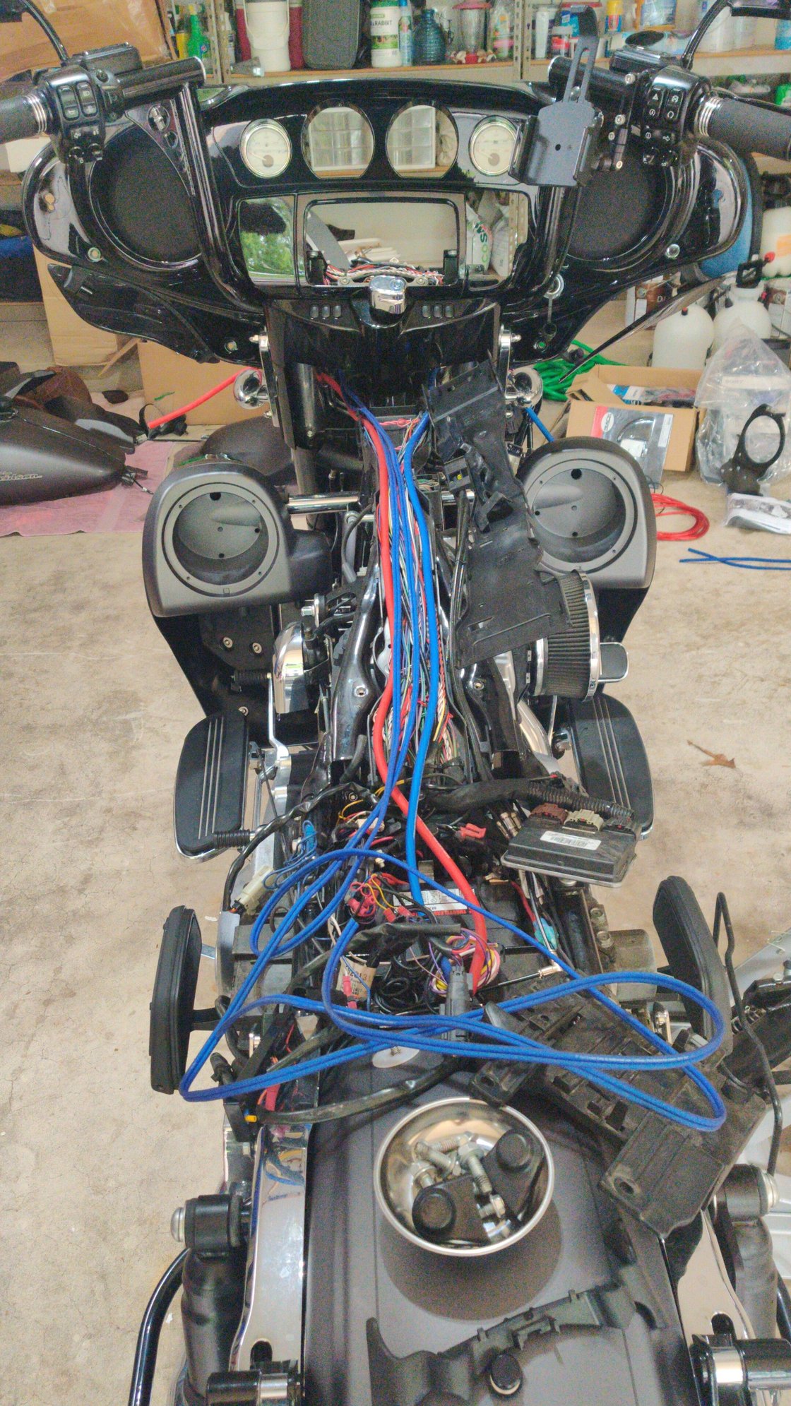

Default Phase 2 - Engaged & Blowing My Mind!
First off, thank you guys for the responses! Huge help, everything I accomplished I learned here reading these forums and doing other research. I cannot thank everyone enough for sharing!
I ran the Mmats 601 CX in lowers and fairing. Not enough low end. Loud, clear, but lacking low end. Nothing against them, my noob mistake.
Just dropped the fairing Mmats out and replaced with GZ yellow baskets with the grill mounted Diamond Audio M075T in front of it.
i have my SounDigital EVOX 800.4 powering the GZ and Mmats now.
I also dropped a SD Nano 250.2 to run the Diamond Audio.
To top it off, installed a Dayton DSP in there. Got the BT module and remote. Tried like hell to replace that monster BT stick with something tiny that was compatible with damn near every OS in the world but no luck the Dayton never fired it up. Ended up making it work with the Dayton BT module. The Dayton remote was garbage and the LEDs were too bright, tossed that to the side.
The only outlier issue I have had is getting short, high quality, flexible RCA cables. It's back together now and sounds AMAZING!!! Have a suddle hiss between tracks and I'm thinking it's the cheapo cables. I went through 2 sets and it was just too bulky and putting too much strain on my equipment for my taste.
Followed the advice for setting Gains and the DSP, more tweaking to do and I might even get into REW with the mic to help with the EQ setup.
Only things left are -
- Install the CVO grills for my lowers when they finally come in to the dealer. Have a spacer and Mmat grills on it now. I paid a ridiculous amount for those damn grills. 😒
- Find and replace the RCA jumpers with something better suited for the task. Any suggestions for something that is not a meter long and flexible welcome?
- When I go in to do the RCA cables, going to install the sound dampening material inside the fairing.
Thanks for sharing the knowledge!
