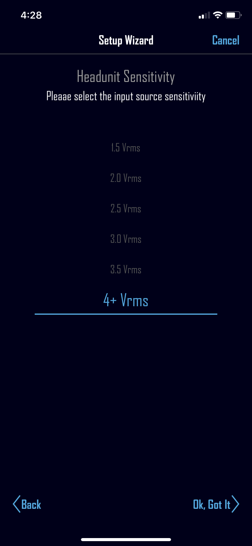

Good you are getting a handle on it. What Outkasts second question was referring to was the Headunit Sensitivity setting in the DSR1 setup wizard.If you're still feeling like you're over driving your horns try dialing back the input sensitivity. You should then be able to get closer to your target voltage on your amp gain adjustment.

Originally Posted by abadv8
That's just a "high level / low level" switch, no?
Edit: I did step through the wizard, and if memory serves me correctly, there was an option to select "high" or "low".
it should ask you like 1 volt, 2 volt, 4 volt, etc.
Old May 22, 2020 | 03:28 PM
abadv8's Avatar
abadv8
Joined: Apr 2011
Posts: 184
Likes: 8
From: Georgia
I did not see that option...
Where would I find it? Clearly not in the setup wizard?
