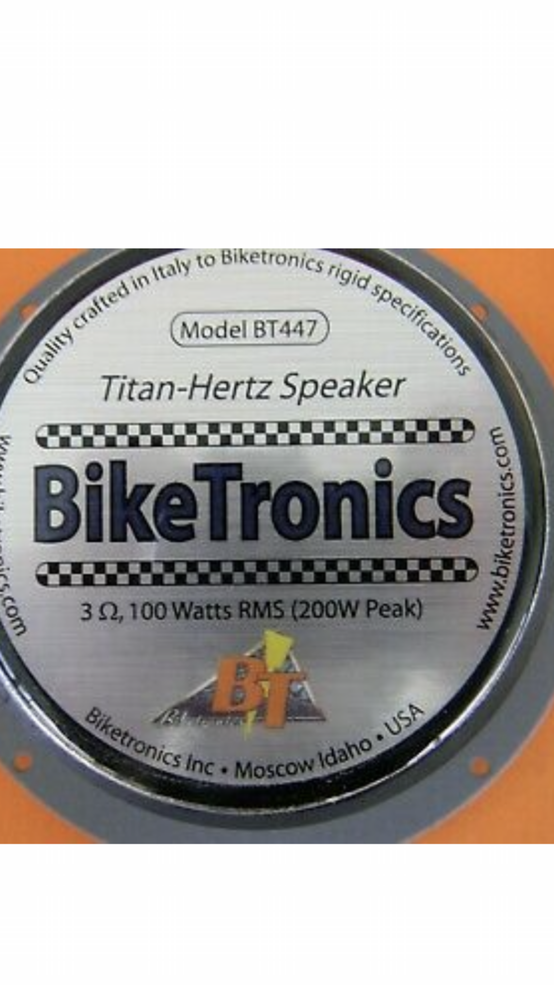

Thank you for the info! I’m pretty sure the ones I’m getting are the rebadged versions. The outer ring around the front of the speaker says Hertz and the sticker on the magnet says Biketronics model BT447. I’m assuming this is an older version of the Titan II since I can’t find much info about it online. I would really appreciate it if you or anyone else can confirm which speaker version I have.
Old Aug 19, 2020 | 01:00 PM
travelingypsye's Avatar
travelingypsye
Joined: Dec 2017
Posts: 3,371
Likes: 689
From: indiana
Look up hertz hcx 165 pics and see if they look like yours with the off set tweeter that can be turned to face you when installed. If that is the case those are damn good speakers with great SQ but need power from an amp to get them to sound good.
Old Aug 19, 2020 | 01:10 PM
Baja4us's Avatar
Baja4us
Joined: Aug 2020
Posts: 89
Likes: 60
From: Fresno/Rosarito Beach
These are the ones

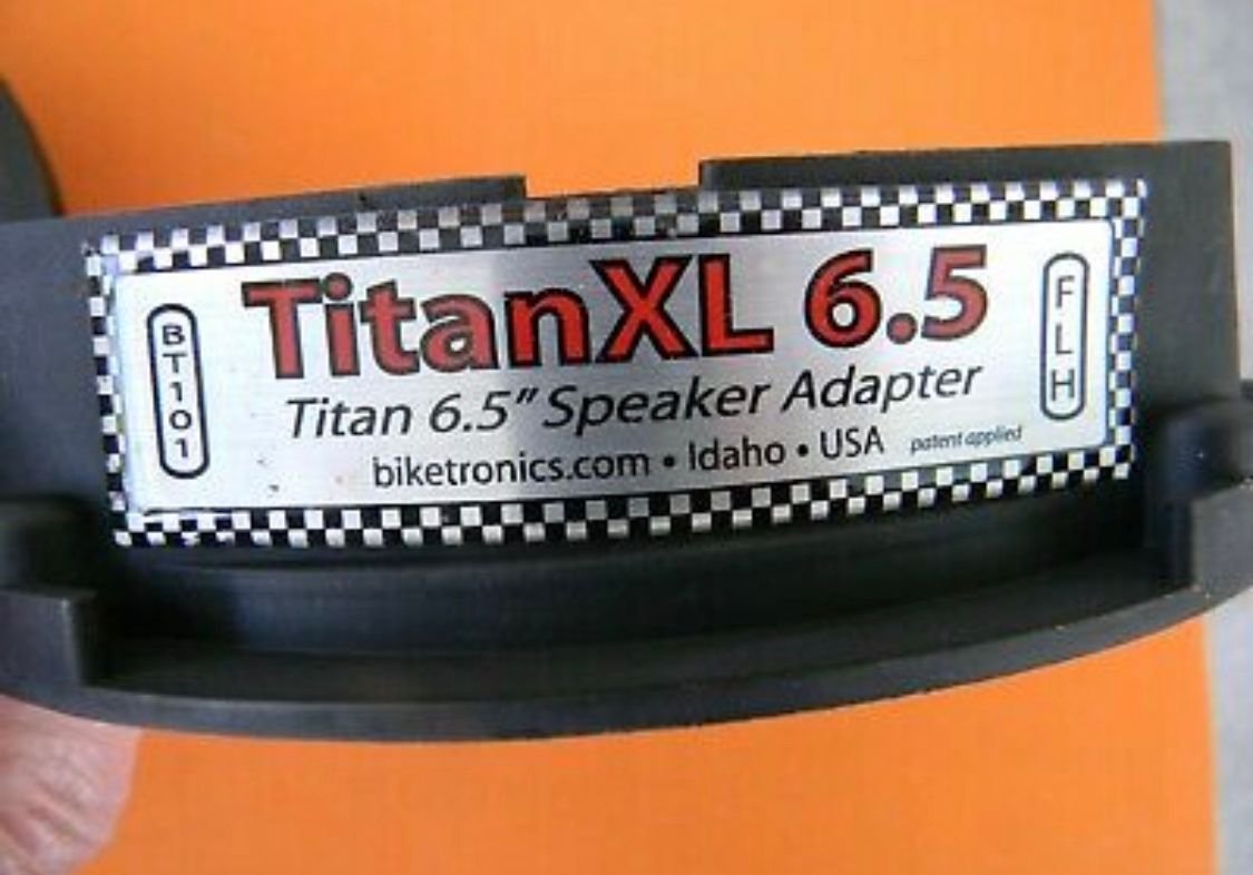

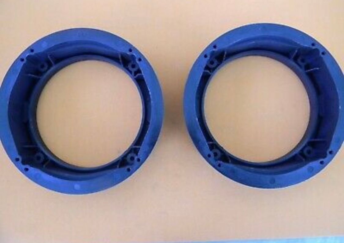

Old Aug 19, 2020 | 01:14 PM
Baja4us's Avatar
Baja4us
Joined: Aug 2020
Posts: 89
Likes: 60
Front view
Old Aug 19, 2020 | 01:21 PM
Baja4us's Avatar
Baja4us
Joined: Aug 2020
Posts: 89
Likes: 60
Adaptor rings
