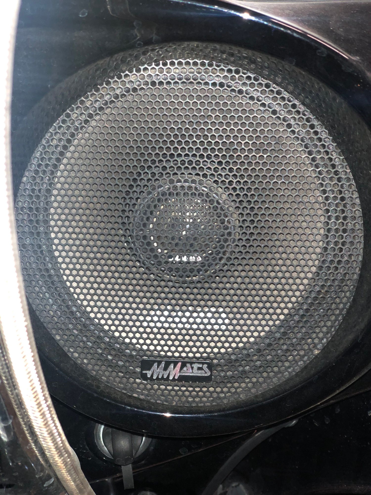

I was able to use the grills that came with the MMats. Not sure what the arrangement is on the '10 Ultra, but after removing the speaker pods on the '15, I separated the grills from the rings and mounted them on the inside of the fairing, then placed the speakers (in the pods) behind them. I also put in some rubber weatherstripping in between the front portion of the speaker and the grills to try to keep things sealed.
